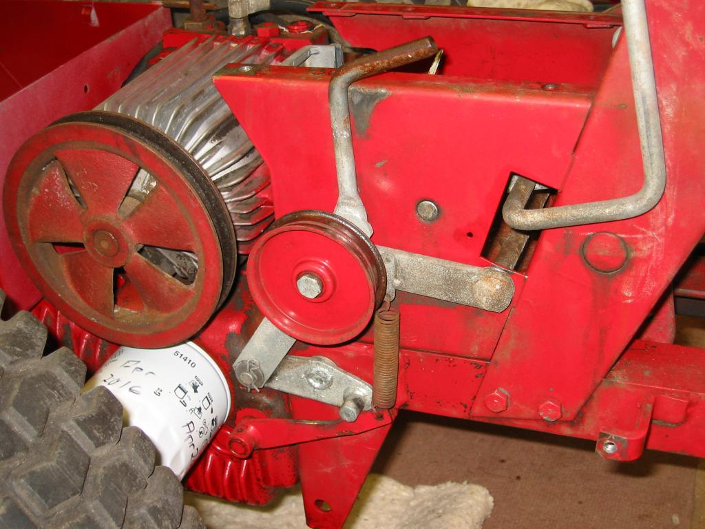

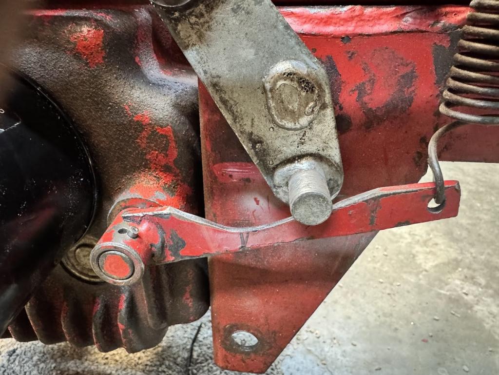

pfrederi 20,181 #25001 Posted November 25, 2025 (edited) 18 hours ago, Bar Nuthin said: Finally got the ass end put back together on old Johnny Cash. Only one tiny drip that I think may be coming from the input shaft. But the transaxle case is looking good. And it moves, so there's still some hope! One thing that has me puzzled is this parking brake lever. I may need to take the belt guard off of my C-120 and have a look at it. It's no wonder the parking pawl on all these early hydros are destroyed. Check the bottom of the pin that rubs on the parking pawl lever. I have had some that had a groove worn in them. Edited November 25, 2025 by pfrederi 4 1 Share this post Link to post Share on other sites

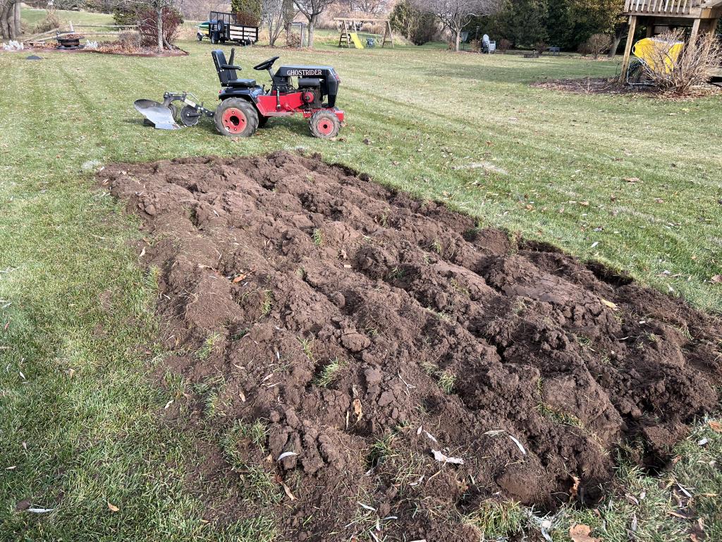

PeacemakerJack 10,917 #25002 Posted November 25, 2025 although it was a small space, I got to plow up a little plot of sod for my cousin to plant a garden next spring. I realized in short order that GhostRider and the Punisher were like bringing a “bazooka to a knife fight”😅. I should’ve dug out Caleb’s Comanche (854) and the 8” sod bottom plow…maybe next time🤔 Still had fun turning earth though… hauled it down in my little enclosed trailer—first time using that, it worked well. 3 8 Share this post Link to post Share on other sites

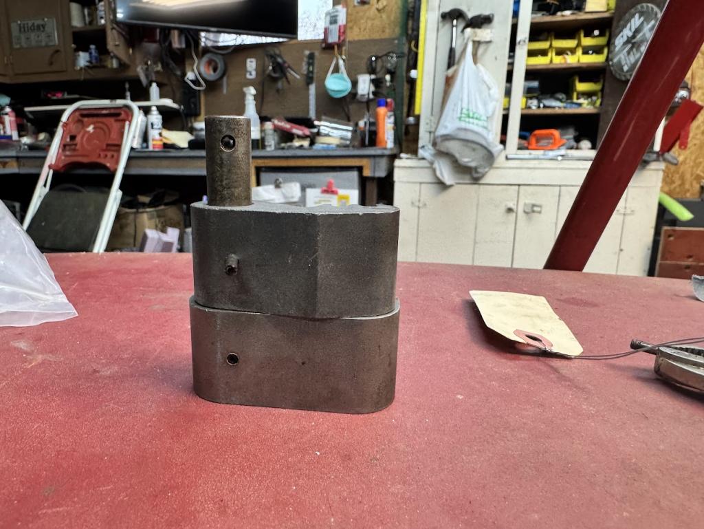

Bar Nuthin 2,275 #25003 Posted November 25, 2025 (edited) 1 hour ago, pfrederi said: Check the bottom of the pin that rubs on the parking pawl lever. I have had some that had a groove worn in them. Thanks for the clear picture for reference! Yes, there is a wear groove that I can address - but I need to lift the tractor and make a closer examination. My brake lever only appears to reach horizontal at its highest point. Perhaps I didn't have the pawl fully engaged with the gear. My other thought is that the replacement pawl came from a D series - but on initial inspection, the geometry looks the same. The D-pawI is fatter, but it looked to all be on the top side not the gear side. I'll compare the two side by side on the same shaft and do a closer inspection. I guess it wouldn't take much to equal a few degrees. Edited November 25, 2025 by Bar Nuthin 2 Share this post Link to post Share on other sites
Bar Nuthin 2,275 #25004 Posted November 25, 2025 (edited) 45 minutes ago, Bar Nuthin said: The D-pawI is fatter, but it looked to all be on the top side not the gear side. I'll compare the two side by side on the same shaft and do a closer inspection. I guess it wouldn't take much to equal a few degrees. @pfrederi - BINGO!!! Turns out, when you align the holes for the roll pin, the D series pawl (bottom) is deeper at the gear side. It ends up being a little over an inch of travel difference at the end of the brake lever. I'm not splitting this case again, so I'll try my hand at modifying an old brake lever to compensate for the difference. Edited November 25, 2025 by Bar Nuthin 4 1 Share this post Link to post Share on other sites
Bar Nuthin 2,275 #25005 Posted November 26, 2025 4 hours ago, Bar Nuthin said: I'm not splitting this case again, so I'll try my hand at modifying an old brake lever to compensate for the difference. I had brake lever that was badly worn, so I used it as a guinea pig and drilled an offset hole to change the angle. I put it as close to the old hole as I felt comfortable with. turns out that was too much adjustment. For now, I just ground down the face and it's working properly. I still don't know if this tractor salvageable or will become a part donor. If it turns out to be a driver, I'll fabricate a proper brake lever. 8 Share this post Link to post Share on other sites

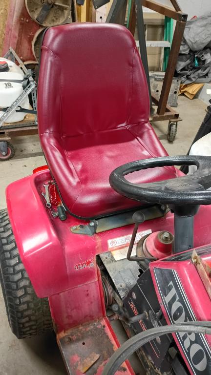

Joe BenHayon 85 #25007 Posted November 27, 2025 New Seat! This machine looks to have been left outside and neglected for more than a few years. I found what looked to be a good replacement highback seat from my local tractor supply, but I didn't like the way it fit. So.... Found a local upholsterer to recover the old seat. I like the fit and the color a lot better. 😁 Now just waiting on new belts so I can go play. 😁😁😁 7 4 Share this post Link to post Share on other sites

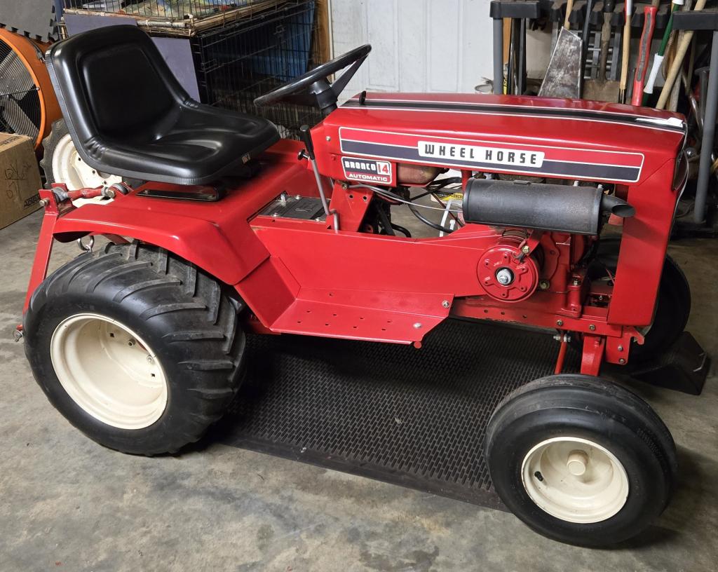

kpinnc 17,690 #25008 Posted November 27, 2025 Had to rearrange my garage area today. So much stuff in there that I couldn't work on anything. My daughter took the Ranger out for it's last ride until spring. Then I put it and the 867 in my storage building and tucked them in. Then I moved the 701 onto my lift so I can finish it up over the winter. My knees won't let me work on another one on the floor. The Bronco, 523-H, and V-14 moved back into the garage since they will still work through winter. Now at least I have room to tinker again. Time to make a new mess now I guess! 16 Share this post Link to post Share on other sites

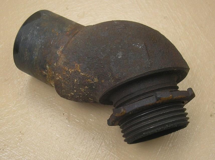

Bar Nuthin 2,275 #25009 Posted November 27, 2025 (edited) 33 minutes ago, kpinnc said: Where might a fellow search for that same muffler? I was contemplating a stack, but I like the looks of that more better! Edited November 27, 2025 by Bar Nuthin 3 Share this post Link to post Share on other sites
kpinnc 17,690 #25010 Posted November 27, 2025 (edited) 37 minutes ago, Bar Nuthin said: Where might a fellow search for that same muffler? It's just off a 300 series. I took it from a 312-H if I remember correctly... Any 310/ 312/ 314 with a Magnum engine should be the same. Just be sure to get the elbow that goes with it. Edited November 27, 2025 by kpinnc 4 1 1 Share this post Link to post Share on other sites
ebinmaine 78,110 #25011 Posted November 27, 2025 4 hours ago, Bar Nuthin said: Where might a fellow search for that same muffler? I was contemplating a stack, but I like the looks of that more better! 4 hours ago, kpinnc said: It's just off a 300 series. I took it from a 312-H if I remember correctly... Any 310/ 312/ 314 with a Magnum engine should be the same. Just be sure to get the elbow that goes with it. Did you have to extend the pipe at all? I've seen a couple of that newer style muffler on older tractors that were too close to the hood and affected the paint. 1 Share this post Link to post Share on other sites
ebinmaine 78,110 #25012 Posted November 27, 2025 5 hours ago, kpinnc said: Time to make a new mess now I guess! Best part of the process! 3 Share this post Link to post Share on other sites
kpinnc 17,690 #25013 Posted November 27, 2025 7 hours ago, ebinmaine said: Did you have to extend the pipe at all? You made me go look... and you are correct. I do not have to original adapter but rather a short nipple then 45 degree NPT elbow and a short pipe to clamp the muffler to. Also made an adapter to bolt the brace to. It's probably an inch or two too far out, but I wanted to make sure I didn't cook the decals. 5 Share this post Link to post Share on other sites
ebinmaine 78,110 #25014 Posted November 27, 2025 4 minutes ago, kpinnc said: It's probably an inch or two too far out, but I wanted to make sure I didn't cook the decals. IMHO you're better off being there than 1/32 too close. I remember blabbing with a people or two and deciding that the "safe" distance to a muffler from a properly running Kohler single cylinder was about an inch. 3 Share this post Link to post Share on other sites
kpinnc 17,690 #25015 Posted November 27, 2025 1 hour ago, ebinmaine said: remember blabbing with a people or two and deciding that the "safe" distance to a muffler from a properly running Kohler single cylinder was about an inch. I'd go along with that. These canister mufflers tied to a Kohler get mighty warm. Reminds me that one needs a guard... 4 Share this post Link to post Share on other sites

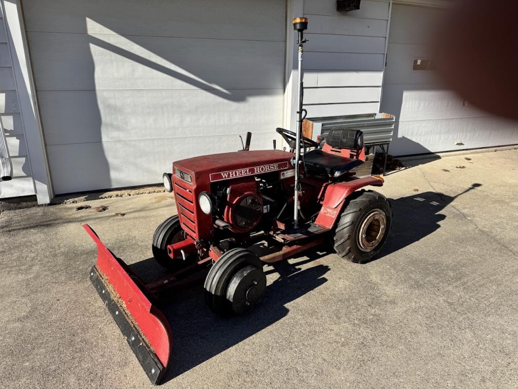

WHGuy413 2,851 #25018 Posted November 29, 2025 (edited) Well getting things prepped for the inevitable snow. Went out and put a battery in my bronco 14 with the 18hp Briggs vanguard v-twin in it. Started right up and ran exceptional after sitting for over a year. Last time i swapped the battery out I ground the positive terminal to the choke cable. It melted through the metal casing but the wire on the inside was still good. So being cheap as I am I redneck fixed it with a stick off the tree outside the garage and some electrical tape. Worked like a charm. The choke works like it should now. Temporary but probably long term fix 😂 Edited November 29, 2025 by WHGuy413 2 9 Share this post Link to post Share on other sites

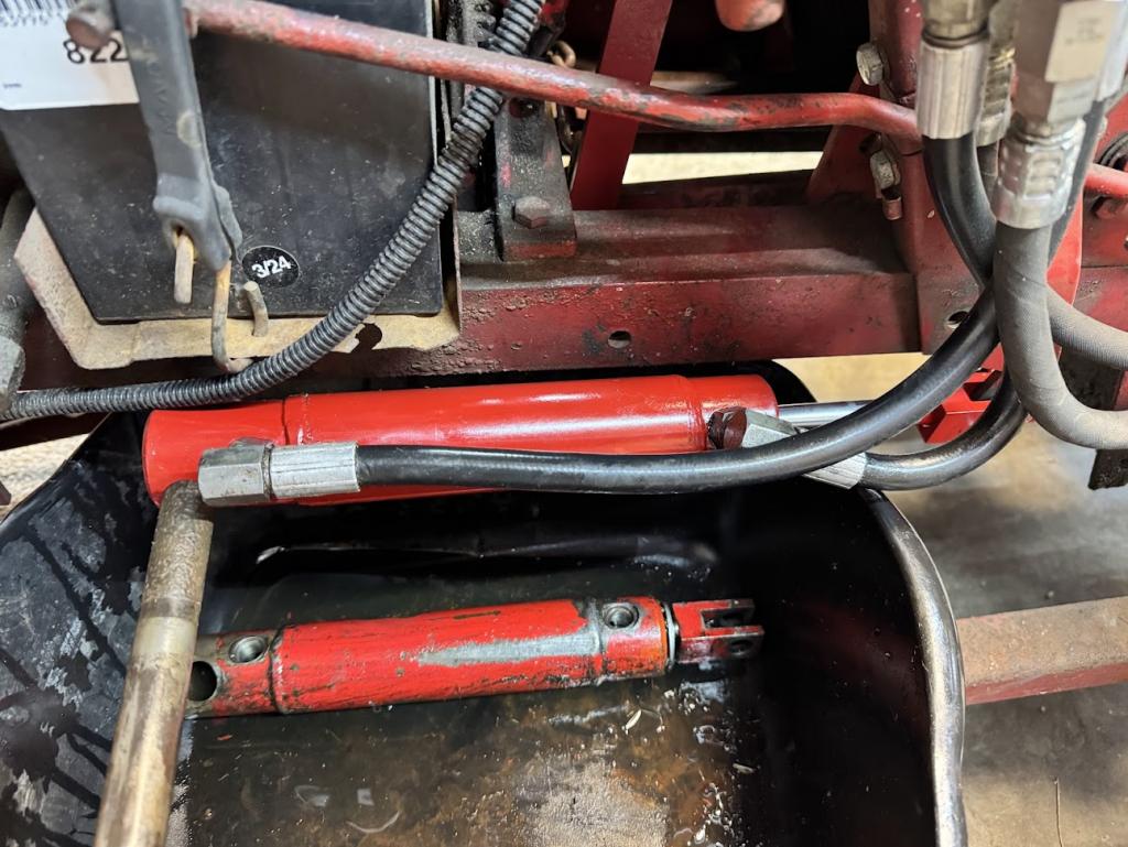

Bar Nuthin 2,275 #25024 Posted November 29, 2025 Not going to plow snow until it slows down - 5+ inches so far. So I decided to engage in the official act of fiddle-farting. When I pulled the lift cylinder off of "Johnny Cash" I decided to send it to @wheelhorseman and have it rebuilt. Today, I decided I might as well put it on my C-120 since the one I bush-fixed still leaves a few drips wherever I park it. May just send it in for rebuild also, since Lowell does such a nice job! While I was in the general vicinity, I remembered that I scored a "small" battery tray (wish I could find another) that needed a back-strap. So I did a little brazing and a shot of paint. 4 2 Share this post Link to post Share on other sites
ebinmaine 78,110 #25025 Posted November 29, 2025 16 minutes ago, Bar Nuthin said: the one I bush-fixed still leaves a few drips wherever I park it. Maybe next time don't use bushes. 17 minutes ago, Bar Nuthin said: a "small" battery tray (wish I could find another) Get me some measurements. Likely I've got one or 3. 3 Share this post Link to post Share on other sites
