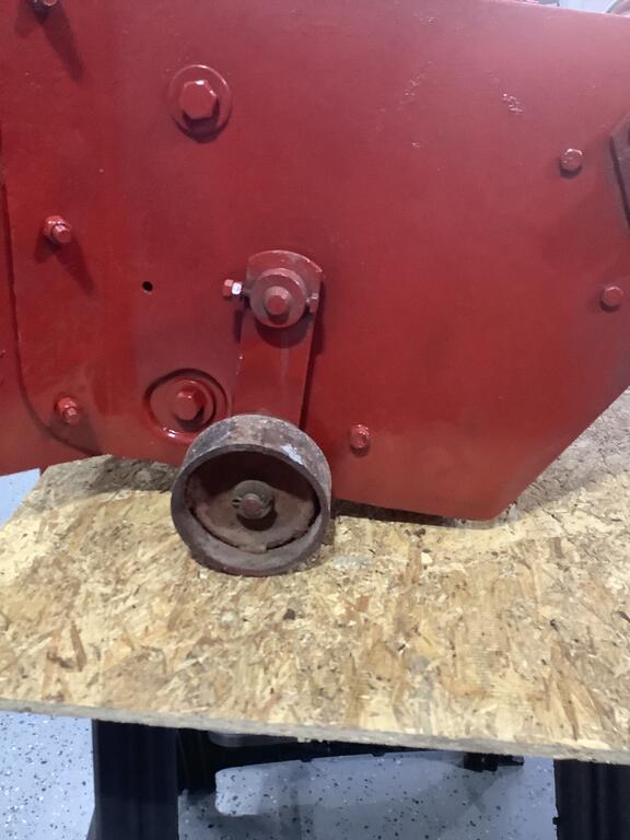

Huntingtown520hc 6 #19 Posted January 30, 2022 Snowblower two mod questions 1) thinking about changing my wheels on my single stage to something like this from TSC https://www.tractorsupply.com/tsc/product/arnold-8-in-steel-wheel?cm_vc=-10005 2) someone converted this from a short chute to a long chute but I think they for got to add a collar in the chute opening to help it show farther … my question is do I need to add a piece of sheet metal to close up the opening ? Share this post Link to post Share on other sites
peter lena 10,090 #20 Posted January 30, 2022 @Huntingtown520hc you can easily add that chute enhancer , either get the original w/h piece or look up the part and specs and make one yourself. having the older model single stage like yours , went over to the bolt on ski type , shaped like an L in design ,drill and bolt on , work well. use a snow release spray in your chute area , helps discharge, use a specific CHAIN AND CABLE LUBRICANT ON YOUR AUGER DRIVE . never let mine dry out , spray before and after use. 1/2" play on that # 40 chain . add this for easy chute control . did this years ago , simple easy , all you need is a die nut , taper grind end , pete Share this post Link to post Share on other sites
Huntingtown520hc 6 #21 Posted January 31, 2022 Has anyone replaced the metal casters with pneumatic wheels? I have a 1/4 gravel lane and want to avoid sucking up rocks. Share this post Link to post Share on other sites
Huntingtown520hc 6 #22 Posted February 6, 2022 Thinking about adding these since part of my lane out to the road is gravel https://www.amazon.com/Arnold-Steel-Wheel-lb-Load-Rating/dp/B000VO6TC8/ref=sr_1_4?crid=3L66EO5IBXNH0&keywords=wheels+lawn+mower&qid=1644152360&sprefix=Wheels+law%2Caps%2C69&sr=8-4 Share this post Link to post Share on other sites
Huntingtown520hc 6 #23 Posted February 6, 2022 Or these https://www.amazon.com/dp/B0897G37Z3/ref=sspa_dk_detail_3?pd_rd_i=B08TW9PV83&pd_rd_w=H5Ttk&pf_rd_p=54ed5474-54a8-4c7f-a88a-45f748d18166&pd_rd_wg=eDm7H&pf_rd_r=SFT0XBYMW2M88G2NMRPD&pd_rd_r=7722b9e5-88a0-4c34-8f14-c9f79a8aeeb4&s=lawn-garden&spLa=ZW5jcnlwdGVkUXVhbGlmaWVyPUEzQjRGRzVRMFlLNkVGJmVuY3J5cHRlZElkPUEwMDM2MzA3VzhCSEc5Qlc1VkU0JmVuY3J5cHRlZEFkSWQ9QTA5MjM1NTczUUNJUUI4RktRNVdRJndpZGdldE5hbWU9c3BfZGV0YWlsX3RoZW1hdGljJmFjdGlvbj1jbGlja1JlZGlyZWN0JmRvTm90TG9nQ2xpY2s9dHJ1ZQ&th=1 Share this post Link to post Share on other sites
Ed Kennell 47,600 #24 Posted February 6, 2022 5 minutes ago, Huntingtown520hc said: Or these https://www.amazon.com/dp/B0897G37Z3/ref=sspa_dk_detail_3?pd_rd_i=B08TW9PV83&pd_rd_w=H5Ttk&pf_rd_p=54ed5474-54a8-4c7f-a88a-45f748d18166&pd_rd_wg=eDm7H&pf_rd_r=SFT0XBYMW2M88G2NMRPD&pd_rd_r=7722b9e5-88a0-4c34-8f14-c9f79a8aeeb4&s=lawn-garden&spLa=ZW5jcnlwdGVkUXVhbGlmaWVyPUEzQjRGRzVRMFlLNkVGJmVuY3J5cHRlZElkPUEwMDM2MzA3VzhCSEc5Qlc1VkU0JmVuY3J5cHRlZEFkSWQ9QTA5MjM1NTczUUNJUUI4RktRNVdRJndpZGdldE5hbWU9c3BfZGV0YWlsX3RoZW1hdGljJmFjdGlvbj1jbGlja1JlZGlyZWN0JmRvTm90TG9nQ2xpY2s9dHJ1ZQ&th=1 Probably the better buy. 1 Share this post Link to post Share on other sites
peter lena 10,090 #25 Posted February 6, 2022 @Huntingtown520hc , plowing / blowing over gravel is tough , think your main issue is that your blower has to SIDE / SLIDE , not dig in , look here http://snowblowerskids.com/ for possible ideas. personally those spring loaded disc skids used om bigger plows , have the softer slide , that works better . those one track wheels will not give you the angle support you want. look up QUAD , plowing accessories . they often use those spring mounted sliders , pete Share this post Link to post Share on other sites
