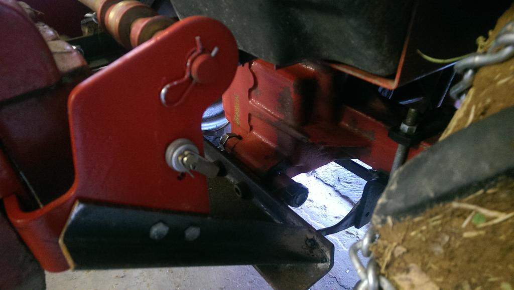

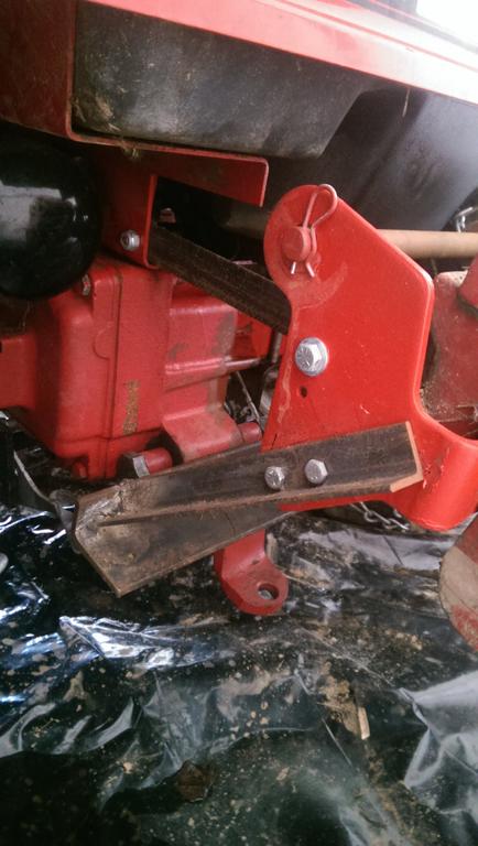

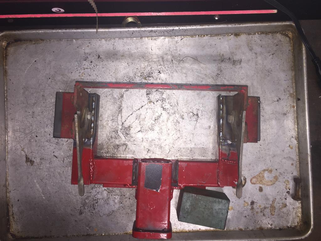

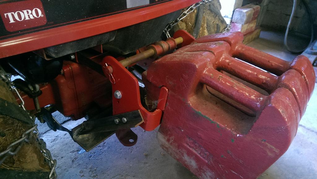

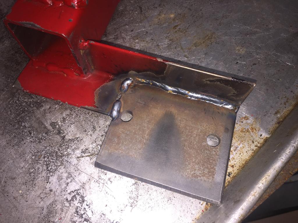

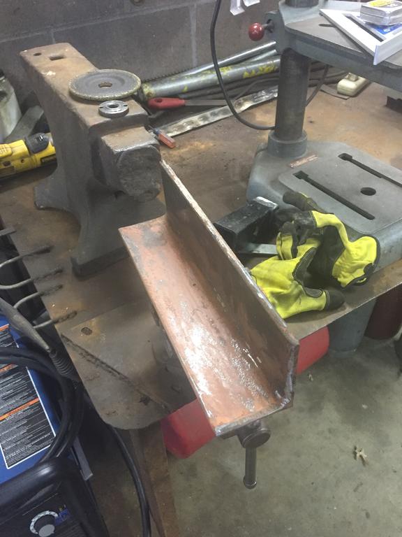

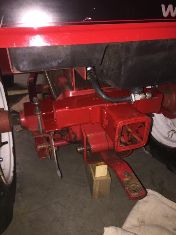

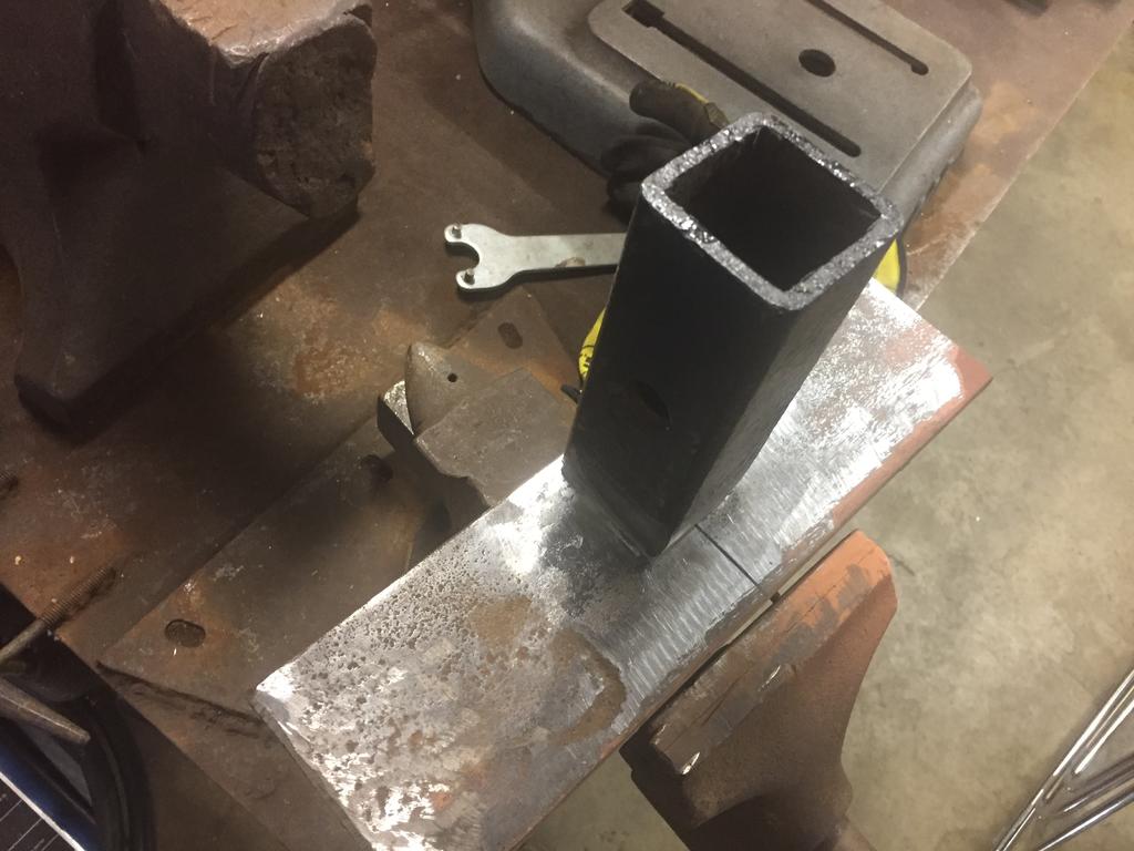

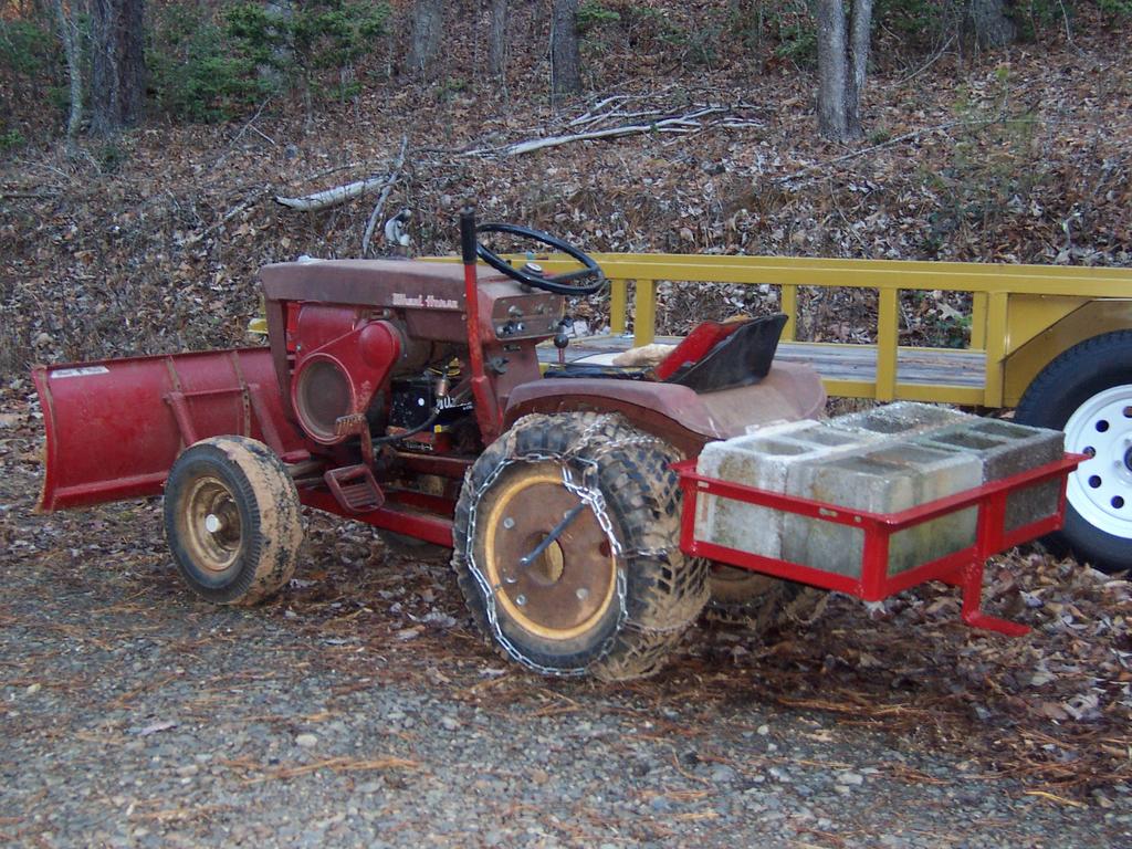

Red144runner 659 #1 Posted January 4, 2018 Last storm we had I was slipping a bit plowing the sidewalk up grade. Part of it was due to ice under the snow. The other problem I had was the control lever for the plow kept coming off it's pivot (nut and bolt). To solve the trAction issue I added my suitcase weights. But to do that I had to mount my 2" receiver, and that needed to be widened to line up with the plow frame. I finished that then rebuilt the weight bracket out of 3" header beam. Holds 4 44lb weights. I fixed the control arm tonight with the right size bolt (1/2" coarse thread I think) with a lock bolt. Should work now. So with 100lbs of cast iron in the wheels and another 200lbs on the hitch I hope to see improvement. I have chains but I don't want to chew up a 3 month old driveway. I'll have some good pics tomorrow I'm sure top 2 are the rebuilt hitch then the bracket 7 6 Share this post Link to post Share on other sites

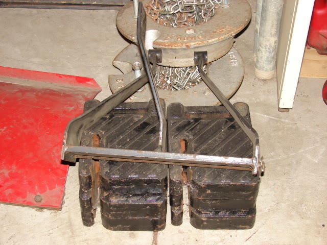

WVHillbilly520H 10,379 #2 Posted January 4, 2018 Good job there I made my rear weight hanger in the Berco style, holds 3, Jeff. 7 Share this post Link to post Share on other sites

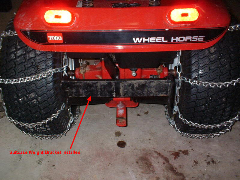

953 nut 69,841 #3 Posted January 4, 2018 32 minutes ago, Red144runner said: I have chains but I don't want to chew up a 3 month old driveway. I have found that added weight makes for a lot less wheel spin. Mine is crude but effective. 5 3 Share this post Link to post Share on other sites

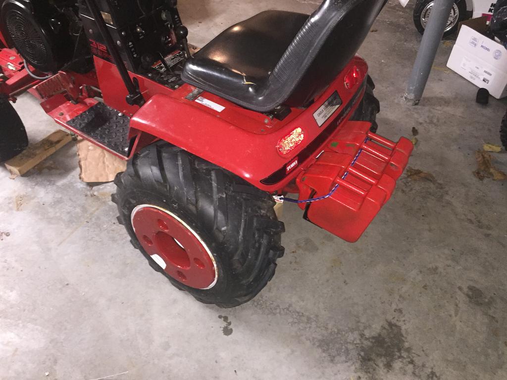

Ed Kennell 47,618 #5 Posted January 4, 2018 Not much snow here, but the wind is causing some drifting. All schools have a 2 hour delay. Might have to fire up a horses later today. Oh, Size does matter, When putting the rubber to the road. 4 3 Share this post Link to post Share on other sites

Red144runner 659 #8 Posted January 4, 2018 2 hours ago, Ed Kennell said: Not much snow here, but the wind is causing some drifting. All schools have a 2 hour delay. Might have to fire up a horses later today. Oh, Size does matter, When putting the rubber to the road. That's a load on there. Nice set up 3 Share this post Link to post Share on other sites
