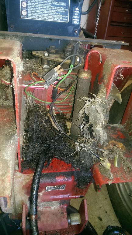

WVHillbilly520H 10,379 #53 Posted January 8, 2018 @PeacemakerJack, I can tell you from experience with my hydro since new and doing everything from mowing to garden tilling and snow removal (WOT), to driveway repairs with the rear box/scraper blade and turn plowing (at less than WOT), as long as that fan is good and installed correctly and the hydro pump/fins are clean it doesn't overheat, I regularly washed with garden hose and compressed air to "clean" after mowing but transfluid changes and seeping at the dipstick oil does get places you can't see then add dust,chaffe, and grass it gets packed in those hydro pumps and 3-4 summers ago I had the trans temp light come on while mowing with the anniversary, pulled the seat and fender pan, and no I didn't have it clean as I thought I did electric pressure washed it and no issues since, but that was 15+ years into it, so my point is I don't think you will need an external fluid cooler as long as you keep it clean, I'll add some pics of the '95 I picked up 2 years ago before and after you'll see what I mean, Jeff. 2 2 Share this post Link to post Share on other sites
WHX?? 58,387 #54 Posted January 8, 2018 Was thinkin along those same lines Jeffery ..Those fans weren't meant to move crud just air! 1 3 Share this post Link to post Share on other sites

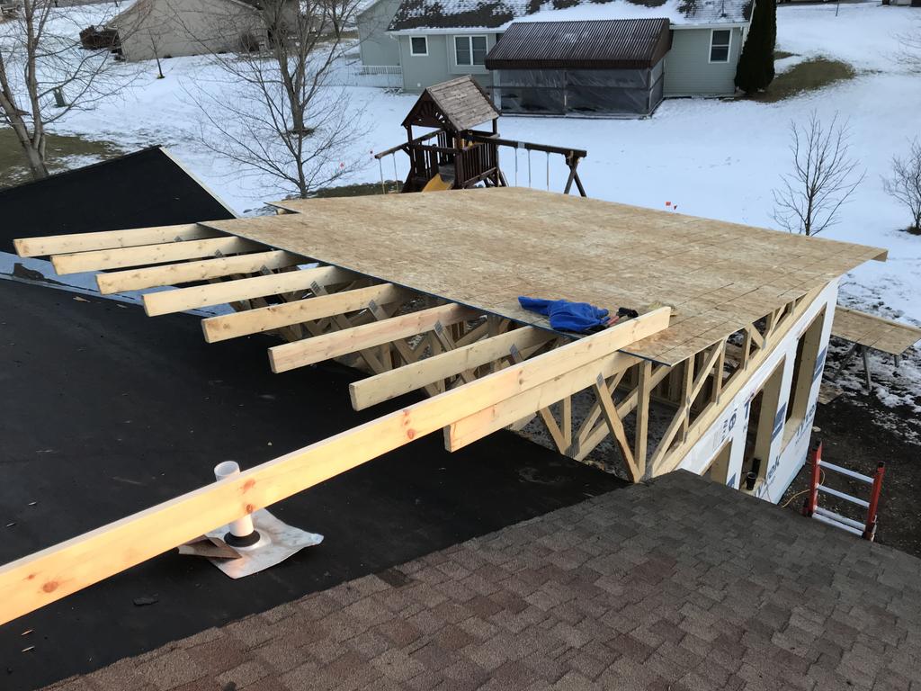

PeacemakerJack 11,096 #73 Posted January 8, 2018 This is fascinating...! I’m up on the roof working away but in between waiting on my cut man to hand me sheets of plywood, I’ve been following this discussion! Keep it up, let’s see if we can get to the bottom of this. @CasualObserver can you weigh in on this? While we we are comparing the C to the A—I’ve read that the C has faster gearing. Is that true? I know that JackRabbit is definitely faster than my cousins 520H but...? 4 Share this post Link to post Share on other sites

ebinmaine 81,278 #75 Posted January 8, 2018 22 minutes ago, PeacemakerJack said: I’m up on the roof working away but in between waiting on my cut man to hand me sheets of plywood I do the same thing on this site while waiting for my own customers or whatever off and on.... 1 Share this post Link to post Share on other sites
