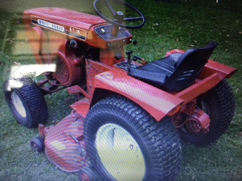

CountySmoke 7 #1 Posted December 29, 2017 (edited) Hey there, I’m new to the old tractor/ wheel horse world. A guy is selling this GT 14, and I’m curious as to what you guys think it is worth based on your knowledge. He is asking $900. I know it has complete 3 point set up, and PTO. Along with the blade. He says blade is hydraulic. It also comes with the mowing deck in working condition. According to seller it runs great. I haven’t seen it yet but from the picture it looks like a solid machine. Any thoughts appreciated. Thanks! Edited December 29, 2017 by CountySmoke 4 Share this post Link to post Share on other sites
Aldon 4,826 #2 Posted December 29, 2017 If that is a working 3 point hitch, it’s worth 3-400 by itself. Deck is work at lest a 100. The plow is not correct for it. The GT14 May be set up to use the Hydraulics to lift the plow 3-4 inches or so. Depending on how he has implemented the non wheel horse plow, it may or may not have down pressure. It has manual rather than electric clutch and it appears to have modified front lights. Depending on how it runs, and the condition of the dash and tunnel plates, 900 May be fair price. Muffler is also not original. 3 Share this post Link to post Share on other sites
KC9KAS 4,741 #3 Posted December 29, 2017 @CountySmoke to another Hoosier. Wheel Horse front blades can be angled right, left, center from the seat. Not sure about the one on this GT14. I have a GT14 and it has been a "snow pusher" in the past. It is a beast of a tractor! 2 Share this post Link to post Share on other sites
953 nut 51,721 #4 Posted December 29, 2017 In spite of a few non-Wheel Horse original modifications it looks very good. The GT-14 is a strong pusher and if it runs well and the transmission is strong you will be doing OK at $ 900. Bring a chain with you and tie it off to a tree to see if it will spin the tires in both directions against an immovable object. Depending on the size of your yard it will do a good job of mowing. If you have a small yard with lots of turns it might not be the best choice. 3 1 Share this post Link to post Share on other sites
Sarge 3,462 #5 Posted December 29, 2017 "blade is hydraulic" - means it lifts off the hydraulics via the rock shaft system on the tractor - it's not a power angle setup or anything like that - just fyi ... Biggest sticking point is the older transmission/pump system - it's an older Sundstrand and if it's in good condition with no issues that's fine , otherwise if it's weak in reverse it will need repaired or replaced and parts aren't cheap . Keep things like that in mind as it needs to be tested when fully hot - especially in reverse . Prices vary by region/condition/equipment - that 3pt will command a higher price . The non-stock blade , and any possible hacking of the tractor are not a good thing . Sarge 3 1 Share this post Link to post Share on other sites
CountySmoke 7 #6 Posted December 29, 2017 (edited) Thanks for all the good info guys. I would just use it as a utility tractor to push the driveway off, move mulch etc. I wouldn’t be mowing with it. I will go check it out, get it warmed up and see how it runs. Maybe try to get him down on the price a little. Thanks again! Edited December 29, 2017 by CountySmoke 3 Share this post Link to post Share on other sites
