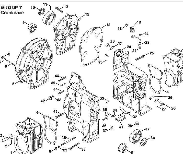

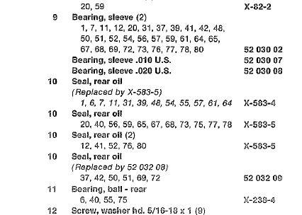

Goldann520 242 #30 Posted December 28, 2017 I'm guessing by crank size, you mean for the different pto set-ups among manufacturers. 1 Share this post Link to post Share on other sites
pfrederi 21,307 #31 Posted December 28, 2017 (edited) Crank lengths, keyway sizes, size of tapped hole in the end etc. However one big difference was WH specified a ball bearing on the crank shaft item 11 and 47.. JD did not (sleeve #9 ). Thus I had to use an Electric PTO when i put a JD KT 17 on my C-175. 30 variant number on Series 1 used sleeve bearings only 4 used ball bearings In the series 2 ball bearings were not offered but a roller thrust bearing was used on only 1 variant Edited December 28, 2017 by pfrederi 3 Share this post Link to post Share on other sites
