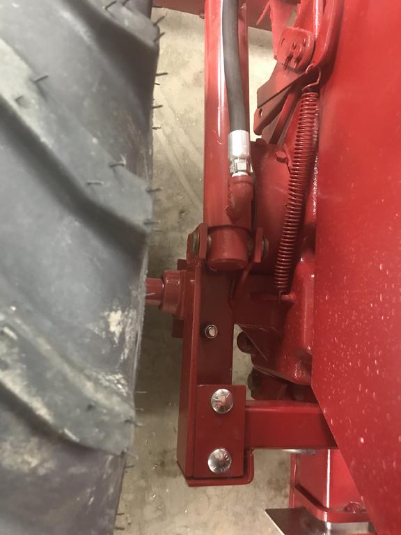

wheelhorseman 3,256 #30 Posted December 28, 2017 (edited) Jim that bracket is correct, you have it on correct, I made special brackets and welded them in my receiver hitch mounting bracket — I put the newer style axle bracket on mine. And check out the pic my break band is installed Edited December 28, 2017 by wheelhorseman 1 Share this post Link to post Share on other sites

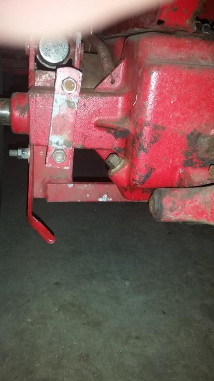

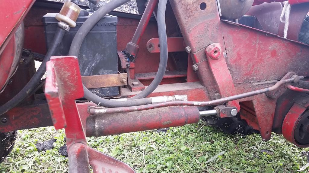

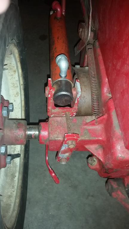

WHX?? 56,847 #31 Posted December 28, 2017 Yup didn't see it under that nice RED...get ready to send me a set of HY lines just like that then! 1 Share this post Link to post Share on other sites
