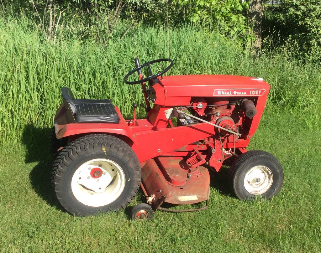

gwest_ca-(File Mod) 12,511 #2 Posted December 21, 2017 Does it look like this one? Click on the picture. Garry Share this post Link to post Share on other sites

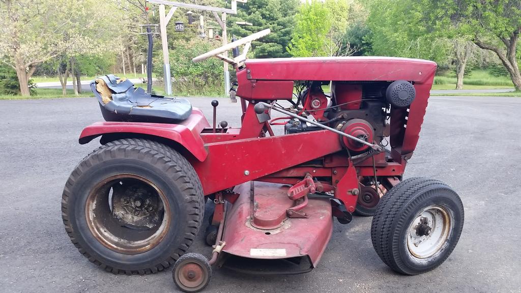

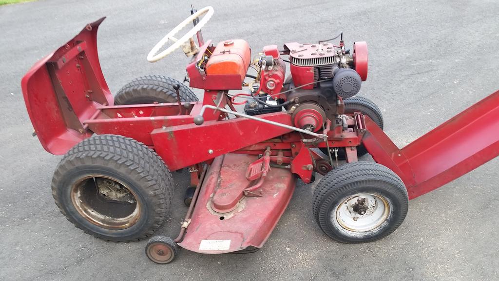

WHX?? 58,307 #3 Posted December 21, 2017 Some pics here would help but sounds like a PO somewhere over the years adapted a late style deck to an older tractor with a front mount mule drive. The original would have ran straight down to a pulley system below the PTO. Here are some pics of what it would have looked like with the correct deck as in the manual above. This is a 1067 but same tractor only a six speed. Different size mower decks as well as the PTO were optional on all tractors. I might add there are some extra springs in these pics that were added by a PO for belt tensioning. 3 Share this post Link to post Share on other sites

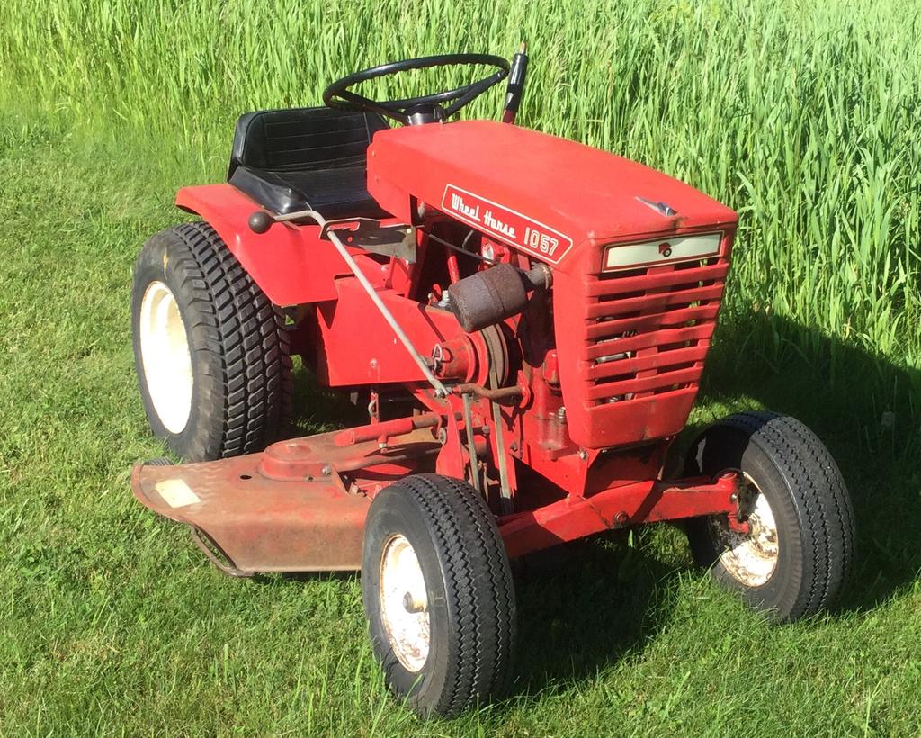

ACman 7,746 #4 Posted December 21, 2017 ....Just some extra pics of my survivor 1057 . Some pics would help us help you ., 3 Share this post Link to post Share on other sites

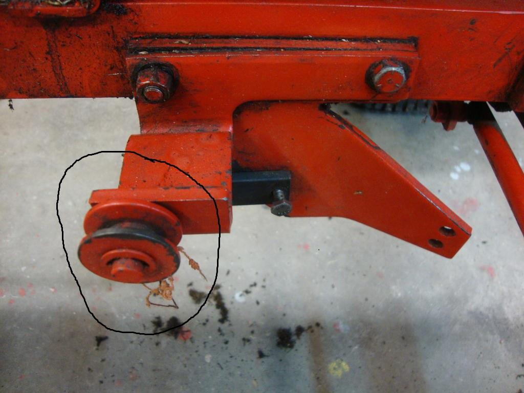

WHX?? 58,307 #6 Posted December 21, 2017 Excellent example of a late model deck on an early model frame. That little pulley looking thingy may be broke off on yours as it is missing in mine hence the extra springs for belt tension. Note Jeff's tractor still has the original early design on it. Early designs were prone to breaking off therefore redesigned beefier bracket as in @dclarke 's pic. This whole setup was prone to issues so lots were converted to the front mule drive. Late decks in decent shape are more available these days helped too. Not sure if retro kits were offered or not? 1 Share this post Link to post Share on other sites

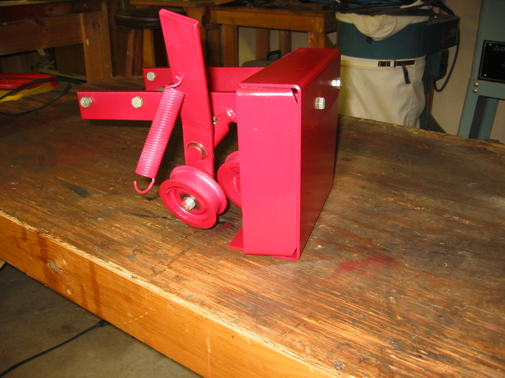

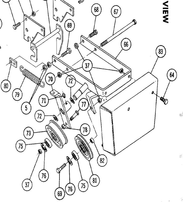

pfrederi 21,231 #7 Posted December 21, 2017 Sometime between the original set ups shown in the post above and the modern front mounted mule drive Wheel Horse used this forerunner of the new mule drive. Does yours look like this??? 3 Share this post Link to post Share on other sites

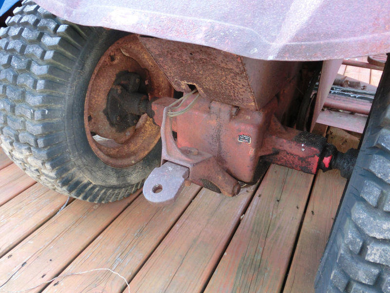

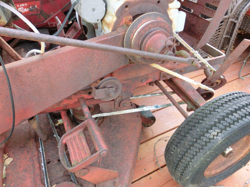

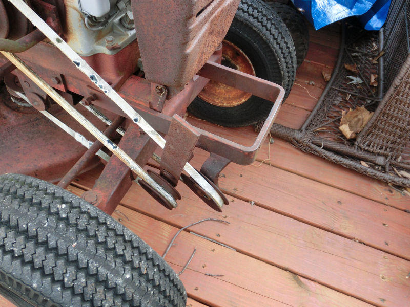

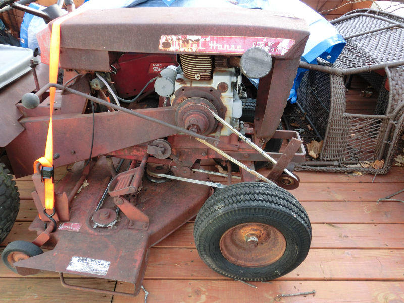

mpoore 34 #8 Posted December 22, 2017 Thanks guys. You saved me a lot of time with great examples of the various setups. This will be especially helpful since there are missing parts. It looks like I have a little of both, but the mule drive forerunner is what is being used to operate the deck. I now have pictures. It ain't pretty. The lift lever is currently attached to cables that go to the rear hitch. Was this used to raise rear implements? I am guessing that something is missing that would make the purpose more evident. I think I may have over-paid at $125, but I did get two engines that will run after carb cleaning. The problem I see is the number of missing or broken parts. Just a partial list of the obvious includes seat bracket, steering wheel, tires, belts, flywheel cover, seized mower deck bearings, pin holes in mower deck, air filter housing, battery, and wiring. I should be able to get my money back getting the engines running and selling them along with whatever usable parts remain. The restorable parts don't seem rare, so I am not even sure it's worth the time. It is probably sacrilege on this board to part out a WH, but do you guys see another option without this turning into a money pit? A full restore is not going to happen. Getting it running well and fully functional with a deck might make it worth $300-$400, but that is probably less than the rehab cost. Even that price might be wishful thinking given appearance. What do you guys think? Share this post Link to post Share on other sites
pfrederi 21,231 #9 Posted December 22, 2017 You have the interim mule drive like the one in my photos above just are missing the protective plate over the front. There is a spring that goes from the arm to a small tab that would be bolted to the frame of the tractor. Share this post Link to post Share on other sites

gwest_ca-(File Mod) 12,511 #11 Posted December 23, 2017 Looks like that idler assembly only came with the 36" decks 1969-1972 1969 36" RD deck model 5-7365 1970 36" RD deck model 5-7366 1971 36" RD deck model 5-0600 1972 36" RD deck model 5-0601 1971 36" SD deck model 5-0710 1972 36" SD deck model 5-0711 A later manual that covers them all Garry 2 Share this post Link to post Share on other sites
