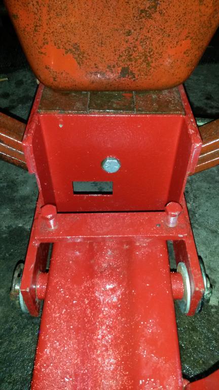

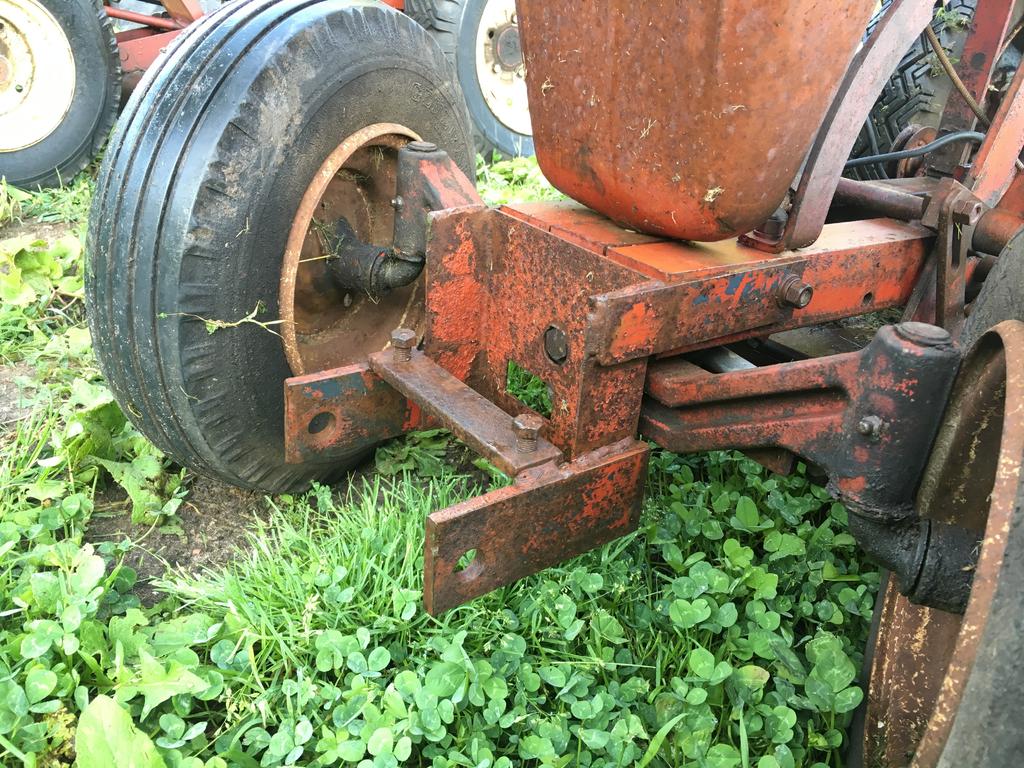

oliver2-44 11,698 #1 Posted December 16, 2017 I have a suburban snow/dozer blade but an missing the mounting bracket pictured below. it looks like it would be easy to build. If anyone would make a sketch with measurements I would really appreciate it. 1 Share this post Link to post Share on other sites

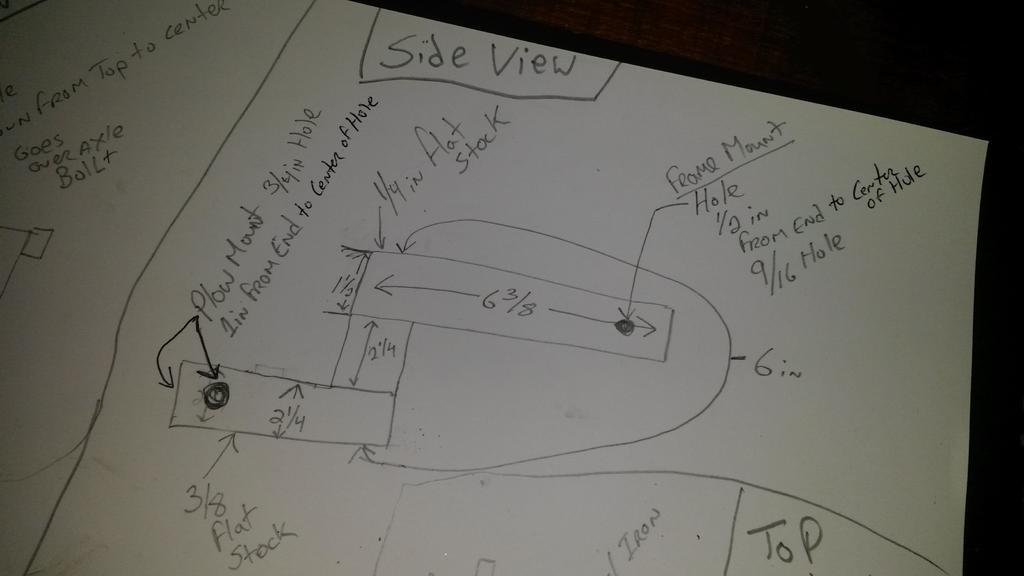

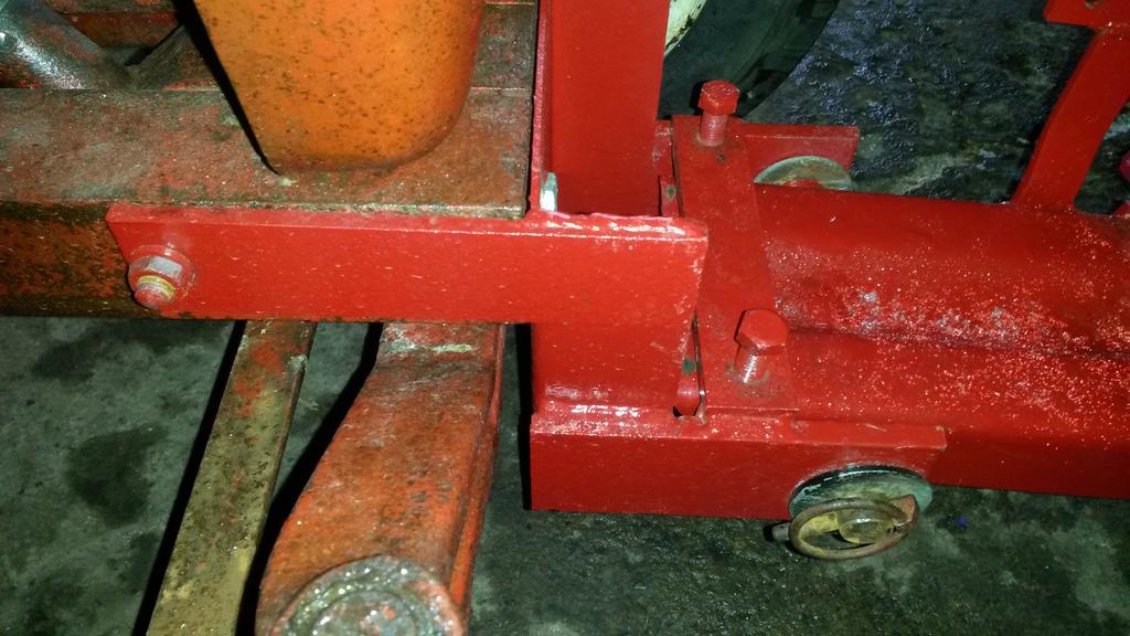

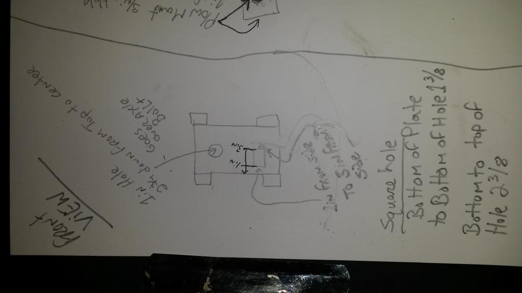

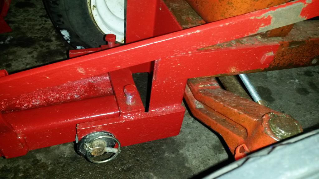

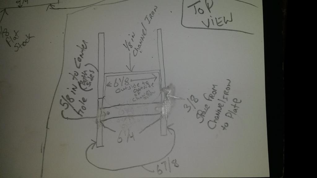

Chris G 3,385 #2 Posted December 22, 2017 I'll get some pics for ya tomorrow with measurments. 3 Share this post Link to post Share on other sites
Chris G 3,385 #3 Posted December 22, 2017 I'm not a artist. But hope these help and feel free ask any questions. 2 Share this post Link to post Share on other sites
