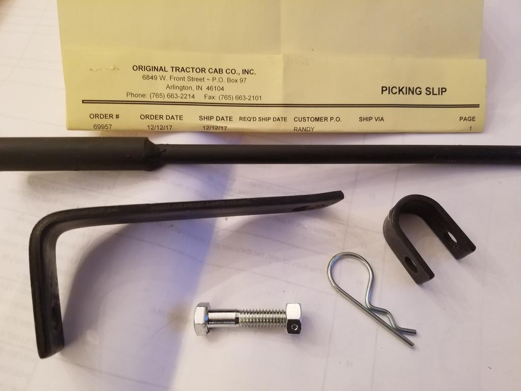

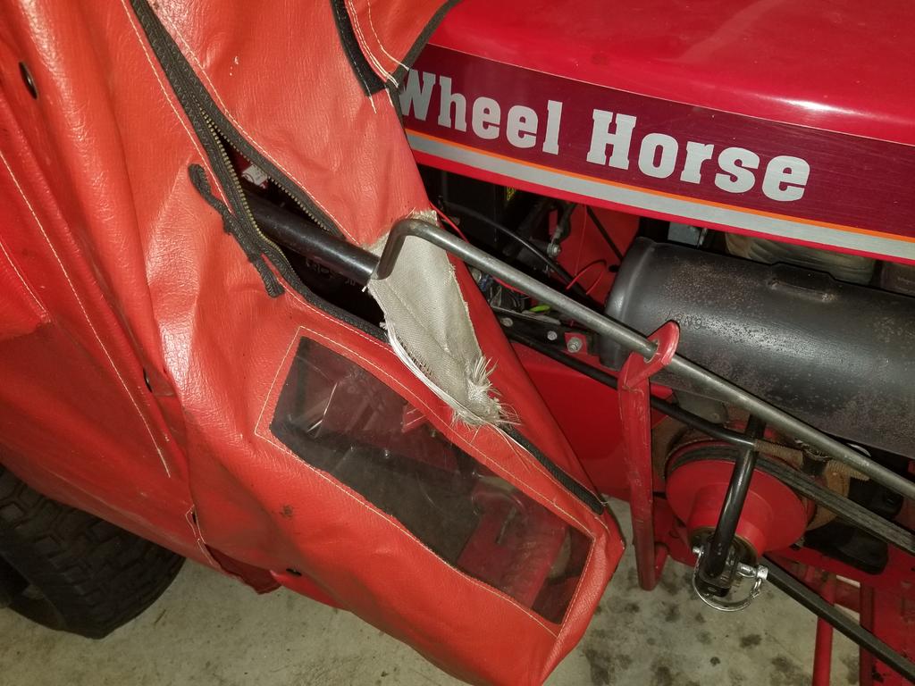

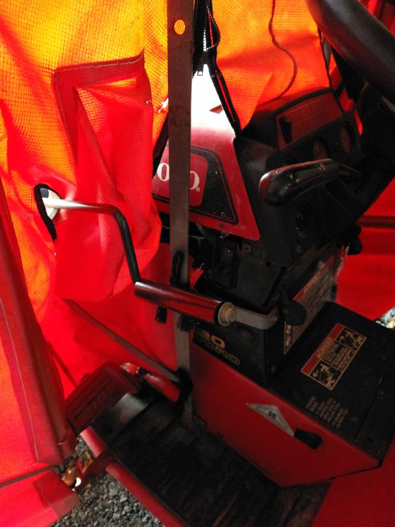

JERSEYHAWG / Glenn 4,567 #1 Posted December 15, 2017 STILL AVAILABLE FROM ORIGINAL TRACTOR CAB. I called up Original Cab Co. They are still available to order for the single and 2 stage snowthrower. If you don't have the talent and time etc. (Like me), to make one, you can order it still. Just a FWIW to you fellas looking for them. Just came in the mail, we were talking about these snowblower crank handle chute extension pieces the other day. Chute control extension, and bracket to hold it, u clamp. Glenn 5 Share this post Link to post Share on other sites

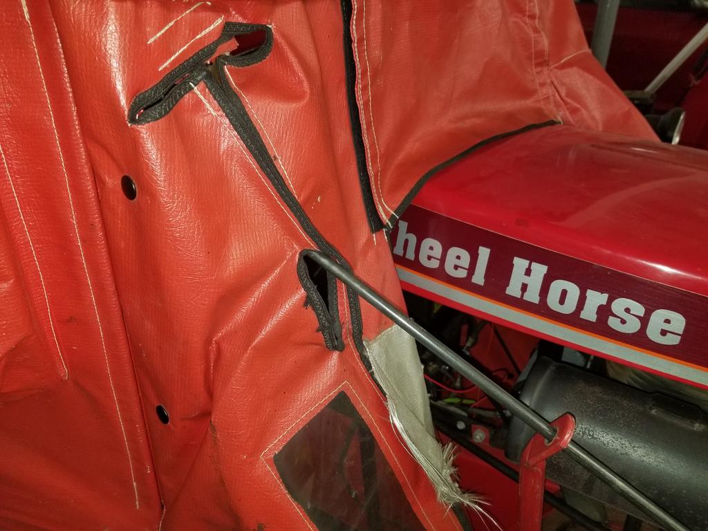

JERSEYHAWG / Glenn 4,567 #3 Posted December 15, 2017 Craig, please note. The handle doesnt make it "into" the cab all the way. Its a crappy picture, hard to tell. Now, the extension piece will bring it into the operators cab, for comfort, AND a warm hand. Will install shortly, and get a good picture. Glenn 1 Share this post Link to post Share on other sites
wallfish 19,834 #4 Posted December 15, 2017 And the million dollar question, because that's the only part of the bill not pictured, How much? Kind of curious if it's comparable to going electric. 2 Share this post Link to post Share on other sites

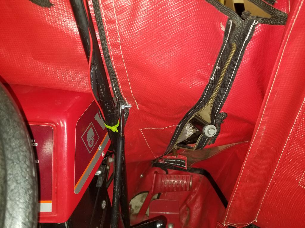

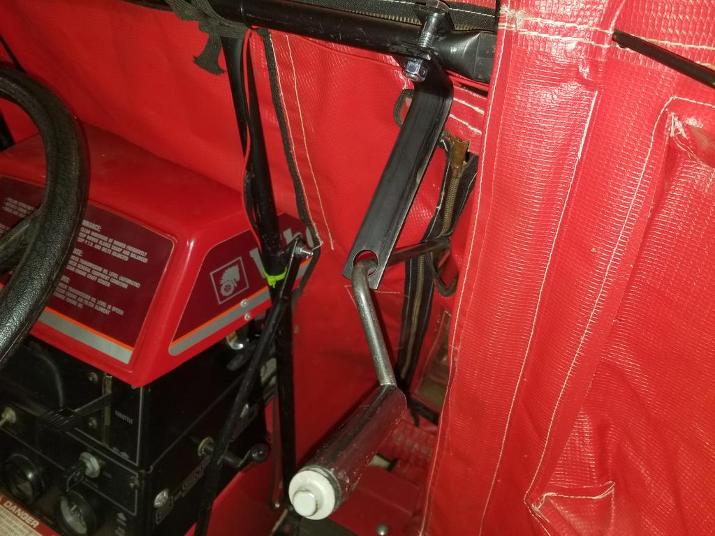

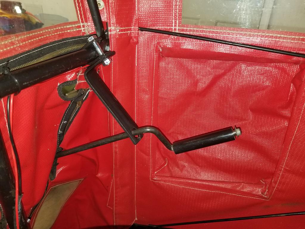

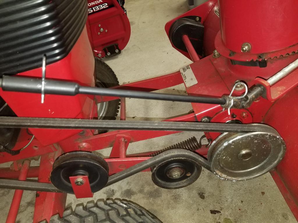

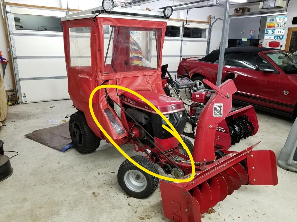

JERSEYHAWG / Glenn 4,567 #5 Posted December 15, 2017 (edited) The first and second picture shows how short to the cab interior. Ok, installation complete. Now the crank handle extends INTO cab, through the correct opening. ??...A WARM hand makes for operating comfort...better than sticking my claw into the snow. Wallfish, that's Cause it was only a packing slip, not a bill. I paid by credit card, when I get it, I will tell you exactly, but I recall the chute extension about 22 bucks, the other pieces maybe 16 bucks and around fifteen to ship Glenn Edited December 15, 2017 by JERSEYHAWG / Glenn 4 2 Share this post Link to post Share on other sites
WVHillbilly520H 10,378 #6 Posted December 16, 2017 Reckon I need to make an in cab hanger bracket now and find some new vinyl upholstery for my cab, looks real good there Glenn.,Jeff. 2 Share this post Link to post Share on other sites

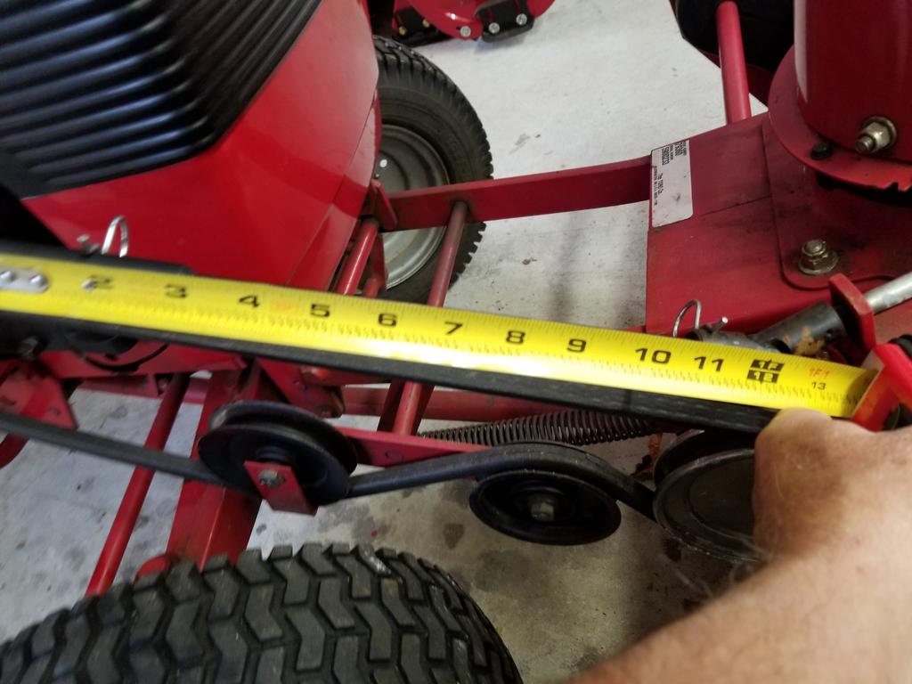

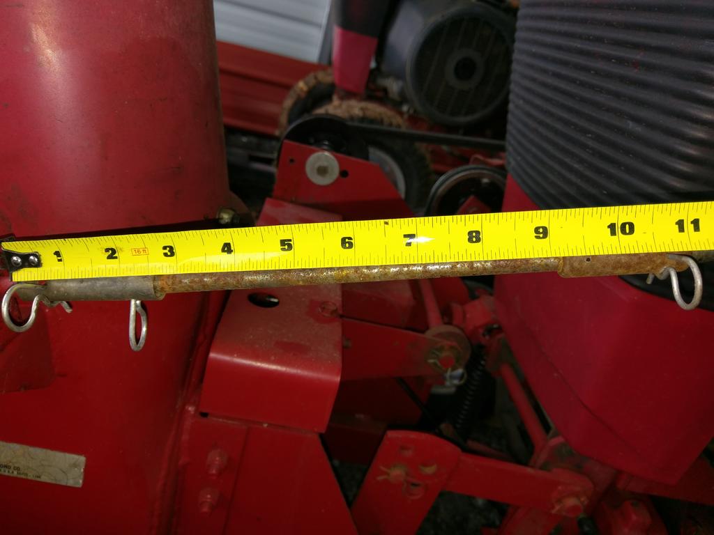

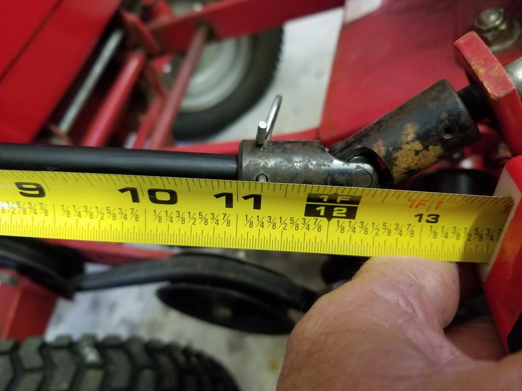

WNYPCRepair 1,924 #7 Posted December 16, 2017 How long is the extension? Looks like about a foot Share this post Link to post Share on other sites
WVHillbilly520H 10,378 #8 Posted December 16, 2017 I made mine about 8-10" looks pretty close to @JERSEYHAWG / Glenn's OCC unit, Jeff. 1 Share this post Link to post Share on other sites
JERSEYHAWG / Glenn 4,567 #9 Posted December 16, 2017 15 hours ago, WNYPCRepair said: How long is the extension? Looks like about a foot Brian, looks around 11 1/2" , pics for you. 12" would work. Glenn 1 1 Share this post Link to post Share on other sites
WNYPCRepair 1,924 #10 Posted December 16, 2017 6 minutes ago, JERSEYHAWG / Glenn said: Brian, looks around 11 1/2" , pics for you. 12" would work. Glenn Thanks. Another of my projects in waiting is building a cab, and I will need to make one. I really need a barn so I can work on stuff like this in the winter... 1 Share this post Link to post Share on other sites
