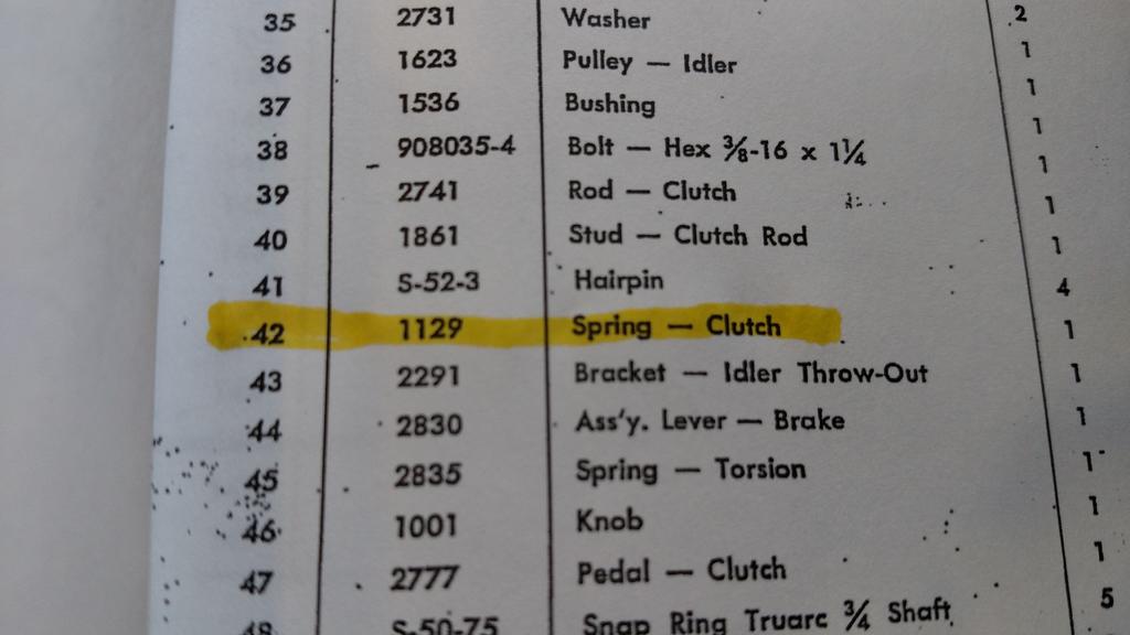

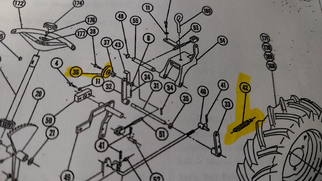

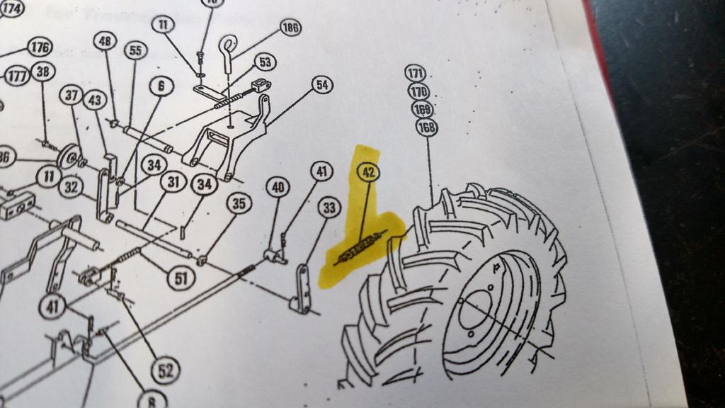

TIGman 2,006 #1 Posted December 12, 2017 (edited) Wasn't sure where to post this, but I think I figured out the problem with the drive belt squealing. The clutch spring 1129 which from what I can see, also puts tension on the drive belt idler pulley number 36 in parts drawing. Apparently the gentleman who had the tractor before broke off part of the hook on the clutch spring and added a smaller spring for the hook. As a result it doesn't have the correct strength. Does anyone have any specifics on the spring size and length or where I can purchase one. Thank you!! in advance Edited December 12, 2017 by TIGman Share this post Link to post Share on other sites

gwest_ca-(File Mod) 12,483 #3 Posted December 12, 2017 See if this link will work to some applications http://www.partstree.com/parts/toro/parts/1129/ ST-323 snowthrower and a couple of B-Series 3-speed models used the 1129 spring which replaced 100228. The front spring on the RMR-3261 mower deck suspension was 1129 Garry 1 Share this post Link to post Share on other sites
