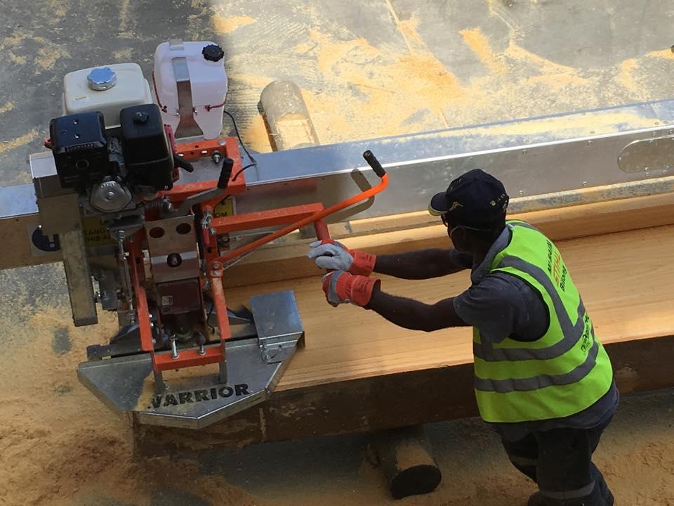

WNYPCRepair 1,924 #3 Posted December 4, 2017 20 minutes ago, wallfish said: To me it appears to have 2 blades, one vertical and one horizontal No, just two guards. If you watch a video, it swings the blade 90 degrees. This one is automatic, but same saw head 1 Share this post Link to post Share on other sites

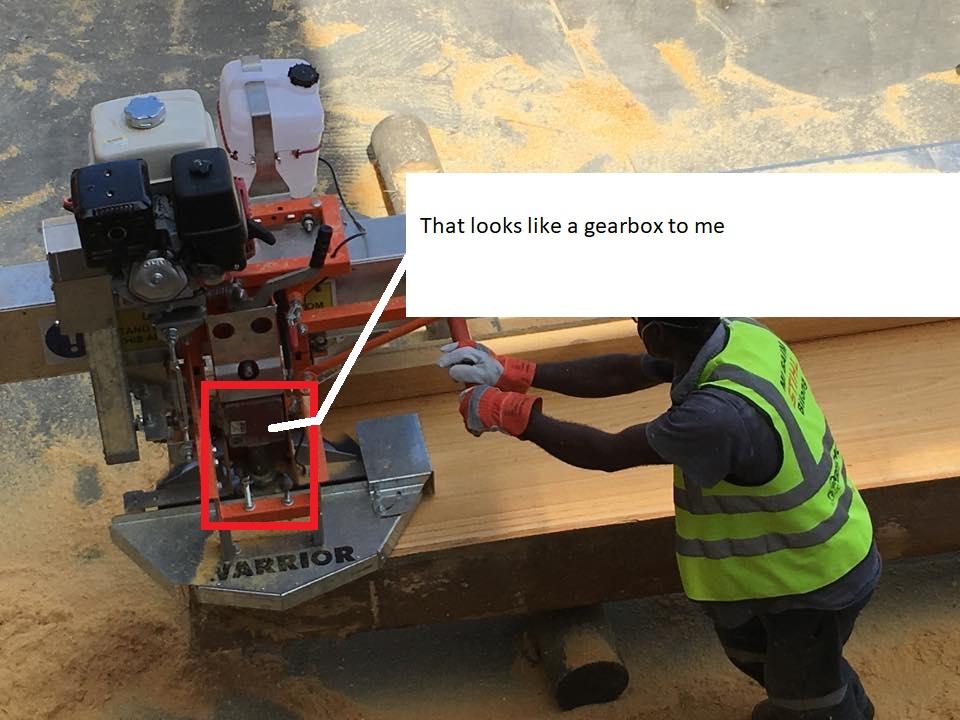

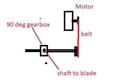

wallfish 19,344 #4 Posted December 4, 2017 (edited) Ah Ha. Now I see said the blind man. Probably done with a 90 degree gearbox. Just kind of thinking "out loud" The saw blade can swivel to both horz and vert positions by the gears Edited December 4, 2017 by wallfish 6 Share this post Link to post Share on other sites

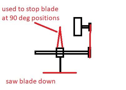

WNYPCRepair 1,924 #7 Posted December 4, 2017 (edited) 2 hours ago, wallfish said: Ah Ha. Now I see said the blind man. Probably done with a 90 degree gearbox. Just kind of thinking "out loud" The saw blade can swivel to both horz and vert positions by the gears So you are saying they are swiveling the gear box on the horizontal shaft with the pulley attached, which makes the vertical shaft rotate 90 degrees? Makes sense. I think we have a winner. Now to find a gear box that doesn't change speed. 1 hour ago, elcamino/wheelhorse said: @JAinVA Jim do you have any thoughts on this ? I think you mentioned that you had a saw mill. That saw is something is something else. This is going to be a dumb question ; what is the advantage of the saw being able to cut on two planes? One cut edges, the other cuts the board. The biggest benefit is the log never moves. No flipping, squaring, etc. Just cut boards (of the exact size you need, not full width of the log) until there is nothing left. With a band saw mill, you cut one side, flip 90 degrees, repeat, repeat, then you Have a square log to cut into boards Edited December 4, 2017 by WNYPCRepair 1 Share this post Link to post Share on other sites
WNYPCRepair 1,924 #8 Posted December 4, 2017 (edited) 29 minutes ago, JAinVA said: Jim, I have looked at the video and I wonder if the drive system is the similar to some 4wd front tractor axles.No u joints,just bevel gearing at the turn points. Being able to saw in two planes means less handling of the lumber.You can saw to thickness, edge the board and not have to move it.The only drawback I see to this type of saw is a limit to board width which I don't have with my bandmill You can double cut. Edge, cut to the max limit, edge the other side and cut to that limit, as long as the log is small enough. They also have an attachment that replaces the blade with a chain saw bar and chain (made for the sawmill) that cuts wide planks. But for what I need, the saw is enough, I don't need anything other than dimensional lumber for building. If I could duplicate one of these, I could mill trees from my own woods to build myself a barn. I'm impressed with how quickly @wallfish figured that out. That has to be how it works. And way simpler than my ring and bevel gears idea. I said pinion eralier, I don't think that was correct. Edit, after looking, my idea was one large bevel gear with smaller bevel gears on the input and output shafts. But I couldn't figure out how to implement the swinging part and keep the gears meshed correctly. Edited December 4, 2017 by WNYPCRepair 1 Share this post Link to post Share on other sites

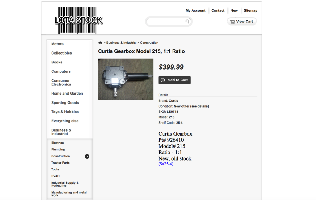

wallfish 19,344 #17 Posted December 6, 2017 On 12/4/2017 at 5:58 PM, WNYPCRepair said: Now to find a gear box that doesn't change speed. I would guess you might want to reduce the speed for torque consideration depending on what you're drive motor/engine is. That thing in the video is powering through those logs very quick so it's taking some major hp to do it. But, with a 1:1 you can always change the size of the pulleys to gear it however you need to as long as the gearbox can take it. I would go band saw type if building one. All that other stuff seems to complicated to get exactly right and in all that time of building it, you could already be sawing logs. Put the effort into figuring out a quick power way to turn the logs. http://www.surpluscenter.com/Power-Transmission/Gear-Reducers-Gearboxes/Gearboxes/ What's that jug on top do? Water for cooling? 1 Share this post Link to post Share on other sites
