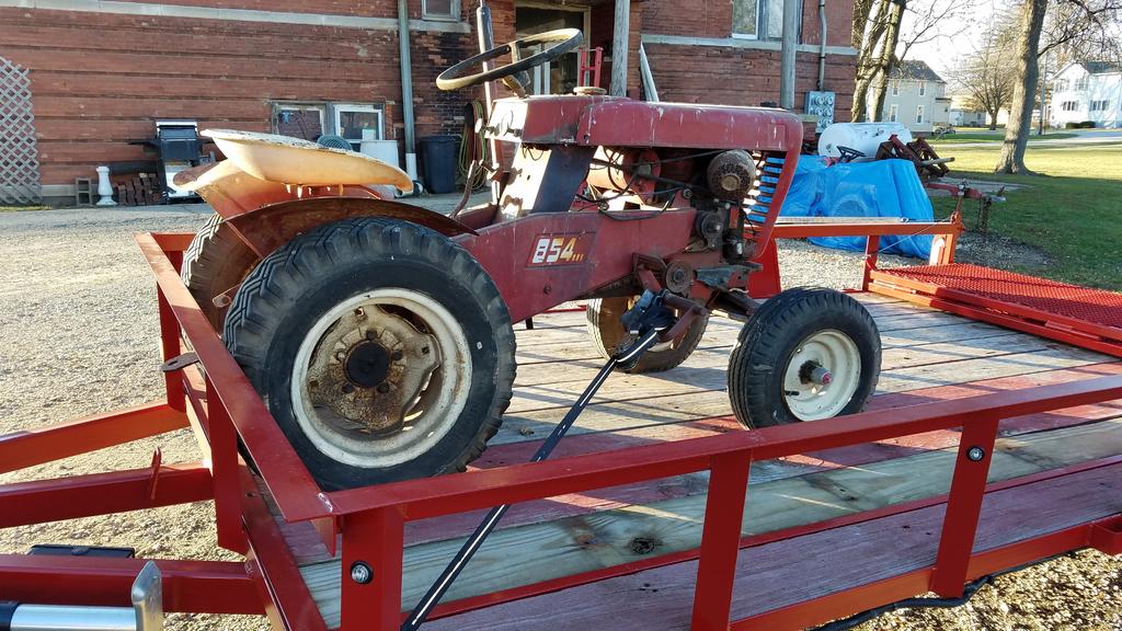

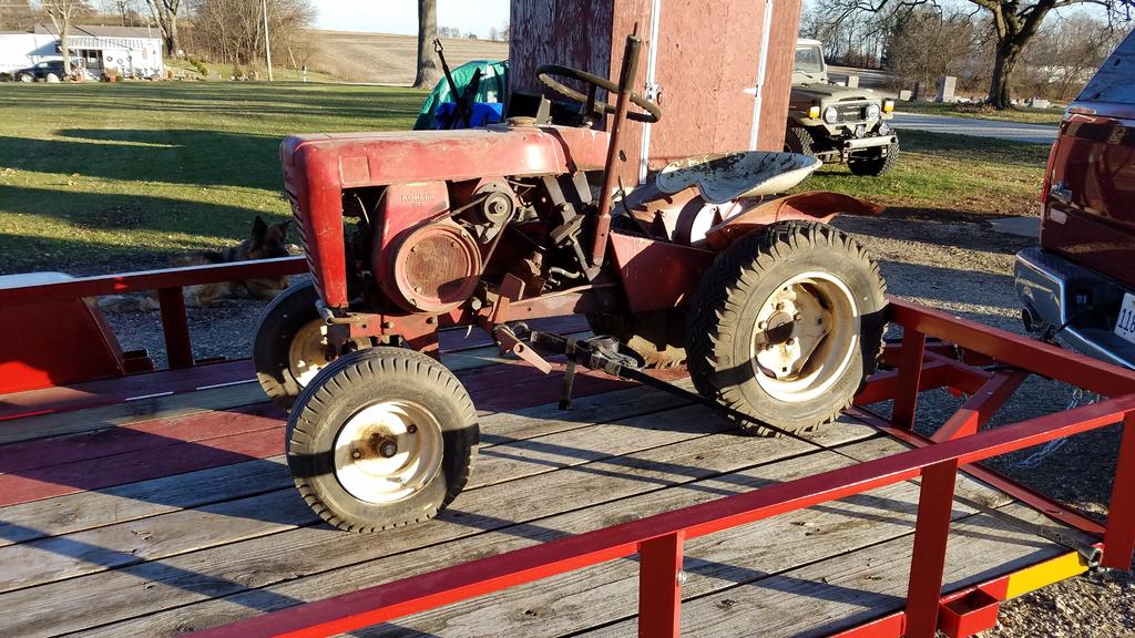

Sarge 3,471 #1 Posted December 2, 2017 Got this one through a buddy - it was slated for the scrap pile . Some other really interesting things out there in the middle of nowhere such as a horizontal mill and an old gear driven/flat belt lathe . Pretty good condition little '64 , hood will need some work but everything is there except the lift cable and brake shoe and the air cleaner is buggered badly . Engine moves fine and has compression yet , glad it was stored inside ... Probably won't even get time to mess with it until spring - we have a major weather shift coming early next week and I'm still fighting to get the D working correctly without puking oil , need that to plow/work with around here . Sarge 11 8 Share this post Link to post Share on other sites
JPWH 6,544 #2 Posted December 2, 2017 That looks to be in real good shape. Nice score. Share this post Link to post Share on other sites

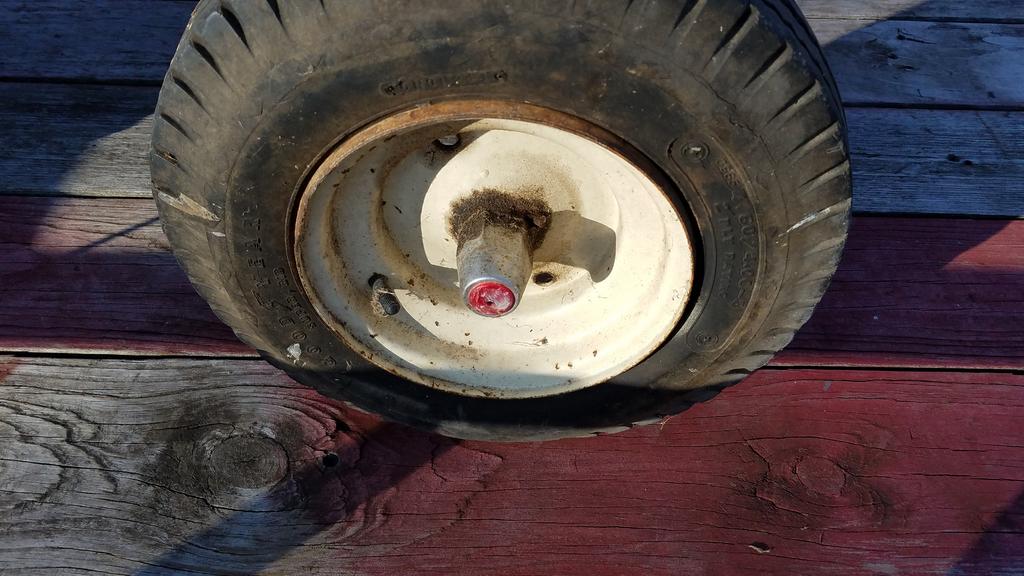

Sarge 3,471 #4 Posted December 2, 2017 What really surprised me was the condition of those Goodrich tires on the rear - very solid shape but of course hard as a rock like they always are - someone really took good care of it . The left front spindle has the craziest end cap on the wheel - I need to check it out closer and see what the heck it really is - about 3.5" long and tapered... Trans feels good , gear detents are nice and crisp so I doubt it's been seriously abused as most . Won't know about the 2-3 cluster until I get it running and under a load - never know about those but at least there are parts out there from Lowell now , such a great resource . I see it does need one axle seal - the hub is against the housing as so many are since the original owners didn't know the importance of checking the set screws occasionally . A little work - I'm sure it will run just fine . Sarge Share this post Link to post Share on other sites

12 hp Kohler 1,020 #8 Posted December 2, 2017 Great find, has a really nice patina. I really like that Toyota fj in the back ground of the second picture as well. Share this post Link to post Share on other sites
Digger 66 3,528 #9 Posted December 2, 2017 5 hours ago, Sarge said: Love the marker lights on the trailer ! Share this post Link to post Share on other sites
elcamino/wheelhorse 9,363 #10 Posted December 2, 2017 That is a nice score. From the pictures it looks it good shape. Share this post Link to post Share on other sites

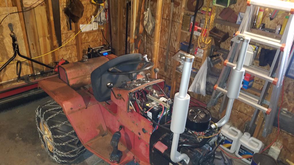

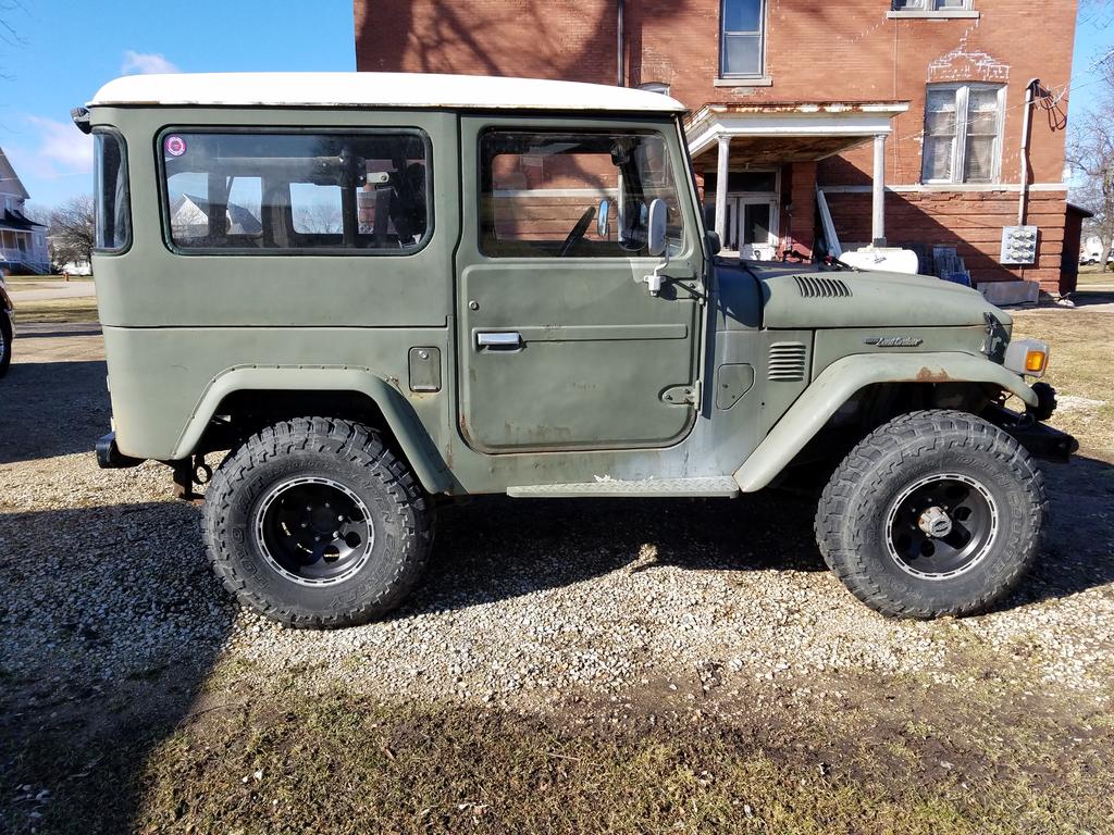

Sarge 3,471 #12 Posted December 3, 2017 Took a minute yesterday and gave it another look-see , the right front wheel has an odd cap - Turns out to be an aftermarket lug nut cover for a semi - complete with a reflector , no less . Doesn't fit the hub all that well , but guess it does the job as the bearings/grease are clean . Went back to the big shed and spent the Saturday doing this , again - So far , no leaks on the pump . More to follow in the Big Ugly thread... The old FJ40 is going soon , it's just sitting most of the time and rotting in the weather - I can't stand to watch that and will let it go to someone that will restore it as it's a '77 and in excellent running condition with the original engine . That's the only other thing that will put a smile on my face to drive other than the Horses - but it beats me to death and my joints can't take the punishment anymore . The marker lights on the trailer work really well and I like their small profile - they light up a lot better than you'd expect and many of the haulers around here are going that route with their semi's . I'll have to get a night pic sometime... Sarge 2 Share this post Link to post Share on other sites
RandyLittrell 3,944 #13 Posted December 3, 2017 Nice find! I feel for you Sarge, I have arthritis bad myself. Not as bad as you though, if you have to get rid of your FJ! Hope it goes to a good home, I would love to have an FJ 45 or an old landcruiser. Randy Share this post Link to post Share on other sites
chip61 666 #14 Posted December 4, 2017 Great vehicle, that will make a nice toy for someone. Share this post Link to post Share on other sites
JERSEYHAWG / Glenn 4,574 #15 Posted December 4, 2017 You couldnt beat those old landcruisers, my buddy had one back in 1972 or 3. Boy that thing was sweet. I remember the two little fold down seats in back. If I was closer I would be right over. Lol Glenn Share this post Link to post Share on other sites
Sarge 3,471 #16 Posted December 4, 2017 The truck is only half the equation - you should see the room stuffed with parts . Especially noteworthy are the correct rear van doors in excellent , rust free condition , a spare set of great front doors and a slew of other parts for it - many of which are NLA and some of it is really rare straight from Japan . To this date , the Land Cruiser is still one of the toughest vehicles ever built - they didn't wear out , they just wore out their owners and that's not a joke . There is nothing on it that cannot be rebuilt and it is all detailed in the service manuals . I mean , even stuff like the vacuum brake booster , fan clutch , steering box (highly detailed in the book) and water pump just as an example . They built them to be field serviced and survive in 3rd world countries for a lifetime - it's nothing to drag out the oldest examples and put a day's work in changing fluids - then fire it up and drive it . 9.5" ring gear size in the diffs and 31 spline axles - stock . The axles are heavier than the Dana 44's easily and weigh more as well . Built more like a commercial truck (complete with a double c-channel frame) than anything - and actually tougher for it's size . My dream was always a 45/47 long wheel base Troop Carrier , or Troopy . Collectors have driven prices to insane levels - it's nothing to see them auction off at over $100,000 for great restored examples . We have a guy in France now that can build full tubs out of aluminum , brass or even stainless steel - his work is amazing and he ships world wide . Mine was around $6500 in 1977 new - first year for front disk brakes and the rear axle uses dual wheel cylinders on each side like a commercial truck . Seating was designed for 4-6 passengers and weighs around 4,200lbs - engine is 850lbs alone being an industrial straight six - one look inside of it and you'd think it was a diesel . Despite it's age and pulling those 33x10.5x15 mud terrain tires it can still run 80mph - although it's not exactly happy at that speed and will induce a lot of white-knuckle feeling to the driver , I used to drive it to work a lot on the Interstate and 70mph sure woke you up fast early in the morning . Aside from the manual steering it drives exceptionally well for what it is and built like a tank - anyone opening a car door into it is going to need a new door and really irritate their body guy....while barely even scratching the paint on The AntiChrist , as I call it ... Spent a short time last night looking over the 854 some more and even rode it off the trailer down the ramp . Steering is amazingly tight , as well as the spindles and associated parts - almost like it has very little hours on it or someone really loved and cared for it . Trying to get some history on the thing as I'm curious as to why so much of it's parts are like new . Hood bolts/nuts are gone as well as the shift knob and it will need a new key switch - which I have here . Engine has great compression and the belts even look good . Someone put a strip of leather inside the brake band and the throttle cable stand off bracket is gone with some plumber's strapping taking it's place . Steering wheel is even in great condition yet and the dash bushing is pretty tight yet . Fuel tank is clean as a whistle inside and the fuel cap is in nice shape - even the gasket is great condition . It was last sitting in a machine shed but prior to that it had to have been stored inside and greased regularly for the condition of it's parts . Shifter boot was missing as usual but I already put a new one on it . Wish the weather was better - I'd like to at least go through a few things and put a fire in it to see the engine's condition but it will have to wait until spring . Sarge 5 Share this post Link to post Share on other sites
