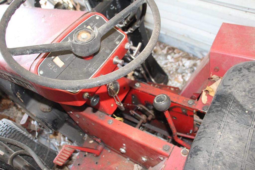

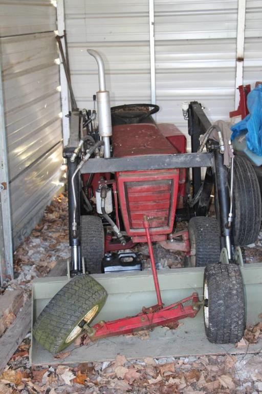

Big_Red_Fred 1,548 #4 Posted November 23, 2017 5 minutes ago, 953 nut said: When they left the factory they had a Hudrogear transaxle but some owners have put 8 speeds in them. @Aldon is doing a thread on one now. The plate is gone where shift knob & shifter is sticking up, what caught my eye was the FEL Richard, 1100 or OBO, you wanna see it, The Man Passed away 2 years ago, his wife is selling it, i saw it on Zanesville Ohio Clist, but its in Marengo Ohio Clist, Check it out, let me know what to offer, Thanks for info 2 Share this post Link to post Share on other sites

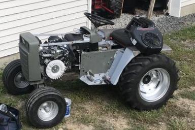

PeacemakerJack 10,917 #5 Posted November 23, 2017 The only one I’m aware of is this one... if you can get your hands on this one, buy it!it’s a top notch build! 4 1 2 Share this post Link to post Share on other sites

PeacemakerJack 10,917 #7 Posted November 23, 2017 Sure looks like a GD tranny in a GT-14 to me... massive modifications on this tractor... So, you’d have to study over how well everything thing was built and modified. And decide what it is worth to you. That FEL seems worth the price of admission. 4 Share this post Link to post Share on other sites
953 nut 65,106 #8 Posted November 23, 2017 Looks like the owner did away with the lift cylinder for a deck or three point although that could be added and driven from the FEL pump. If it was running and operational I would think it would be worth $ 1,800 +/- so with a couple of bad tires and non-running I wouldn't be shy about offering $ 750 or $800. Cost more than that to build the loader. One big plus for the 8 speed in place of the Sundstrand is you will have mechanical brakes. 3 Share this post Link to post Share on other sites
Big_Red_Fred 1,548 #9 Posted November 23, 2017 16 minutes ago, PeacemakerJack said: Sure looks like a GD tranny in a GT-14 to me... massive modifications on this tractor... So, you’d have to study over how well everything thing was built and modified. And decide what it is worth to you. That FEL seems worth the price of admission. Look at the front Pic, left rear where fender is, Is that a fuel tank on fender ? or just worn out eyes LOL Share this post Link to post Share on other sites
Big_Red_Fred 1,548 #10 Posted November 23, 2017 28 minutes ago, PeacemakerJack said: Sure looks like a GD tranny in a GT-14 to me... massive modifications on this tractor... So, you’d have to study over how well everything thing was built and modified. And decide what it is worth to you. That FEL seems worth the price of admission. I will send them a Offer, Thanks, the Frontend looks more Narrow, wouldnt wider be better ? Share this post Link to post Share on other sites
Aldon 4,832 #11 Posted November 23, 2017 Tank looks like a reservoir for Hydraulics...if I’m looking at it right. definitley modified and converted to 8 speed. i was not first to do this Mod. there is a nice loader GT14 in the barn at the big show that was converted way back to manual tranny. But most if not all used manual trannies that were narrower than the hydro tranny. In my build i split the tranny and located longer axles thereby hereby widening the rear. i too ended up sacrificing the rock shaft for deck lift and 3 point. If if I finish the build it will have an independent 3 point on rear with dedicated cylinder. I am considering selling out so if someone wants to grab my GT22-8 project and has the financial resources, send me a PM. PS, my build is designed to eventually have a loader. Hence gear reduction steering. That is what Really caused me to lose the deck lift. 3 Share this post Link to post Share on other sites

Sparky-(Admin) 24,975 #24 Posted November 23, 2017 Everyone is calling this GT-14 an 8 speed conversion....but I'm only seeing the gear shifter and the not the hi/low lever. Could this be just a 4 speed swap, like a tranny from a B-80? 1 Share this post Link to post Share on other sites
