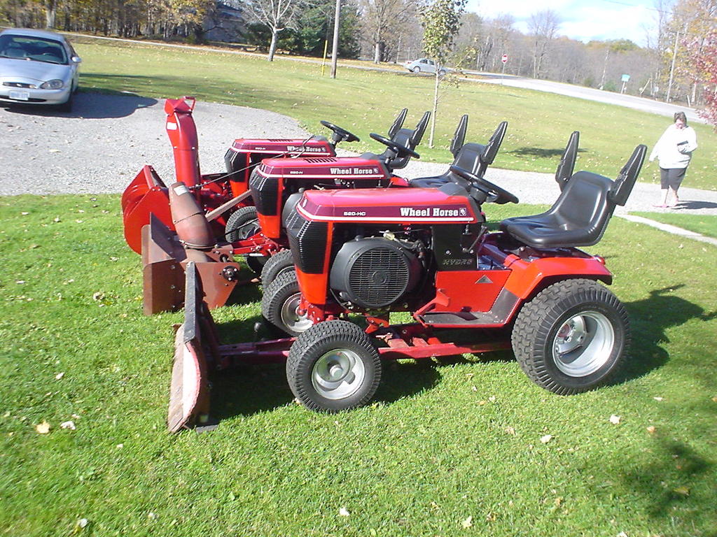

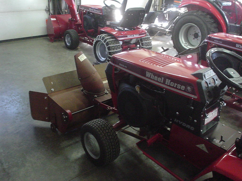

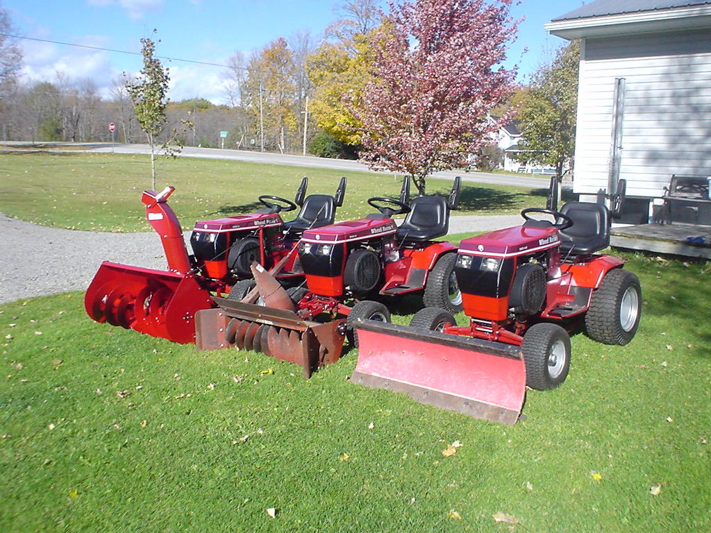

WVHillbilly520H 10,378 #3 Posted November 23, 2017 Which style do you have? One has "built" in chute crank other has mid attach-a-matic chute crank support other than that pretty much similar hook up, Jeff. 1 Share this post Link to post Share on other sites
entropy 104 #4 Posted November 24, 2017 Thanks for the replies. The thrower I have is very similar to the one that is closest in your pic WV. The chute is shorter and it has metal wheels instead of the sliders. I have owned the 520 for a few years now and did not want to start removing the deck and front end thing without an idea of what it should look like first. Would it be possible for you to post some close up pics of the setup from each side? It is 5am right now so I will try and post pics of thrower and tractor a bit later this AM....... Share this post Link to post Share on other sites

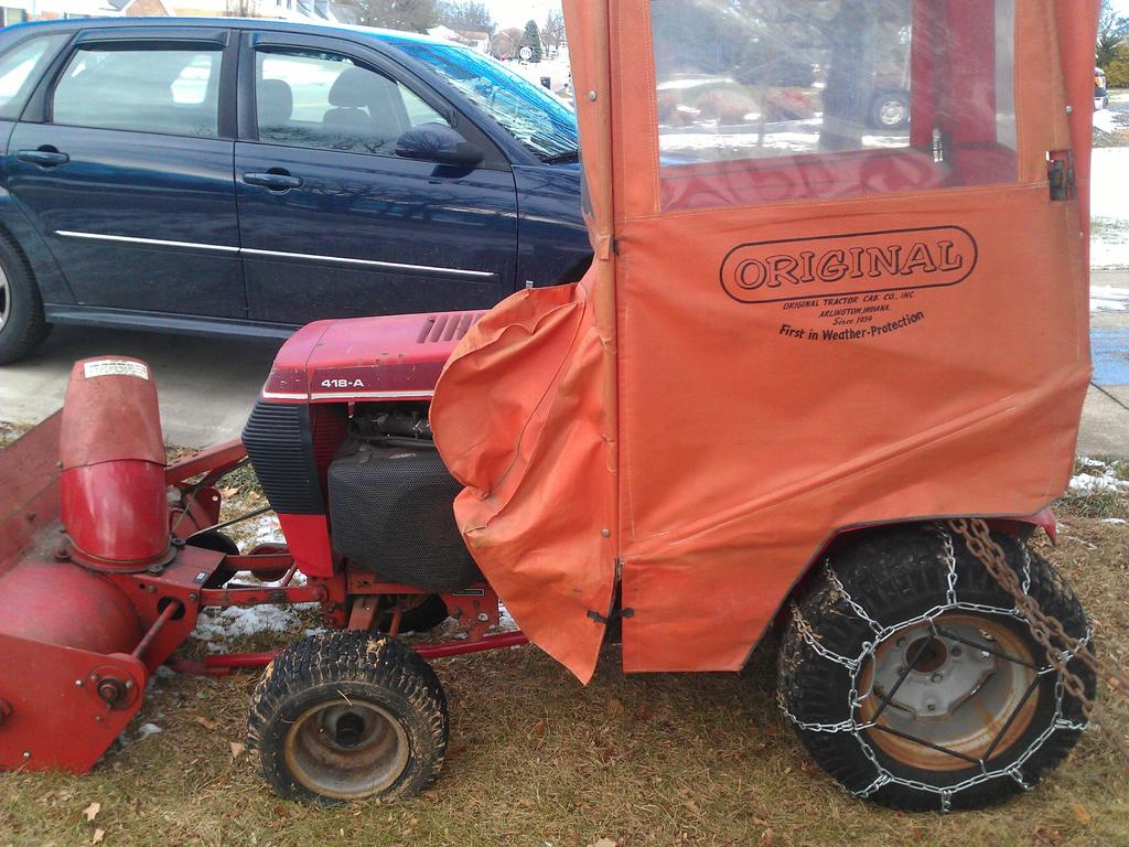

cleat 8,985 #7 Posted November 24, 2017 I had an old style blower like your mounted on a 520. I guess that I was lucky in that it fit right into the front hitch. It worked OK, not as well as the larger 2 stage. This 520 has the straight front axle but I believe it will fit your HC with the forward swept axle as well. 1 Share this post Link to post Share on other sites
WVHillbilly520H 10,378 #8 Posted November 24, 2017 (edited) 3 hours ago, entropy said: Thanks for the replies. The thrower I have is very similar to the one that is closest in your pic WV. The chute is shorter and it has metal wheels instead of the sliders. I have owned the 520 for a few years now and did not want to start removing the deck and front end thing without an idea of what it should look like first. Would it be possible for you to post some close up pics of the setup from each side? It is 5am right now so I will try and post pics of thrower and tractor a bit later this AM....... Only side pic I have as I bought it only for cab and flipped the 418 and blower years ago, check out @Mastiffman his snow thrower restore thread he has a similar thrower he restored and mounted on a 520H , Jeff. Edited November 24, 2017 by WVHillbilly520H 2 Share this post Link to post Share on other sites
squonk 46,729 #9 Posted November 24, 2017 4 hours ago, cleat said: I had an old style blower like your mounted on a 520. I guess that I was lucky in that it fit right into the front hitch. It worked OK, not as well as the larger 2 stage. This 520 has the straight front axle but I believe it will fit your HC with the forward swept axle as well. I guess I stand corrected, but isn’t that cross bar a smallish diameter than the newer version and will slop around in the hitch? Share this post Link to post Share on other sites
cleat 8,985 #10 Posted November 24, 2017 Same size. I also had a tall chute blower and the hookup was identical. The short chute blower I had was originally for a C160 that has the same front hitch. Cleat Share this post Link to post Share on other sites

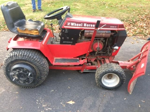

entropy 104 #11 Posted November 24, 2017 I may try to mount it on my 518 that I picked up last year. I was not that impressed with the plow anyway. I do not think I ran it enough to even break in the rebuild as the plow was less effective then my walk behind thrower. 1 Share this post Link to post Share on other sites
