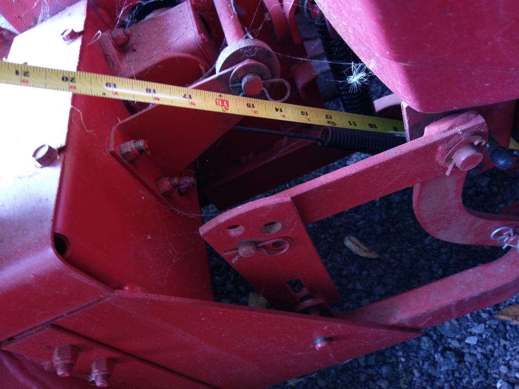

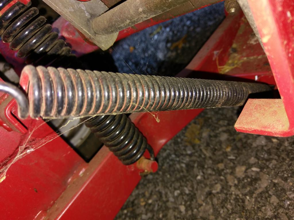

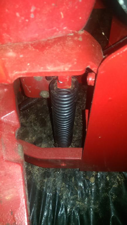

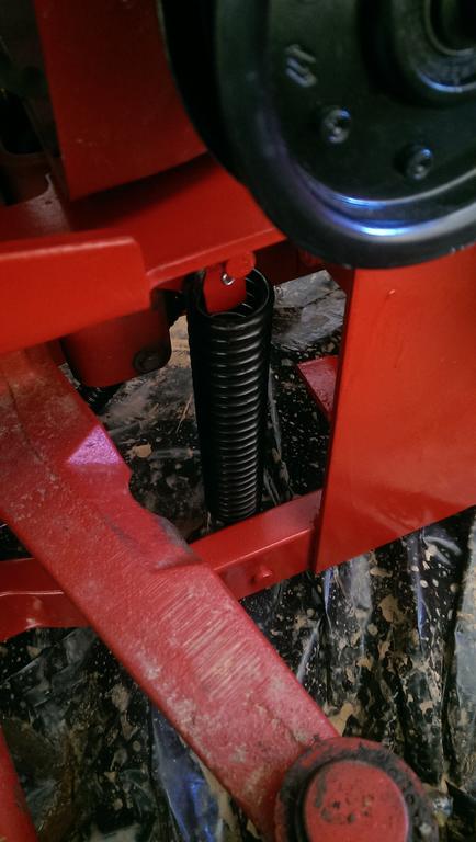

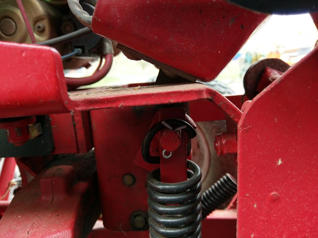

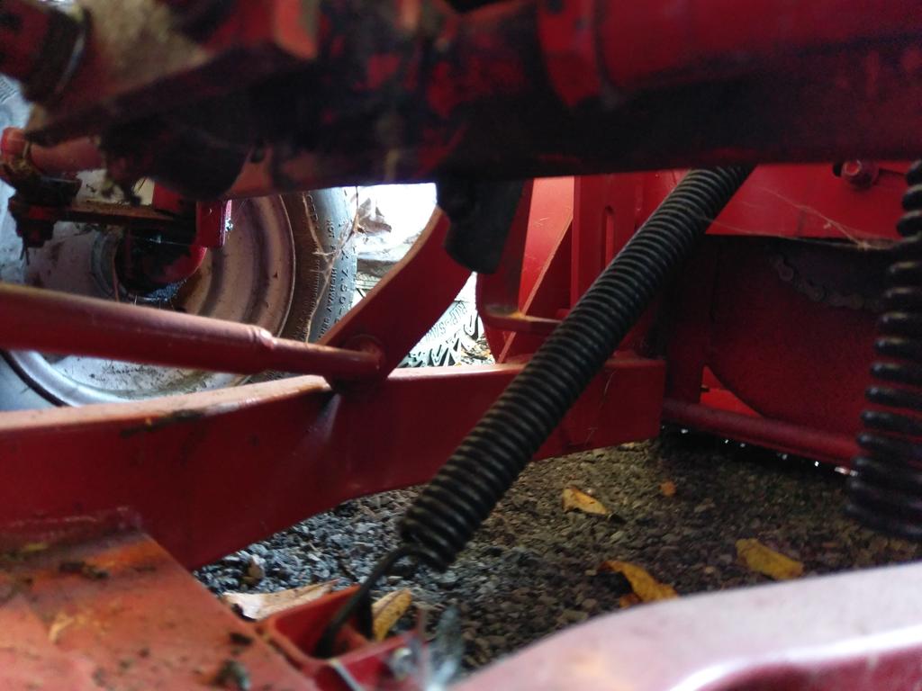

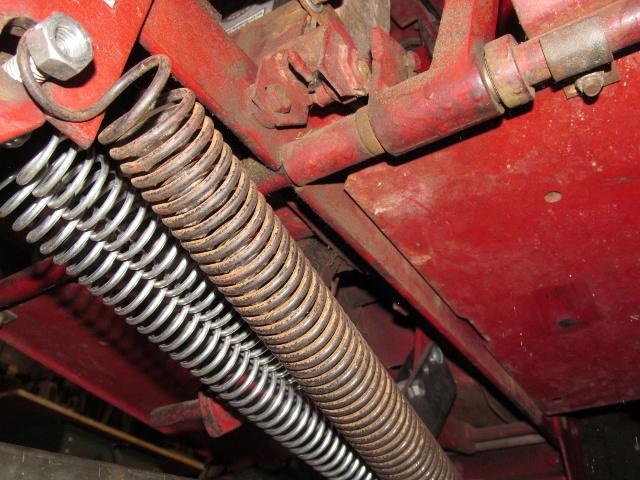

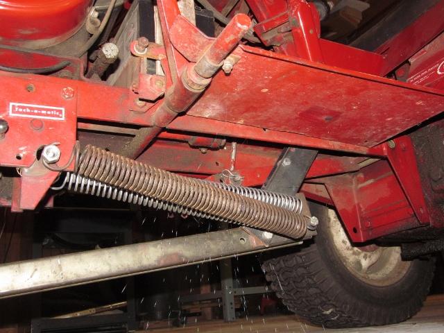

WVHillbilly520H 10,378 #4 Posted November 23, 2017 The 2stage I have now PO ran on a 314-8 then 315-8 with manual lift, and the 1 I let get away was on a C160 manual lift and both guys said it wasn't that bad with the assist spring (biggest spring in pics), also if you search, there's a member on here with video of 2stage on a manual and he's not straining to lift it, it also has a compound lift linkage which I believe takes less effort than the single rod in the single stage thrower, Jeff. 6 Share this post Link to post Share on other sites

SPINJIM 1,996 #6 Posted November 23, 2017 1 hour ago, WVHillbilly520H said: The 2stage I have now PO ran on a 314-8 then 315-8 with manual lift, and the 1 I let get away was on a C160 manual lift and both guys said it wasn't that bad with the assist spring (biggest spring in pics), Thanks Jeff for the pics. That larger spring in your pictures is much heavier than the one that came with my blower. Maybe that's why the P O sold it. It doesn't look like the same length spring that would be used with the single-stage. Could you please measure the length of that heavy spring for me ? I can't seem to find a part number for it in the Manual. Thanks again, Jim Share this post Link to post Share on other sites
rjg854 12,860 #7 Posted November 23, 2017 Check out Glenn Petitt, a vendor here that sells the spring you're looking for. I've gotten them from him, that's what you want. Share this post Link to post Share on other sites
WVHillbilly520H 10,378 #8 Posted November 23, 2017 10 hours ago, SPINJIM said: Thanks Jeff for the pics. That larger spring in your pictures is much heavier than the one that came with my blower. Maybe that's why the P O sold it. It doesn't look like the same length spring that would be used with the single-stage. Could you please measure the length of that heavy spring for me ? I can't seem to find a part number for it in the Manual. Thanks again, Jim OK Jim the longer spring is for the idler pulley, then the helper is the larger/wider spring that goes on the right side is the same as the tiller/single stage spring. 1 Share this post Link to post Share on other sites

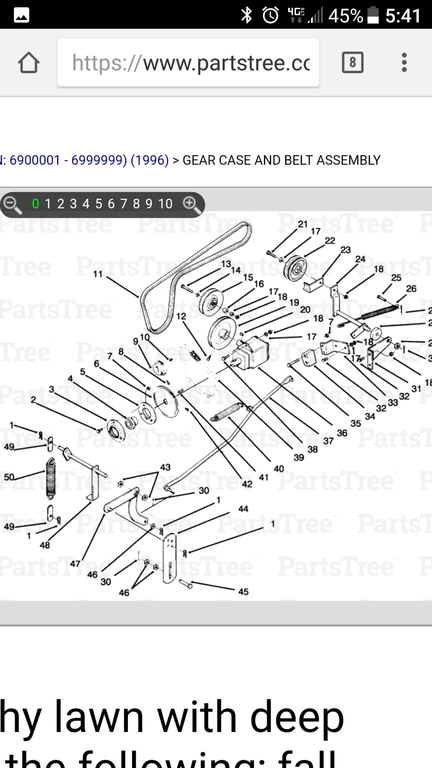

WVHillbilly520H 10,378 #11 Posted November 25, 2017 (edited) The springs are different here's the exploded view, and NLA, the big one that goes up front can be had from @wheelhorseman, I'm sure if we had the measurements Toro part # 110614 ,#40 in the diagram, one could be procured from TSC for the lift arm, Jeff. Edited November 26, 2017 by WVHillbilly520H 1 Share this post Link to post Share on other sites
