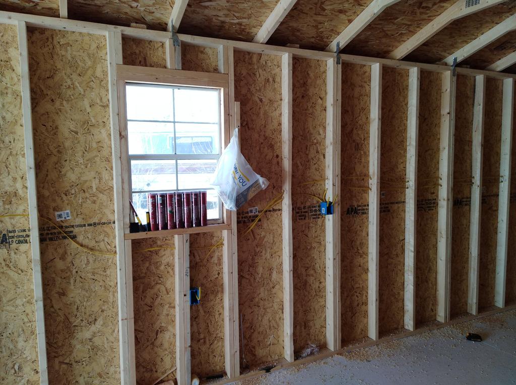

JPWH 6,544 #27 Posted November 25, 2017 Looking good. If you know where your work bench is going to be a couple of quad outlets would be a nice convience. 1 Share this post Link to post Share on other sites

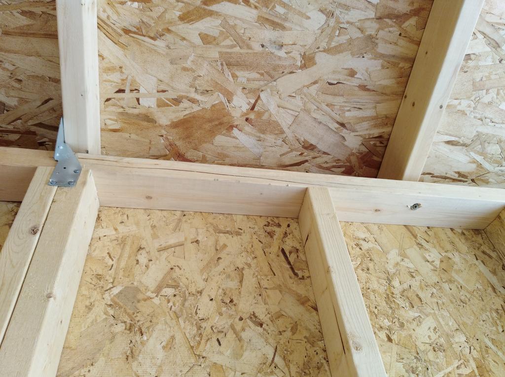

WNYPCRepair 1,924 #28 Posted November 25, 2017 On 11/23/2017 at 5:50 PM, Professor1990 said: I've looked at several of these buildings before purchasing this one, and every one of them had the double studs at the joints not sure what their reasoning behind it is My bet is it is made in a factory. They make up a ton of 4' x 8' panels, and slap together however many are needed to make a shed, garage, etc. It seems to me it would be easier to put them together with the second top plate, but that would add a few bucks cost. I noticed the trusses too. I suppose they would be strong enoug, but it is a strange way to do it, just to gain a little head room 1 Share this post Link to post Share on other sites

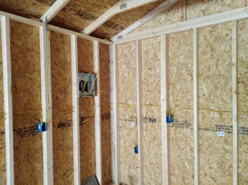

ClassicTractorProfessor 5,455 #29 Posted November 25, 2017 4 hours ago, ebinmaine said: I love the fact that you put up the sign before most other work. Priorities !!!! Yes...a man has to have his priorities straight...That was the first thing I did yesterday before anything else 6 hours ago, Digger 66 said: You can never have enough outlets ^^^^ Very wise decision to install plenty of them . When I was helping my dad build his 24 X 24 garage as a teenager , I wondered why he had +/- 25 outlets installed . I soon found out ...... I don't see one high enough to plug a clock into though ???? Yes a man can never have too many outlets...that's a good idea...Just came back from the lumber yard with another box and outlet specifically for that purpose. I will try to make a short video later today to give everyone a better idea of what my plans are...And good ideas/suggestions are always welcome Share this post Link to post Share on other sites

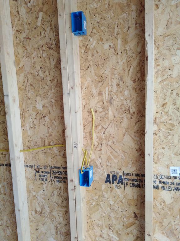

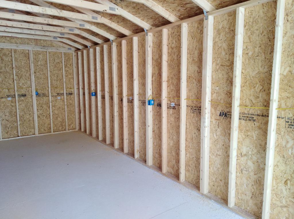

ClassicTractorProfessor 5,455 #32 Posted November 25, 2017 Got all my wire ran but one short piece...had exactly enough to finish until I added the final outlet closer to the ceiling...came up just a bit short...oh well gonna have to buy another roll when I decide what to do with my lights so no big deal 3 Share this post Link to post Share on other sites

EricF 589 #38 Posted November 26, 2017 On 11/23/2017 at 3:49 PM, Professor1990 said: A better picture of how they are fastened...I thought it was weird too...but have never saw a building like this that was built with a double top plate...a friend of mine who built houses for over 50 years looked it over and he thought it was weird but didn't see any problems with the way it was built I'm building a 10x20 shed that uses a similar roof truss setup. It's a pre-cut lumber kit; there are some differences though. The top plate is doubled, and every truss connects with a hurricane tie that connects to both sides of the rafter, not just one. The side of the hurricane tie that nails to the top plate is nailed to both the top and bottom members of the doubled top plate. In all, each rafter is attached with seven purpose-specific hanger nails -- four into the rafter (two each side) and three into the top plate. Its a similar approach, but more robust -- they definitely aren't going anywhere. Driving the nails in with a hammer is doable, but a bit of a pain -- it's a lot easier to use an air-powered palm nailer, which is what I did. Strap-style hangers like those in the picture are easier to get at with a conventional nail gun -- probably more popular for prefab, assembly-line construction. I'd rather see straps on every rafter, not the screws on the odd ones. You could add a 2x4 block in each stud bay, which would give enough purchase to add a strap to the screwed-in rafters. Either way, once the OSB decking is on, the whole roof behaves more or less as a very stiff unit. The straps are remarkably good at handling wind loads. Snow loading is another matter, although OSB itself plays a big part in the roof strength. It's surprisingly strong and rigid compared to traditional plywood, which has allowed for more deviations from old standby construction methods. 1 Share this post Link to post Share on other sites
