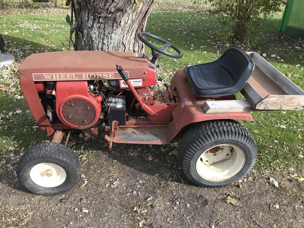

Chris1055 106 #1 Posted November 18, 2017 I was looking for a 16 hp motor for snowblowing this winter. Went to get the motor and asked him if he had the tractor it came off of. He said he did. He was going to scrap it but would throw it it if I wanted it. Looks to be in pretty good shape. I'd radther have one like this than one painted three times lol. I'm going to use it like this for the winter just get everything mechanically right. 12 2 Share this post Link to post Share on other sites

Ed Kennell 46,225 #5 Posted November 18, 2017 Great find and save. Keep us posted with progress. I've seen a lot of snow blower side extension wings on up side down, but a seat back, now that's a first. 1 3 Share this post Link to post Share on other sites
Chris1055 106 #6 Posted November 18, 2017 He model is 1-0380-9 year? Share this post Link to post Share on other sites
Ed Kennell 46,225 #7 Posted November 18, 2017 1974 1 Share this post Link to post Share on other sites
Pollack Pete 2,273 #8 Posted November 18, 2017 Why did he pull the engine off a perfectly good C-160?I'm sure he could have gotten more for a complete running tractor rather than just a 16 horse Kohler?? Share this post Link to post Share on other sites
Chris1055 106 #9 Posted November 18, 2017 (edited) He puts 16 hp kohlers in sears suburbans so when finds a tractor with a k341 takes the motor and junks the rest but his father likes wheel horse so i don't know. Edited November 18, 2017 by Chris1055 1 Share this post Link to post Share on other sites

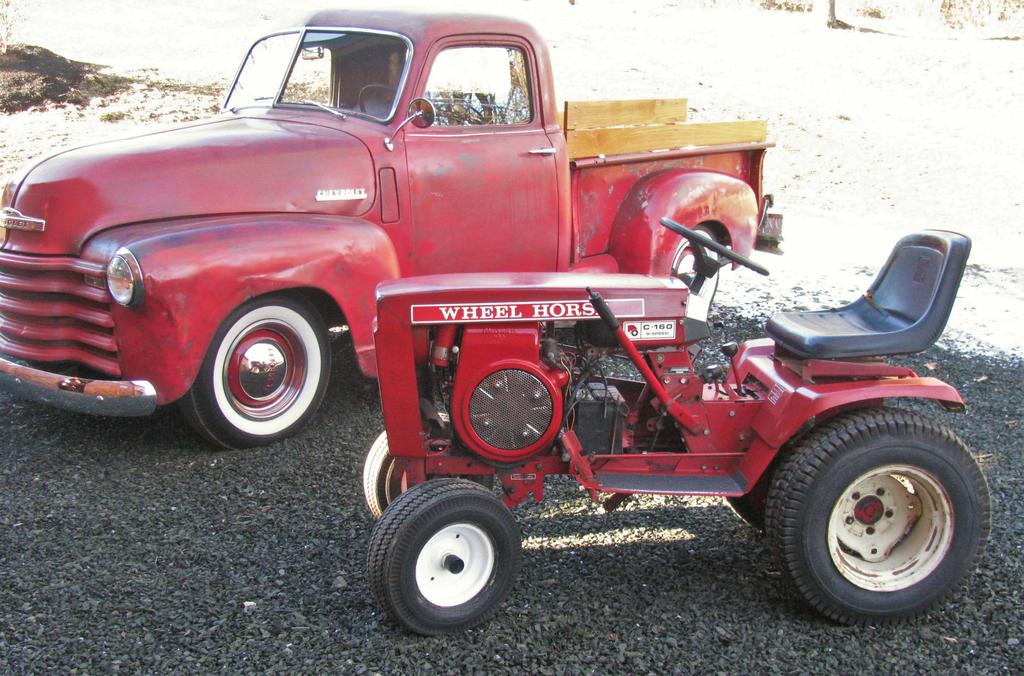

Lane Ranger 11,980 #16 Posted November 19, 2017 This is a C160 I saved! Bought for $125 and runs like a locomotive! 3 1 Share this post Link to post Share on other sites
Chris1055 106 #17 Posted November 19, 2017 Nice I hate seeing these junked ! Share this post Link to post Share on other sites
