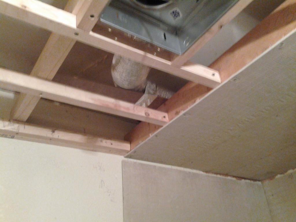

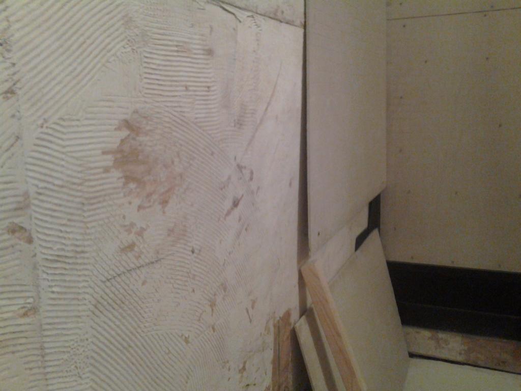

19richie66 17,932 #28 Posted November 22, 2017 No it started as a "lets replace the vanity. You know we also need a new tub". Bought a tub. Couldn't get it in without destroying the wall. Ended up replacing the bathroom and the closet doors with wider ones. Still no tub going in without taking out studs. So sell the tub we bought and then decided on a closet and walkin shower. So more drywall, concrete board. Then had to wait to get the shower floor poured. Ran out of floor tile and lowes quit carrying it. Found a place in St. Augustine that ordered it for me but had to drive 2 hours to get it. Made a weekend getaway out of it. So now I'm at the point where I need wall tile and the guy fudged my order. No tile till after 12-12-17 so I have a couple more weeks to finish working in the yard. Yes I am slow but I like to do it right. Don't want to have to do it over. No rushing it. Thats it in a short story. 4 Share this post Link to post Share on other sites

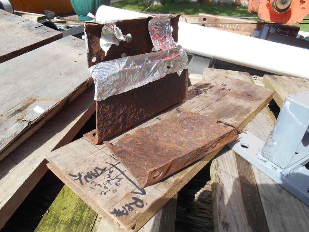

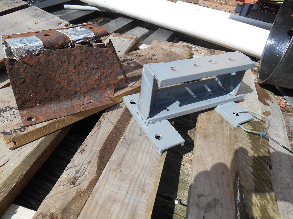

ohiofarmer 3,474 #36 Posted November 24, 2017 This is one I did a while back. My one ton Dodge driveshaft was hanging by a thread. The carrier bearing was available aftemarket ,but the bracket/carrier bearing comes as a group from Chrysler. two hunert fifty---i don.t think so. I made my own I had to tape the original together to size the new one, but the new one is built out of something much heavier than the beer can crap of the originals 3 Share this post Link to post Share on other sites

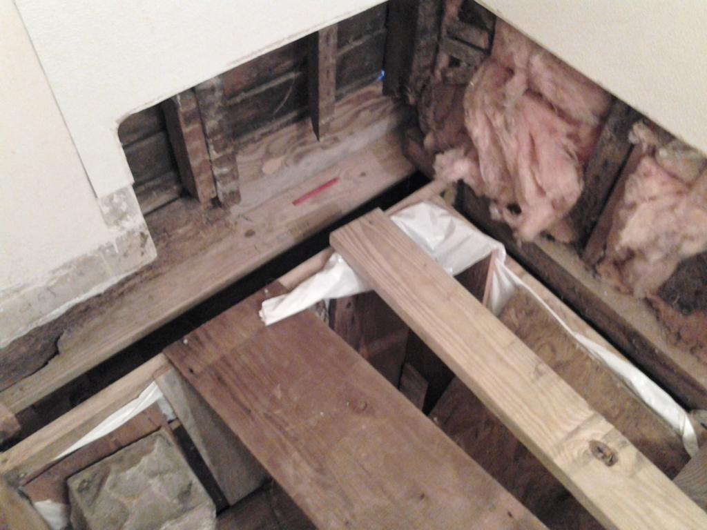

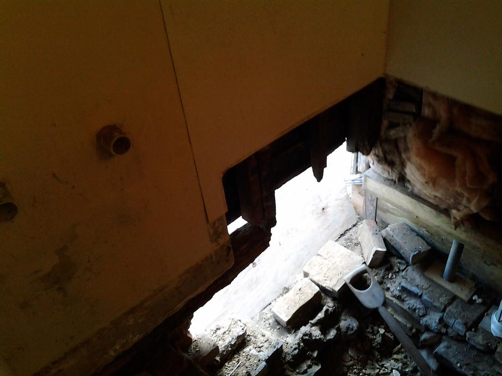

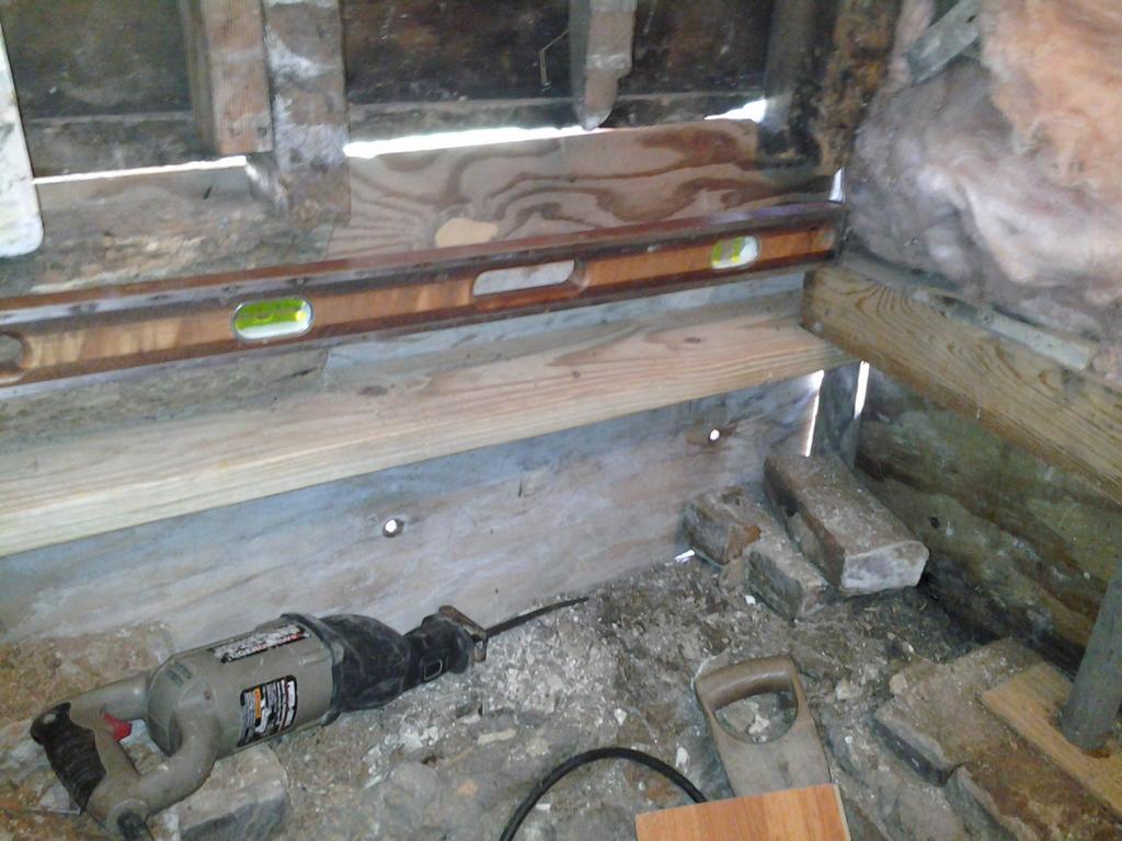

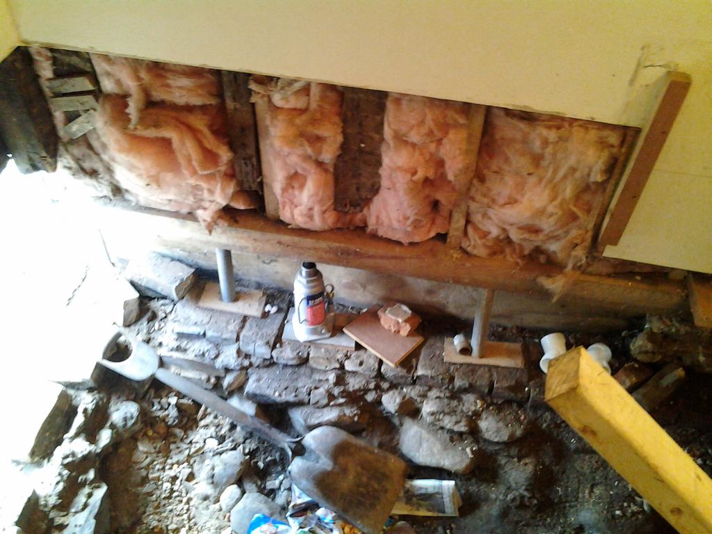

ohiofarmer 3,474 #37 Posted November 24, 2017 (edited) Here is the bathroom project from Satan's hideout It needed everything--from foundation and replacing bottom plates to every building trade there is It makes me tired to think about it now. Just recovering after a year of chemo, and I had to mix 35 80 pound bags of concrete in a mixer and carry it up 3 steps and carry it into the house and dump it in the forms.The plates and grade beam were actually formed into the wall, so that turned out OK The key to the project wotking well is the fact that the floor and wall each were suupported seperately and together by the stem wall and that wall was formed in a light weight fashion anticipating a slow pour that took all day. A fast pour would have blown out the forms You can see the planks I had to walk across and pour the concrete into the two inch gap Eventually, the floor frame took shape and was super strong to boot Edited November 24, 2017 by ohiofarmer 3 Share this post Link to post Share on other sites
19richie66 17,932 #38 Posted November 24, 2017 Wow, suddenly my bathroom doesn't seem all that bad a job. And doing it after chemo?...... my hats off to you sir! Hope all is well with you now. 1 1 Share this post Link to post Share on other sites
ebinmaine 80,434 #39 Posted November 24, 2017 1 hour ago, 19richie66 said: And doing it after chemo?...... my hats off to you sir! Hope all is well with you now. Agreed !! @ohiofarmer well done sir. 1 Share this post Link to post Share on other sites

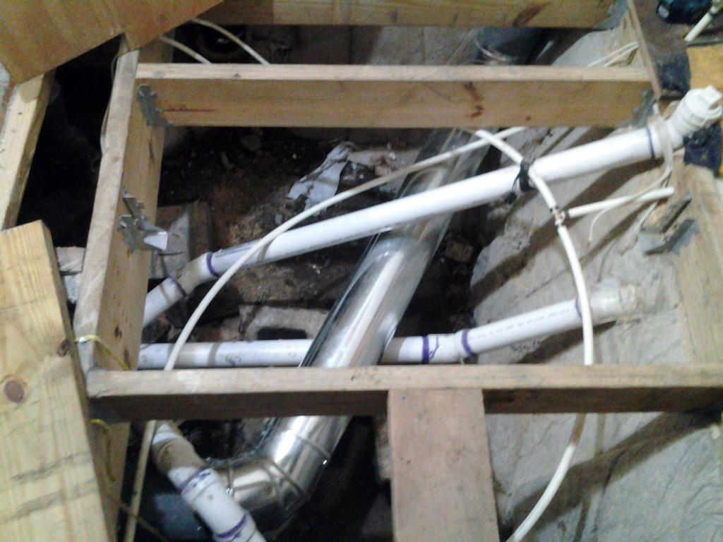

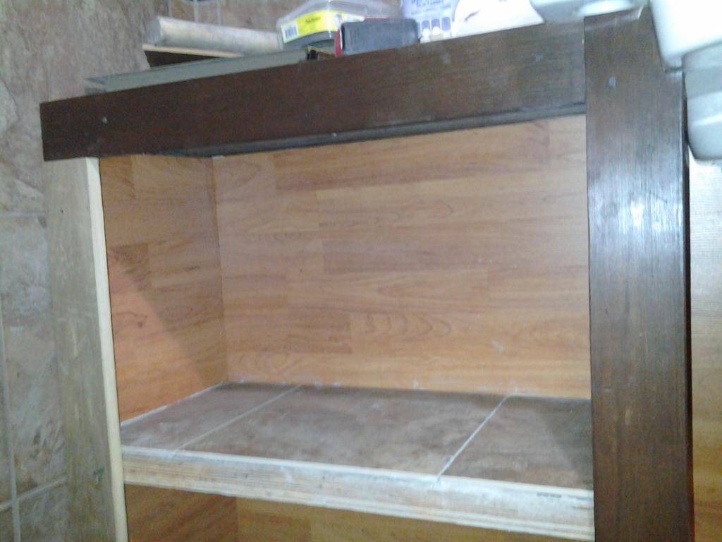

ohiofarmer 3,474 #40 Posted November 26, 2017 Here is the floor system that you never want to have to go beneath. Just too far to crawl in and the other workers left a battlefield of a mess under the house. Note the lower pipe going through the foundation. that pipe is the clean-out and can be accessed from outside. Just stick a garden hose in and it flushes out easily. The floor is solid tile and the shower is concrete and tile. The pedestal sink was a good solution. There is limited room in front of the toilet. so what I did is build a custom banjo shaped vanity/shelf unit. Simple to do as i used click together flooring as a cabinet liner. Fast, easy, and pre finished. The cabinet was built from 100 year old tobacco boxes and I simply scribed and fit the tobacco box material to make doors that fit the bottom curve of the pedestal sink. Lost the pictures of that..All the heat comes from a vent under the vanity and exits vents in the toe kick. Form follows function when you are saving space. Because the building is so old that the walls were not plumb, Laser levels and shimming the walls became a common theme. You can see the gap shimmed behind the tile board in the shower I used the flooring to finish any other areas of the walls not covered in tile [part of the ceiling and upper walls and it turned out nice. this project would have been a disaster if you had to have it done by contractors as the tile, electrical, cabinets and everything had to be done in stages. Guys who id jobs will not work that way and i don't blame them. That is when it is nice to be able to change from tile setter to electrician to cabinetmaker all in one day if necessary. Sorry there are not pictures of everything. BTW surgery was seven years ago and the last chemo was about 5, So we will remain vigilant it does not come back 5 Share this post Link to post Share on other sites
19richie66 17,932 #41 Posted November 26, 2017 Wow what a mine field to crawl through. Glad you are good to go! Share this post Link to post Share on other sites
953 nut 68,699 #42 Posted November 26, 2017 (edited) It is great to be able to change hats (and trades) quickly when needed. Nice job, Volunteering with Habitat for Humanities I have done plumbing repairs in a few crawl spaces like that, sure makes you glad when the job is done knowing you don't have to go back down there. Edited November 26, 2017 by 953 nut fat finger spelling 2 Share this post Link to post Share on other sites

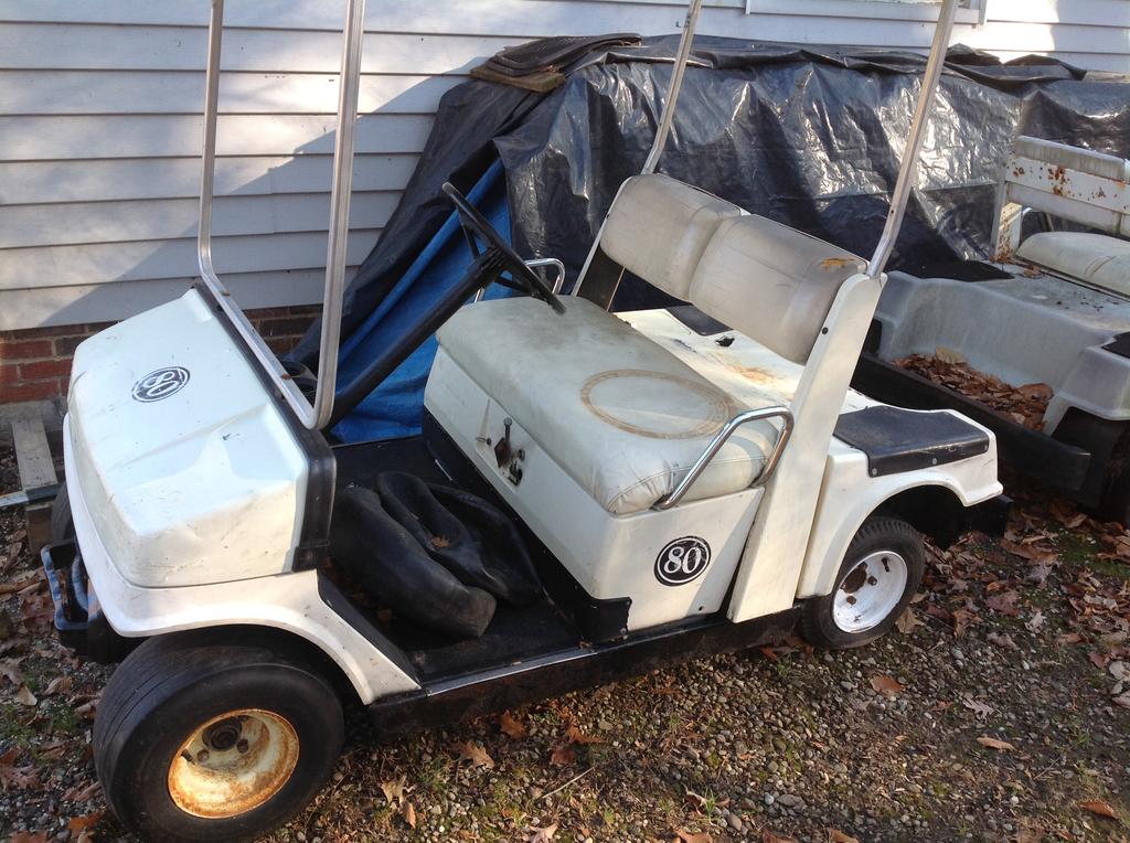

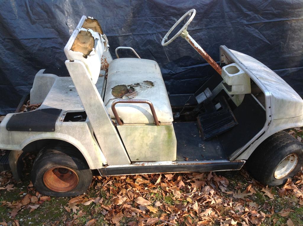

slim67 2,825 #43 Posted November 26, 2017 This is one of my winter projects. It's a G9 Yamaha gas cart that needs a lot of work that I plan on turning into an off roader. I've done several before this but they were in better shape. The electric G2 is just for parts. Carts have gone up in price over the last several years and I have more time than money. Besides this won't be a show cart. 3 Share this post Link to post Share on other sites

ohiofarmer 3,474 #45 Posted November 27, 2017 (edited) 14 hours ago, slim67 said: This is one of my winter projects. It's a G9 Yamaha gas cart that needs a lot of work that I plan on turning into an off roader. I've done several before this but they were in better shape. The electric G2 is just for parts. Carts have gone up in price over the last several years and I have more time than money. Besides this won't be a show cart. There is a guy in my area who does lots of custom carts. He has wheels and mounted tires for a reasonable price. Since you are a fellow Buckeye, maybe you could visit him if you ever get out this way...Of course they are standard tires because he puts traction tires on most of his builds I am going to use those tires along with some hubs from another source to put some rubber on the back of a little 1075 roller and make it into a dedicated spray rig/ yard tractor I hope you can show us some of your builds as it would be very interesting to see them. Edited November 27, 2017 by ohiofarmer Share this post Link to post Share on other sites
slim67 2,825 #46 Posted November 27, 2017 2 hours ago, ohiofarmer said: There is a guy in my area who does lots of custom carts. He has wheels and mounted tires for a reasonable price. Since you are a fellow Buckeye, maybe you could visit him if you ever get out this way...Of course they are standard tires because he puts traction tires on most of his builds I am going to use those tires along with some hubs from another source to put some rubber on the back of a little 1075 roller and make it into a dedicated spray rig/ yard tractor I hope you can show us some of your builds as it would be very interesting to see them. Thank you. I would be happy to show off some of my carts and will show progress on this one also. I plan on a homemade lift of 4 to 6 inches and already have a set of 21x11-8 Goodyear Terra's for it. They are basically the same tires albeit smaller than what's on my B80. Your project sounds interesting as well. Share this post Link to post Share on other sites
