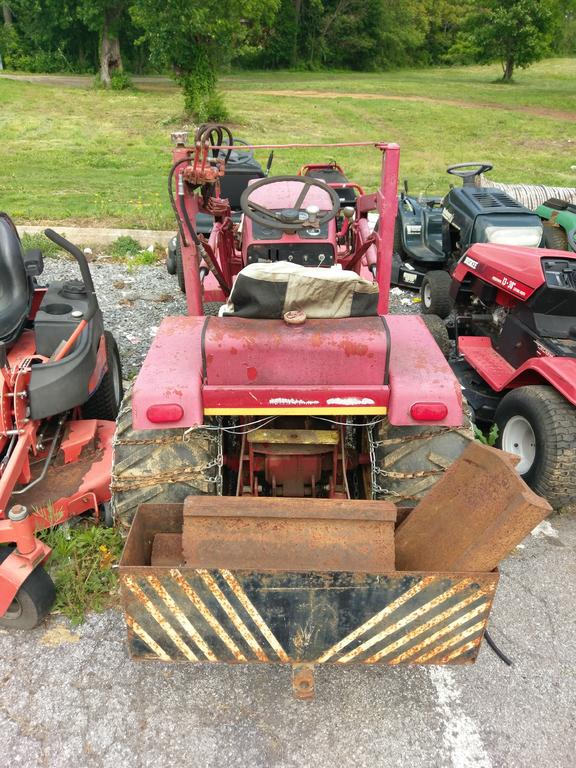

Adams94 1,071 #2 Posted November 12, 2017 Only picture I have right now, I got it last year. It had a John Deere part number on the bottom. Cat 0. I added casters to the bottom to move it easy when it's off. It is full of stone 4 Share this post Link to post Share on other sites
953 nut 69,842 #3 Posted November 12, 2017 Don't have the measurements handy (I'm in Florida right now) but mine was made up of scrap pieces of 3/32" and 1/4" plate I had on hand. Used some 5/8" cold rolled round running through the box for the lower attachment point and angle iron at the top. an old Reese hitch was incorporated to allow me to tow a cart if needed. 9 hours ago, Adams94 said: added casters to the bottom to move it easy when it's off. I like that idea, may have to borrow it. 4 Share this post Link to post Share on other sites
