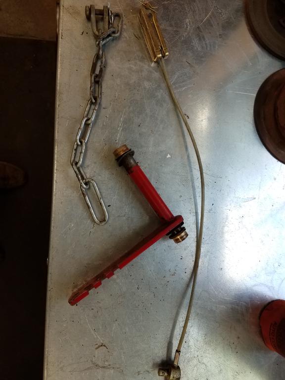

Shynon 7,596 #4 Posted November 7, 2017 Took this one off my 520 1 Share this post Link to post Share on other sites

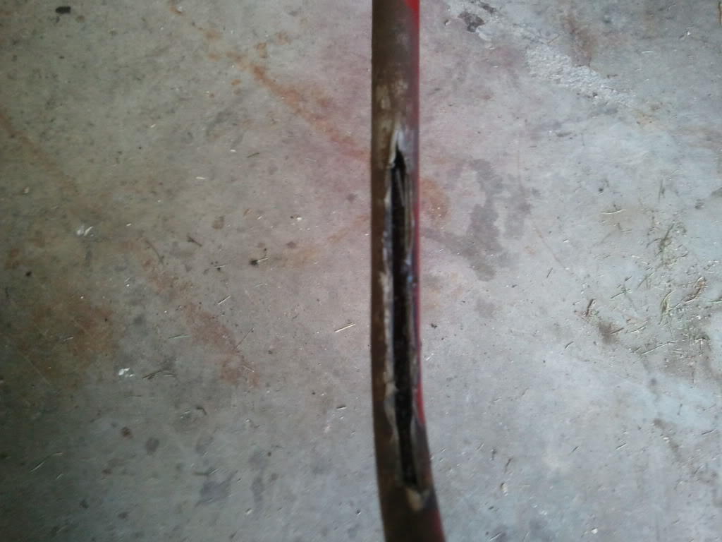

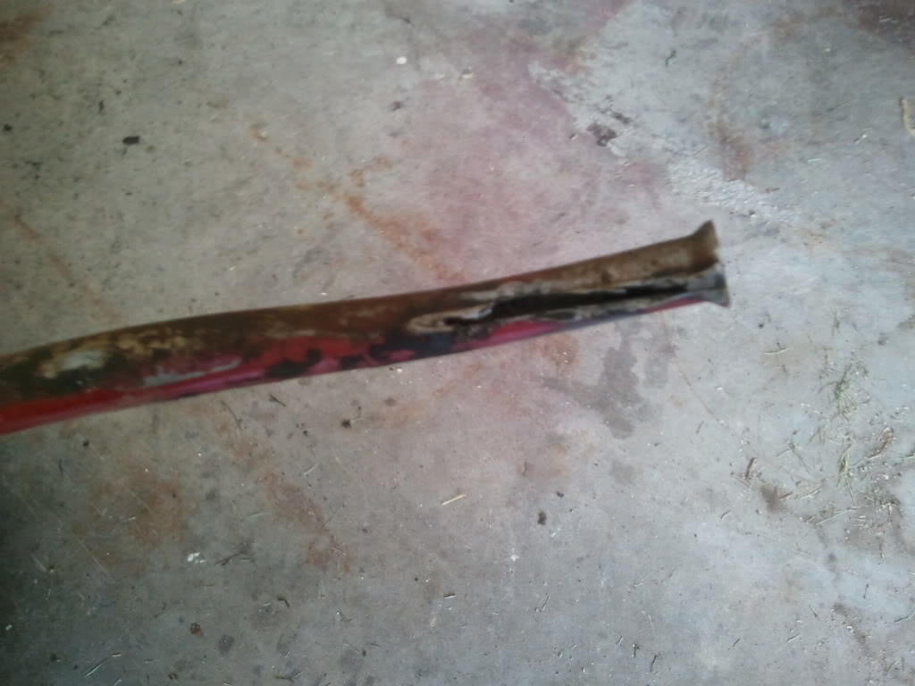

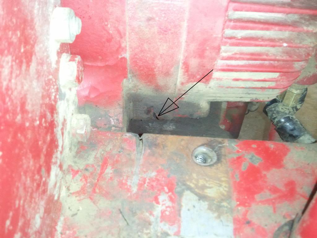

hcminis 1,783 #5 Posted November 7, 2017 is the tube needed over transmission? Would like to see pictures of how it looks on the tractor Share this post Link to post Share on other sites
WVHillbilly520H 10,378 #6 Posted November 7, 2017 1 hour ago, hcminis said: is the tube needed over transmission? It's highly recommended, extended use without it will eventually rub a groove/hole in the trans case... Share this post Link to post Share on other sites
