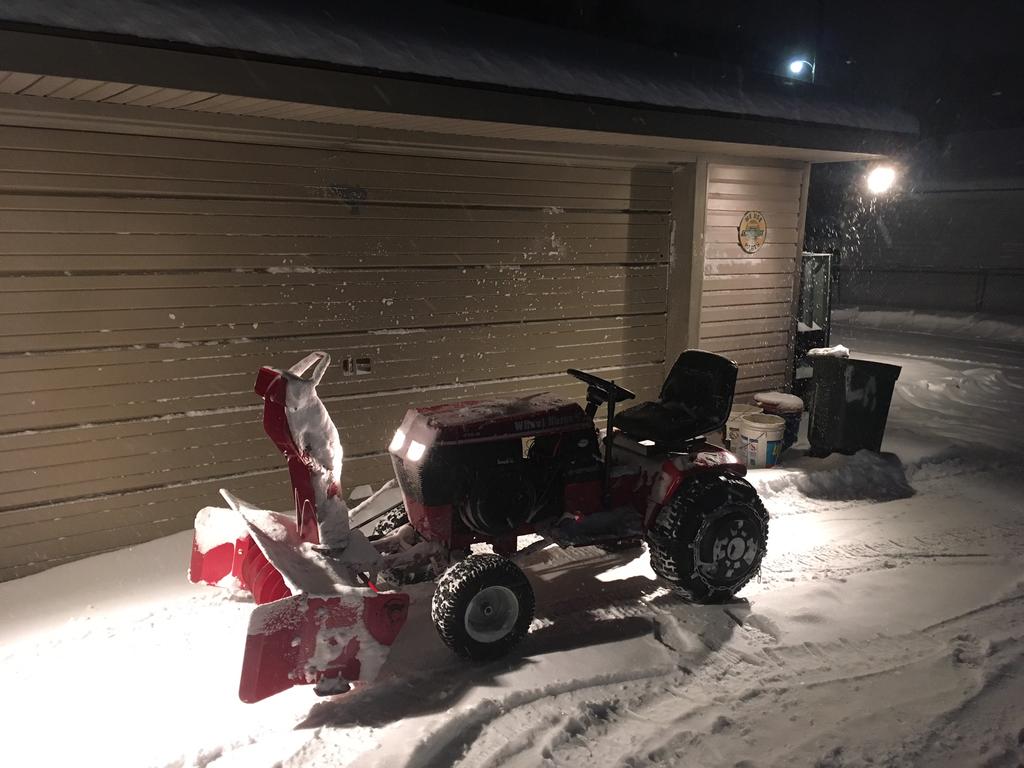

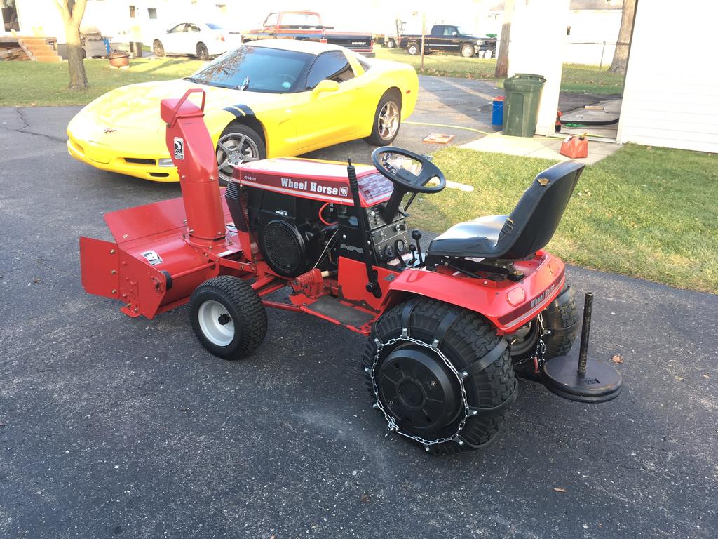

JoeliusZ28 77 #29 Posted December 11, 2017 Got the new chains installed last weekend and getting the first snow of the season today here in Michigan - if we get more than a couple inches I might get to try it out! I think I am leaning towards converting to a 4-link eventually but I will see how it does first. I can already tell they are going to make a huge difference. 1 Share this post Link to post Share on other sites
oldredrider 2,553 #30 Posted December 11, 2017 I've been running rubber chains for about 5 years now. As far as traction, I can't tell any difference from the steel chains. All plowing is level or slight grade. Haven't felt any side slip at all. Granted, this is Virginia not Michigan winters! The greatest advantage over steel chains is NO marking on pavement so no frequent seal coating to hide chain marks. I run them on a GT-14 with limited slip rear and 'lots" of extra weight. Steel chains made my driveway look like a drag strip running bulldozers. Love the rubber chains and so does the wife! 1 1 Share this post Link to post Share on other sites
Ed Kennell 47,420 #31 Posted December 11, 2017 She looks ready for the big snow. I think you will be surprised at the traction you have on the pavement. Share this post Link to post Share on other sites

JoeliusZ28 77 #36 Posted December 14, 2017 These things did awesome!!! You guys were aboslutely right about how they "flip up" into a scoop when you start spinning. It was like having on demand paddle tires. It might stop and spin for a second but once both sides caught it would take right off again. Never got stuck one time yesterday during 2 hours of plowing the 10-12" of snow here in SE Michigan. 2 2 Share this post Link to post Share on other sites
