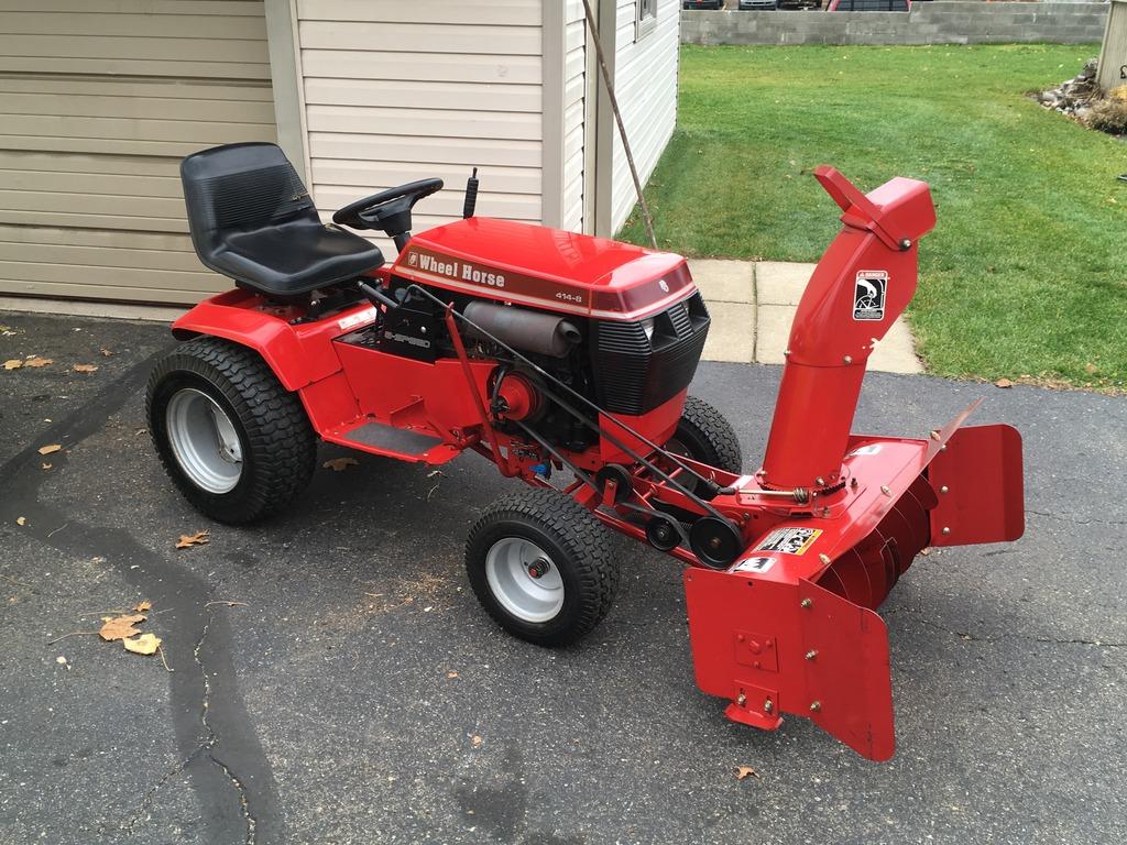

JoeliusZ28 77 #1 Posted November 7, 2017 (edited) Hey everyone, I've got my '89 414-8 pretty well outfitted for throwing snow other than the original turf saver tires. I've got hitch weights and wheel weights and as long as I let the clutch out easy it seems to have fairly good traction. however if I let the clutch out too quickly they tend to just polish the snow and spin, sometimes causing me to get stuck. I've also got a slow leak in one of the tires so I figure it might just be a good time to upgrade anyway. I don't want to run chains as my neighbor used them once and scratched the asphalt pretty bad. I'd like to put something on that offers more traction as-is and hopefully has a more cool, aggressive look. I've read a lot of good things about the carlisle all terrains here. I think the 23x10.5-12s on the 520 wheels look awesome but I'd need to find a set of those wheels and that would be more of a look than function from what I've read. What I'm wondering is, would the same tire in 25x9x12 fit under the fenders on the stock wheels and be within the range of deck adjustability? It looks like it would be close. Or should I just go with the stock 23x8? I also use my tractor for cutting lawn, however snow removal is without a doubt the primary reason I own this tractor. (If I didnt have to clear snow I'd probably own a push mower). There is as much or more driveway to clear than grass to cut and I often clear my neighbors driveways as well. I don't really need to worry about tearing up the lawn because I'm on flat dry ground, so AGs or ATV tires wouldn't be out of the question. Rubber chains and filled tires are other things I am considering. Rear tires are my primary concern for the moment but also looking at ideas for the front too. Thanks! Pic of tractor attached for curious minds Edited November 7, 2017 by JoeliusZ28 2 4 Share this post Link to post Share on other sites

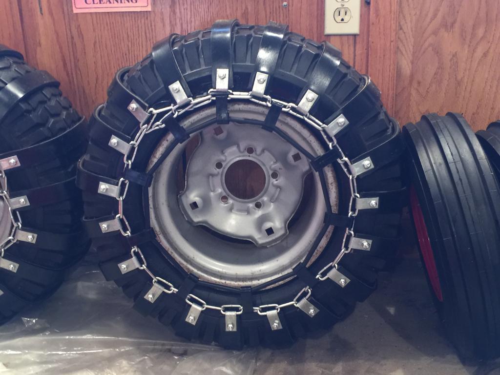

Ed Kennell 47,420 #2 Posted November 7, 2017 I was really amazed at the traction the rubber chains provided. 6 3 Share this post Link to post Share on other sites
JoeliusZ28 77 #3 Posted November 7, 2017 Wow I've never seen any like that, where did you find those? Those look much more robust than the ones I've seen. Share this post Link to post Share on other sites
lynnmor 9,042 #4 Posted November 7, 2017 They are made in Lancaster County, Pennsylvania. http://www.rubbertirechains.com/ They perform nearly as well as steel chains but they will slide sideways easily on a slope. 3 2 Share this post Link to post Share on other sites
ronhatch 410 #5 Posted November 7, 2017 I have a blacktop drive as well and Iv'e had good luck with cable chains. 1 Share this post Link to post Share on other sites
Jerry77 1,218 #6 Posted November 7, 2017 (edited) Rubber chains for me too for my asphalt drive - ride a little rough, but are only for winter use.... Forgot to mention..available at Amazon for around 100 dollars -- let the air out of you tires when you put them on and adjust them a little loose, then air up the tire to 12-14 pounds - they will conform to the tire - won't need bungee cords to keep them tight... Edited November 7, 2017 by Jerry77 additional info 4 Share this post Link to post Share on other sites

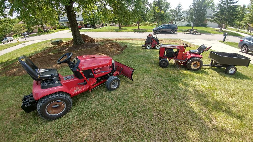

bmsgaffer 2,071 #7 Posted November 7, 2017 Weight is key. I used these tires last year and they worked amazingly well, but I didn't have more than one chance to try them. They are Kenda K502's (Terra Tracs), but they only come in 10.5" width, so you will need the wheels from a 520H or an newer XI to make fit well. The weight bracket is new this year, and with the wheel weights installed (not pictured) I can have an overall vehicle weight of nearly 1500lbs. I also recommend Vredestein V61's for the front. Deep 5 rib tires but wont put ruts in the grass like the tri-ribs sometimes will (also cheaper than the tri-ribs), but still grabs the snow and steers. 6 1 Share this post Link to post Share on other sites
Lee1977 7,786 #8 Posted November 7, 2017 (edited) I have Carlisle All Trail II 25x9x12 on my 312-8. I raised the seat bracket, gas tank and all up 1 3/4". I now have 2 1/16" clear between the tire and fender. I have 1/2" clear at the foot rests after bending the outside up-right forward. The inside of the up-right can't be bent forward with out trimming the belt guard and side panel. They have had good traction on everything I have tried, but they have only been in 4" of snow. We don't get a lot of it around here. Edited November 7, 2017 by Lee1977 3 Share this post Link to post Share on other sites

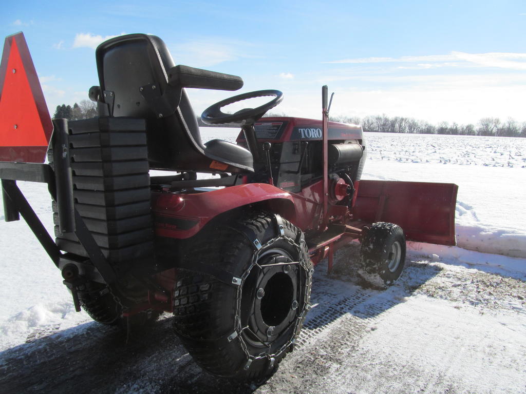

WHX?? 58,241 #10 Posted November 7, 2017 2 hours ago, JoeliusZ28 said: and scratched the asphalt pretty bad The old saying of there is concrete that isn't cracked and there is concrete that is gonna crack pretty much holds true for asphalt getting cracked and scratched. I just layed out 12k for a new surface to have to clear snow off of and I was worried about marring it with chains and the wrath of the Mrs it would bring if I did it. I finally went with standard double link tire chains (no v-bars) on the stock 520-H turf tires. they do work ok but will leave marks if not watching out for wheel spin. Nothing the first coat of driveway sealer won't cover tho. My ultimate goal is ag tires with a set of the rubber chains like @Ed Kennell's and lots of rear weight once I get around to my 2 stage beast project. BTW nice clean lookin tractor Joel 5 Share this post Link to post Share on other sites

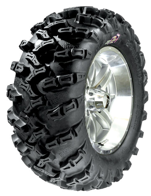

JoeliusZ28 77 #14 Posted November 7, 2017 What about an ATV tire in a 23x10-12? Looks like this could be pretty serious in the snow: 2 1 Share this post Link to post Share on other sites
Big_Red_Fred 1,548 #15 Posted November 8, 2017 Bring on Old Man Winter Farmer Alex Said ! Go Ag's or Shorts , cut off shirt & Cowman Boots like Big Red Fred sissy's Spoiler Spoiler Share this post Link to post Share on other sites
WHX?? 58,241 #16 Posted November 8, 2017 (edited) Don't mind to ol BRF Joel ...me thinks he is long on money but short on brains... just BRF. All kidding aside those actually those at tires don't look half bad but they will skid on ice same as any other tire without some kind of stickment to the earth. Broader flater tires providing more contact will provide most traction. ATV tires may look boss but are designed to have more traction on the sidewalls in dirt that most of our horses see. Chains & weight are the answer and doesn't matter if it's turfs, ags or what ever thread you chose. It really depends on what else you have use for the tractor for. You mentioned it's only or main duty is to blow snow on black top on flat ground then I would just stick to turfs and a set of rubber chains & some weight and you will do fine. That way summer work you can still run over lawn without leaving turn marks or ripping up sod. Edited November 8, 2017 by WHX12 1 Share this post Link to post Share on other sites

Ed Kennell 47,420 #21 Posted November 9, 2017 I think you will be pleased with the traction the rubber chains provide. Did you order the 2 or 4 link? The 4 link has a rougher ride than the 2 link when running on cleared pavement. Just a couple points, as Lynnmore stated above, the rubber straps will not offer any resistance to side to side slipping. This was never a problem for me as I only travel straight up and down the areas I plow. Another point was made above to deflate the tire and reinflate after the chains are installed to make them tight. I really believe the rubber straps work better when they are loose or just snug with a tightener. As the tire starts to spin, the leading edge of the strap twists coming away from the tire creating a paddle effect similar to a pulling tire that really increases the traction. 1 Share this post Link to post Share on other sites
JoeliusZ28 77 #22 Posted November 9, 2017 (edited) Thanks for the info. the website didn't offer an option as far as 2 or 4 link, but I believe they are a 4-link set judging from the picture. I didn't even notice one of the sets that was posted here was a 2 link until you pointed it out. Edited November 9, 2017 by JoeliusZ28 1 Share this post Link to post Share on other sites
Sarge 3,473 #23 Posted November 9, 2017 Good point about side slip with any chains , rubber or steel they will do the same with the standard cross-the-tread design - if you get into a slick spot on a hill they will slide sideways . I'd prefer the Euro or diamond pattern in the steel type if I could find them to fit the common Horse tire sizes . https://www.tirechain.com/Tire-Chains-Studded-Tractor.htm Sarge 1 Share this post Link to post Share on other sites
GlenPettit 1,719 #24 Posted November 9, 2017 (edited) They are made by an Amish family in PA, and they only offer four-link, but you can purchase 20 more individual links (strap, 2-U clips, & 2 sets of nuts) to install between the straps to get this 2-link, ––– and 2-link is much much smoother than just 4-link. After only 4 hours of use last Winter (Snowblower), there is barely any visible wear on the rubber, at this rate, I'm sure I'll get 10-15 years use out of this rubber-chain. I also ran a large o-ring with many clips on both sides to keep the chain taunght (tight/snug). Remember: weight, weight, weight –– is everything. For hills, metal diamond-chain is the absolute best, some ATV chain dealers do have a very open diamond-chain, but not nearly as heavy-duty or dense as what 'Sarge' posted (wonder what that chain costs). Glen Edited November 9, 2017 by GlenPettit 2 Share this post Link to post Share on other sites
Ed Kennell 47,420 #25 Posted November 9, 2017 And to increase the life the "chains" can be swapped left to right and turned inside out to distribute the wear on all four corners of the straps. 3 Share this post Link to post Share on other sites
