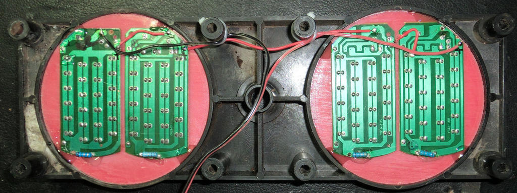

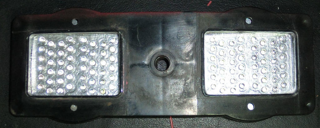

mpoore 34 #1 Posted November 5, 2017 Shown is my solution to retrofitting a C-195 with LED headlights. I 3D printed a holder for the free (with purchase) Harbor Freight 3v pocket flashlights. It took 4 of the flashlights using 2 on each side. That's 96 LEDs total.. Sprayed the holder with chrome paint. Wired in series you can use them as is with a 12v system. Pictures of working headlights are really useless for comparison purposes. What I can tell you is that the LEDs are significantly brighter and whiter. Total cost less labor was around $5.00 not including the purchases for the free flashlights. I also overpaid for the polycarbonate lenses, which was $4 of the $5. 11 4 Share this post Link to post Share on other sites
