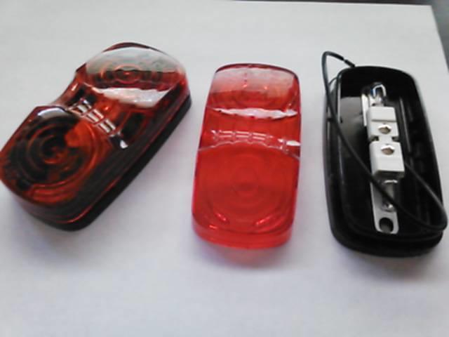

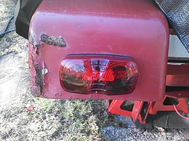

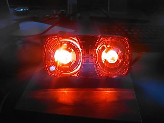

Found some rear lights for my D160
Petes Horse
I've been looking for a while. The bolt holes just line up and the wire is a little tight between the fender and light. No drilling though.
They were at Rural King. I think about three bucks each. Optronics MC42RS RED  Marker/Clearance.

I'd suggest soldering a separate ground wire to one of the grounding straps in those lamps - they will corrode around the rivets and lose the ground in pretty short order from humidity  . Scrape a small area , apply some flux and have at it with a good hot iron , but do it quickly to avoid melting the housing .

Nice lights.I've been buying similar looking LED's on that popular inter-net auction site.
