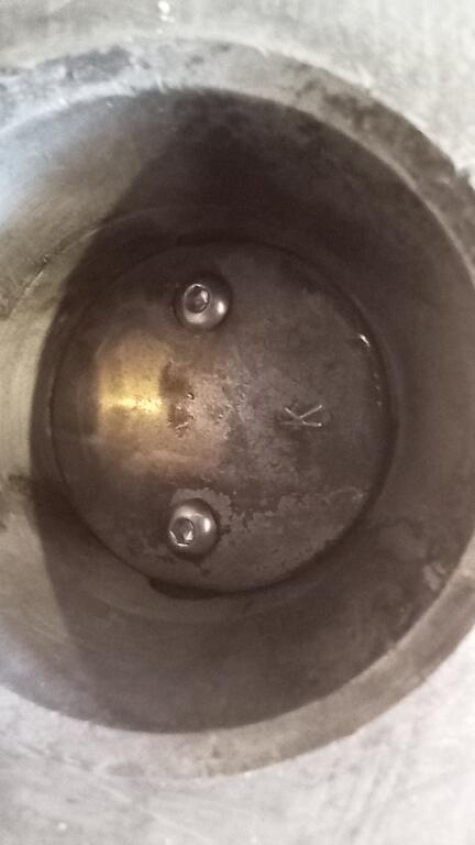

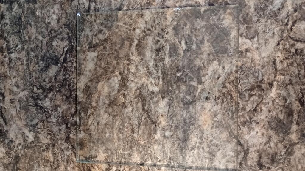

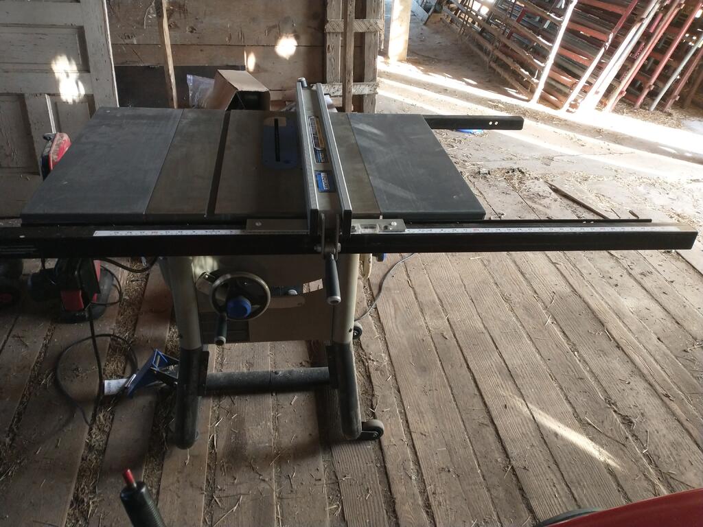

AlexR 3,139 #102 Posted March 16, 2025 (edited) Got the rebuild kit for the carb. And got stainless steel screws for the throttle plate. Waiting on some split lock washers to come in to finish that up, also going to use loctite as well. And next I have a question for you guys so I am going to flatten the head when I replace the head gasket, so I have this piece of 1/4" thick glass, or I have a delta table saw. Which should I use as the flat surface for the sandpaper? Edited March 16, 2025 by AlexR 1 Share this post Link to post Share on other sites
Ed Kennell 47,942 #103 Posted March 16, 2025 I would use the glass. 5 1 Share this post Link to post Share on other sites
kpinnc 19,107 #104 Posted March 17, 2025 3 hours ago, AlexR said: And got stainless steel screws for the throttle plate. Waiting on some split lock washers to come in to finish that up, also going to use loctite as well. Red loctite, and plenty of it. I had a Magnum ingest a brass butterfly screw. Mashed it flat as a pancake. Stainless will likely break the head and piston. 2 Share this post Link to post Share on other sites
ebinmaine 81,281 #105 Posted March 17, 2025 3 hours ago, Ed Kennell said: I would use the glass. Seconded. Lay a towel on whatever surface the glass will be on. Lay the glass flat and even. Tape the sand paper to the glass. I use several grits. Sand away..... BE SURE TO ROTATE THE CYLINDER HEAD OFTEN. 1 Share this post Link to post Share on other sites
AlexR 3,139 #106 Posted March 17, 2025 34 minutes ago, kpinnc said: Red loctite, and plenty of it. I had a Magnum ingest a brass butterfly screw. Mashed it flat as a pancake. Stainless will likely break the head and piston. Definitely I am not planning on those screws coming back out, until those bushings wear out so not for a long long time. Share this post Link to post Share on other sites
AlexR 3,139 #107 Posted March 17, 2025 23 minutes ago, ebinmaine said: Lay a towel on whatever surface the glass will be on. Lay the glass flat and even. Tape the sand paper to the glass. I use several grits. Sand away..... BE SURE TO ROTATE THE CYLINDER HEAD OFTEN. Yes I was thinking about that, a towel would provide some cushion for a not perfectly flat surface under the glass. I have read a figure 8 sanding pattern is good to do. 2 Share this post Link to post Share on other sites
ebinmaine 81,281 #108 Posted March 17, 2025 9 minutes ago, AlexR said: figure 8 sanding pattern That's true...but... A Kohler cylinder head on a standard 8.5 x 11 piece of sand paper won't leave much room for the figure 8 motion. BBT and I have found that a straight motion going the longer direction is easier. I spin the head about 20 to 30 strokes to maintain an even cut. Plan on a solid hour of sanding off n on over a couple days and you'll get good results. 1 Share this post Link to post Share on other sites
AlexR 3,139 #109 Posted March 17, 2025 37 minutes ago, ebinmaine said: A Kohler cylinder head on a standard 8.5 x 11 piece of sand paper won't leave much room for the figure 8 motion. Didn't even think of that, thank you very much for the advise! Very helpful. 1 1 Share this post Link to post Share on other sites
Handy Don 17,735 #110 Posted March 17, 2025 15 hours ago, AlexR said: And next I have a question for you guys so I am going to flatten the head when I replace the head gasket, so I have this piece of 1/4" thick glass, or I have a delta table saw. Which should I use as the flat surface for the sandpaper? ¼” glass can flex. Use the glass on the table saw on a thin cloth just to anchor the glass. 2 Share this post Link to post Share on other sites

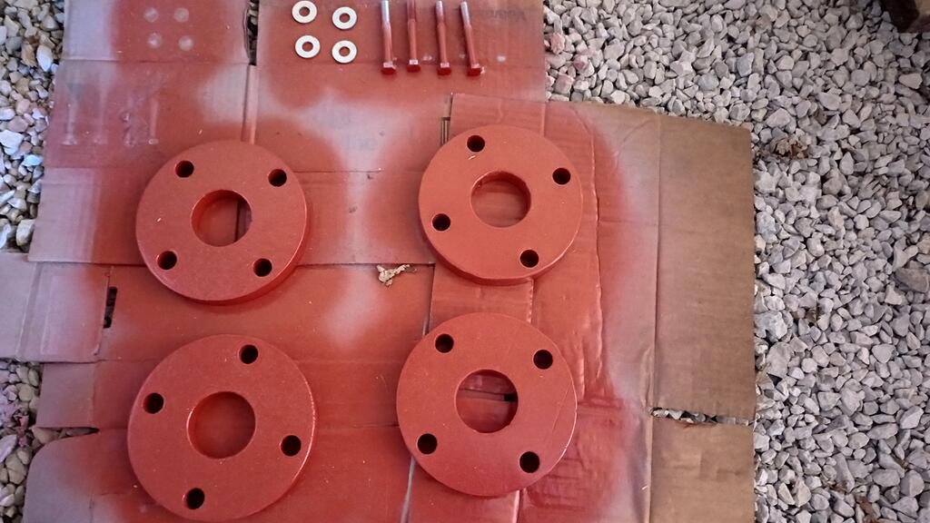

AlexR 3,139 #114 Posted March 23, 2025 Getting the weights painted, And got the lock washers for the throttle plate screws, so got those in with red thread locker. Not sure those screws are coming back out 1 1 Share this post Link to post Share on other sites
kpinnc 19,107 #115 Posted March 23, 2025 3 hours ago, AlexR said: Not sure those screws are coming back out Probably for the best. 2 Share this post Link to post Share on other sites

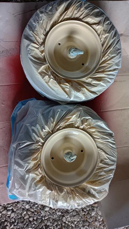

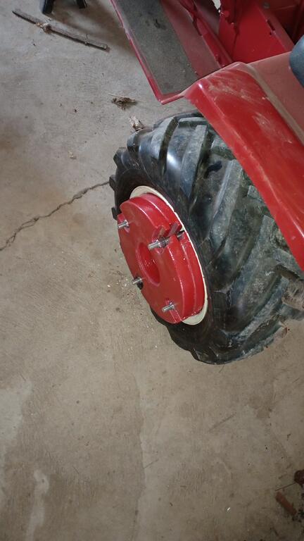

AlexR 3,139 #116 Posted March 26, 2025 Got the front rims painted. And got weights mounted on the landside of the tractor for plowing, the tires are already fluid filled. 7 Share this post Link to post Share on other sites
rjg854 13,454 #117 Posted March 27, 2025 15 hours ago, AlexR said: And got weights mounted on the landside of the tractor for plowing, the tires are already fluid filled May I suggest putting caps on those protruding bolts or cutting them a bit shorter, your shims just might thank you. 3 2 Share this post Link to post Share on other sites
squonk 48,427 #118 Posted March 27, 2025 1 hour ago, rjg854 said: May I suggest putting caps on those protruding bolts or cutting them a bit shorter, your shims just might thank you. Acorn nuts work and look good. 3 Share this post Link to post Share on other sites

953 nut 70,649 #121 Posted March 27, 2025 10 hours ago, rjg854 said: May I suggest putting caps on those protruding bolts or cutting them a bit shorter, your shims just might thank you. I would suggest removing them one at a time and running the bolts into the wheel rather than the weight. 2 Share this post Link to post Share on other sites

AlexR 3,139 #123 Posted March 28, 2025 7 minutes ago, 953 nut said: I would suggest removing them one at a time and running the bolts into the wheel rather than the weight. They are carriage bolts so I can't really do that with them as it needs a washer on the weight side and the square of the carriage bolt fits in the wheel. I will probably just cut them a bit shorter. 2 1 Share this post Link to post Share on other sites
