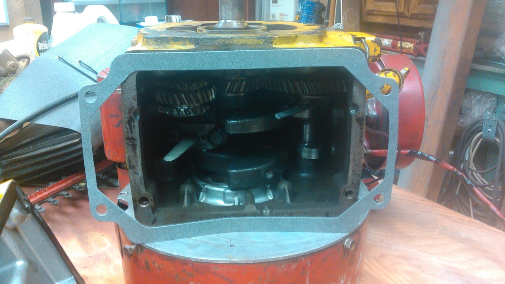

953 nut
@JPWH worked it out OK, Take a look starting on post # 78.
dhr5050
So if I put a  K241s oil pan on a K241AS then it will fit my C100 and essentially become a K241s? Is it feasible and easy to swap the oil pans? Sorry for all the questions, just trying to get my horse up and running as fast as possible.
953 nut
No, they will not interchange. What Jay did in his post was to make an adapter.
The photo in post # 78 that I attached above shows this photo of the difference.
  • Like 1
JPWH
I don't know what type engine is what. But if you could post a picture maybe that would help. If you have the same engine I have the bolts that mount the engine come up from the bottom. I have a small block and could have used a shallow pan and shorten the oil slinger and less modifications would have been required. But my property is sloped so I opted for the deep sump.
  • Like 1
  • Excellent 1
