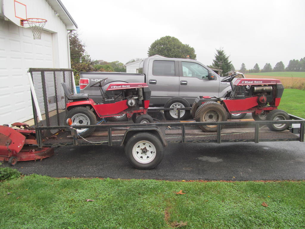

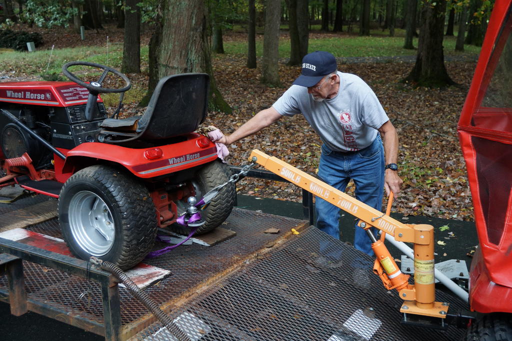

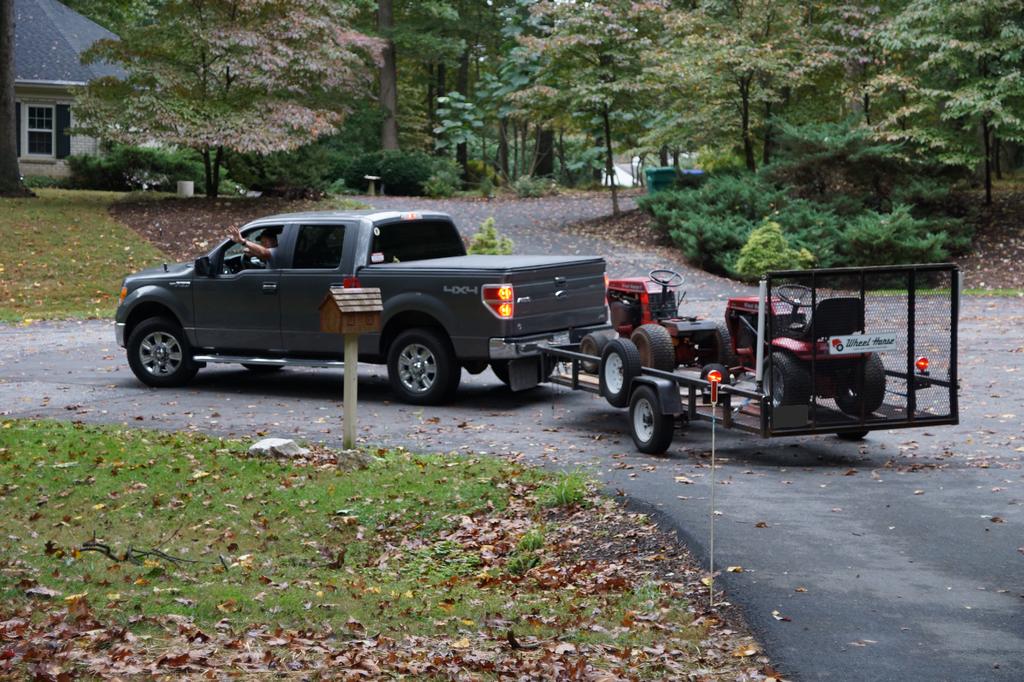

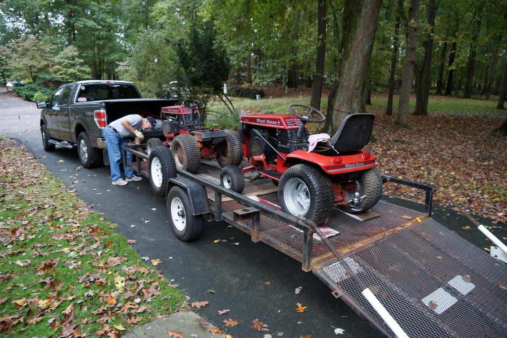

shallowwatersailor 3,216 #1 Posted October 12, 2017 (edited) My buddy and fellow RS member, Ed Kennell, just left with my last two Classic-style Wheel Horses. So long to my 1986 312A and matching 1986 417A. Ed and I used the hand winch installed on his trailer plus the HF crane on my 518xi to easily load the tractors. Both are must-have accessories in my book! In preparation for our move next year, I am continuing to downsize the herd to a workable number.. So in the Wheel Horse column I now have left three Black Hoods and three 5xi tractors. That still leaves seven Bee Hinds as well. Next weekend we begin the search for a new property further South in the State for Lovers. Edited October 12, 2017 by shallowwatersailor 14 1 Share this post Link to post Share on other sites

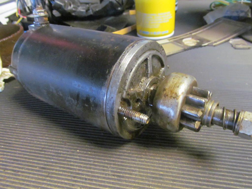

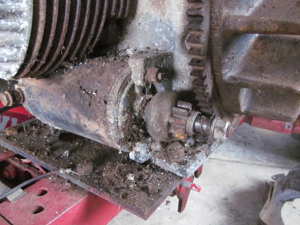

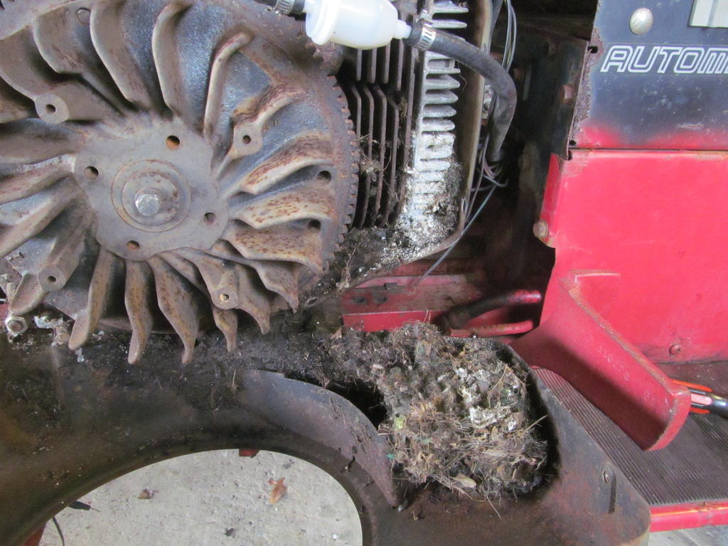

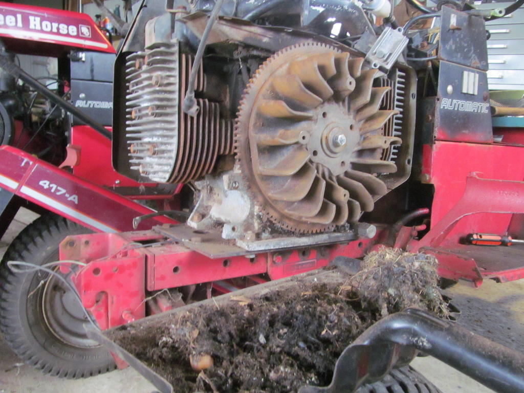

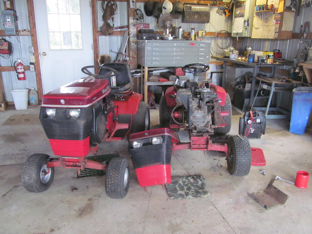

Ed Kennell 43,815 #12 Posted October 13, 2017 Update John, @shallowwatersailor, I got the boat moved to winter storage this morning and got your horses unloaded inside. I put a battery in the 312 and it turned over. I didn't try to start it as I was more interested in the 417. The 417 appeared to be locked up, so I took off the flywheel cover and I was able to turn it using the flywheel. It seems free now. I put 12v direct to the starter and it seemed to be locked, so I took off the tins and starter to find a rodent condo. I got the starter off and cleaned things up a bit and actually got the starter to run, but it has bearing issues. I will soak the thru bolts several days , then try to open it up. I don't know if this horse will ever run again, but he must feel better to get this crap out of his gut. To be continued. 5 Share this post Link to post Share on other sites

shallowwatersailor 3,216 #14 Posted October 13, 2017 1 hour ago, Ed Kennell said: Update John, @shallowwatersailor, I got the boat moved to winter storage this morning and got your horses unloaded inside. I put a battery in the 312 and it turned over. I didn't try to start it as I was more interested in the 417. The 417 appeared to be locked up, so I took off the flywheel cover and I was able to turn it using the flywheel. It seems free now. I put 12v direct to the starter and it seemed to be locked, so I took off the tins and starter to find a rodent condo. I got the starter off and cleaned things up a bit and actually got the starter to run, but it has bearing issues. I will soak the thru bolts several days , then try to open it up. I don't know if this horse will ever run again, but he must feel better to get this crap out of his gut. To be continued. Wow! This KT17 Series 2 must have been a desirable habitat. Hopefully, for just gas money, made it worth the trip. 3 Share this post Link to post Share on other sites

Ed Kennell 43,815 #18 Posted October 14, 2017 The critters chewed thru the vacuum line that operated the front hubs on my 4WD F-150 . I thought the tranny went when the hubs were jumping in and out of gear W/O the front axle in gear. A certified Ford Mechanic drove it and said yes, your tranny is crap, we will need 2 weeks to install a new one under warranty. Another mechanic heard the issue and had encountered the problem before. He fixed it in 10 minutes. It cost me a $4.00 plastic tee and $50 service call. Damage due to animals is not covered. The $1200 tranny would have been free. Dang critters. Here is a small update on the 417. I got the rest of the tins off ..... what a bucket if 1/4" screws. Since I don't have a started yet, I hooked up a 10 HP Kohler starter to check the compression. I haven't looked up the specs yet, but 65PSI looks low. Any twin experts have the number? If I put 12V to the coil and crank it, should I see fire at the plug? MVI_8498.MOV Here is a short video of the pressure test. 1 Share this post Link to post Share on other sites
