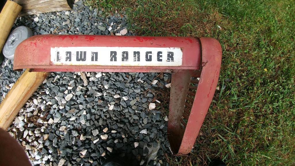

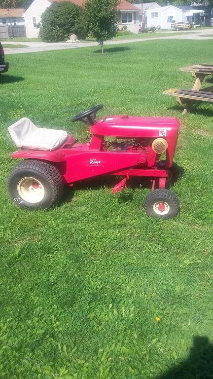

Vinylguy 4,797 #1 Posted October 9, 2017 Customer says his model number is L-57 Tractor has 3 spoke steering wheel? Share this post Link to post Share on other sites

pfrederi 21,307 #3 Posted October 9, 2017 L-157 should be 1967 electric start two spoke wheel and a smooth belt guard (no indentation for the decal). Share this post Link to post Share on other sites

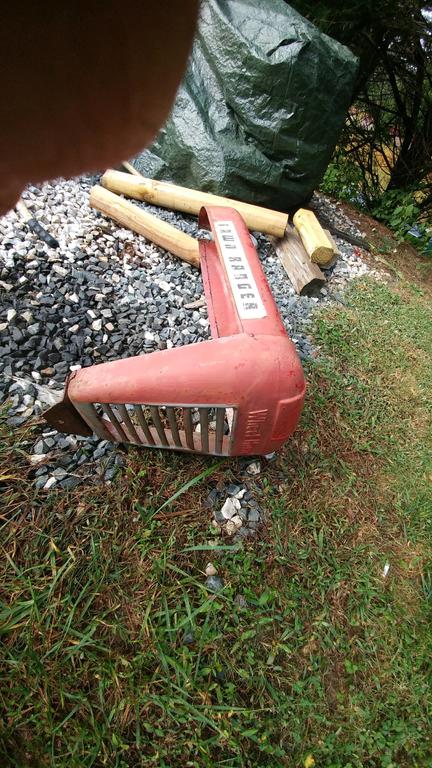

evanloock 269 #4 Posted October 10, 2017 Not that it couldn't have been replaced, but if memory serves, that hood decal was only used in 1969 (last year before the vertical shaft/fiberglass Lawn Ranger). Share this post Link to post Share on other sites
BOB ELLISON 2,983 #5 Posted October 10, 2017 This is my 67 L157 lawn ranger. The hood decal is not what you have there. Share this post Link to post Share on other sites
Vinylguy 4,797 #6 Posted October 10, 2017 It appears he has picked up a real Frankenstein. Going to send him the 67 set but include the 68 hood decals so he can use what he wants. Thanks for the help. It does have electric start and he can't find an definition switch for it. Share this post Link to post Share on other sites
BOB ELLISON 2,983 #7 Posted October 10, 2017 @Vinylguy it looks like he needs a picture of the rest of the tractor to be sure of what he has. Share this post Link to post Share on other sites
