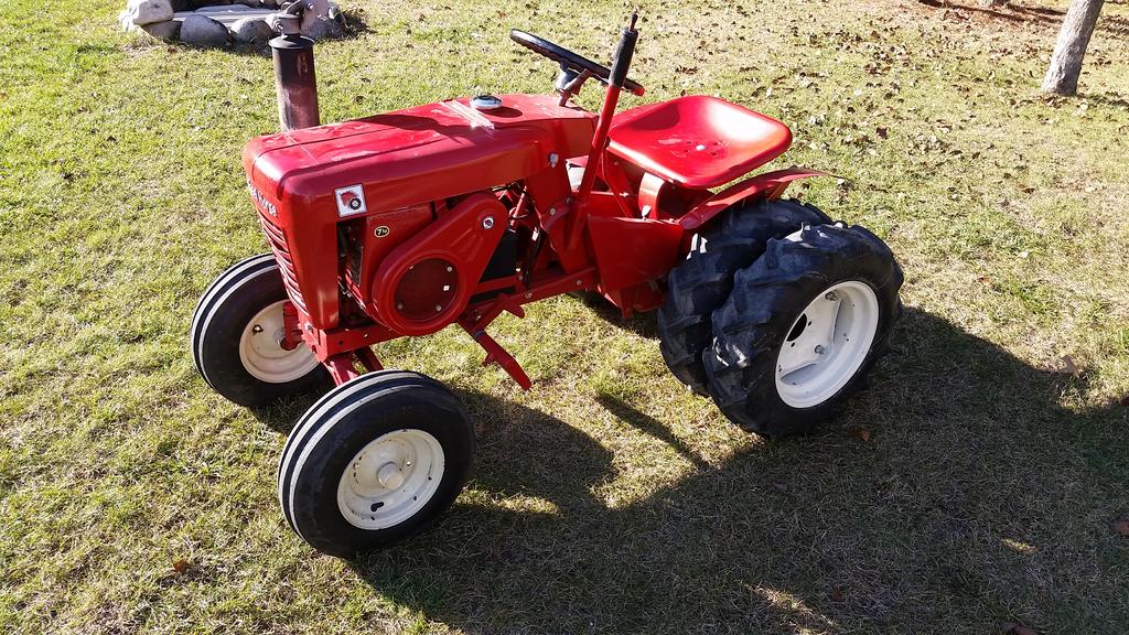

RedRanger 1,470 #1 Posted October 4, 2017 I've got to ask....on my 702, I'm running duals 6-12 ags. Taking off from a standstill in 3rd is nearly impossible. You have to ride/slip the clutch a lot and keep the throttle nearly at idle. No matter how soft you let off the clutch, the front wants to climb in the air. I generally have to take off in 2nd at low throttle and shift to 3rd on the fly to get moving and then throttle up. I'm running a K181 up front as well as front Wheel Horse wheel weights. Without the weights, it was deadly. Taking off in 2nd is ok, but will still pull the front off the ground if not careful, even with the front weights. Taking off in 1st is no issue. Do any of you running duals have this same issue? It's annoying as hell. I've got no other tractor that does this. Honestly, if I were to take off in 3rd at high throttle from a stop, it would flip over backwards. (which it did when I first bought it) Do you have to slip your clutch to get moving? Do your rear tires hook in the sod like a gear on a chain? Do you have to take off at idle and throttle up once moving? Is any gear over 1st deadly? This little stallion is a hand full! 2 Share this post Link to post Share on other sites

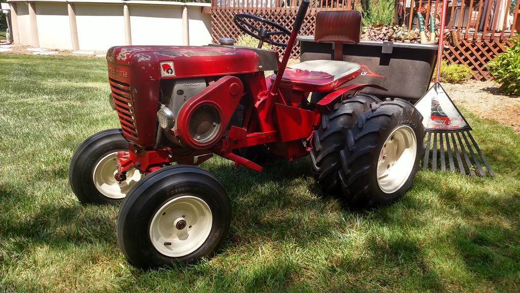

WHX?? 56,847 #5 Posted October 4, 2017 (edited) My 702 is almost identical to yours Red with 6/12 duals and I don't have problems unless I try to get stupid with it. My belt seems to have a good deal of slip tho and I'm thinking the belt is wearing and/or the clutch idler spring is too weak or some linkage adjustment is required as once in awhile it will throw the belt off the idler. I might try a size smaller belt too. Which leads me to my next question what brand/size of belt are you running? I have noticed the blue Huskys from TSC seem to really be grabby and all the tractors I have them on seem to be a little light in the front on takeoff! The one on my 702 is a WH belt 9291 I think but not sure on that number! Like I said it will climb stall walls when I get stupid! Edited October 4, 2017 by WHX12 ad pic 1 1 Share this post Link to post Share on other sites

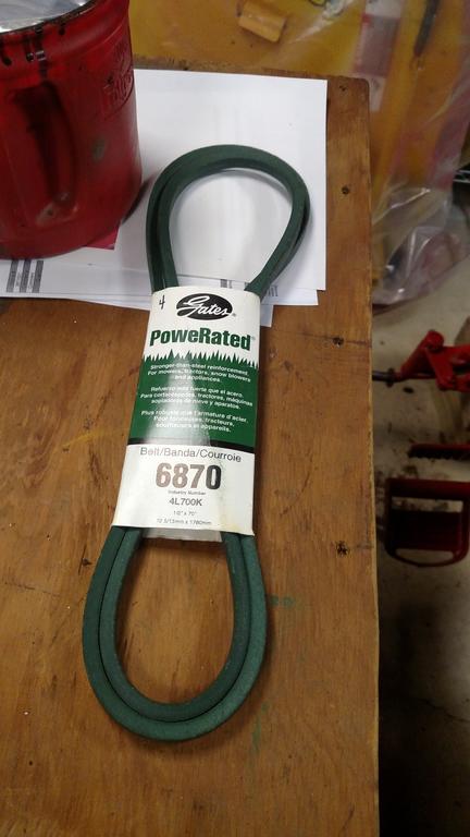

RedRanger 1,470 #6 Posted October 4, 2017 (edited) I'd have to look at the brand. I forget what it was. I know it's blue or green and I believe it was Kevlar. On-line purchase from a belt wholesaler. It was cross referenced to the OEM WH number. Maybe my belt is just too grippy? Weird thing is it did the same when I bought it and it had a worn out 40 year old rubber belt that was super loose. I thought maybe it was just too much traction. EDIT Just found this.... This is the belt. Edited October 4, 2017 by RedRanger 1 Share this post Link to post Share on other sites

WHX?? 56,847 #8 Posted October 4, 2017 That is bizarre then if it did it with an old sloppy standard rubber belt. If your belt is other than black chances are it's wrapped in Kevlar. Yes there is no adjustment on the pedal other than in, out or all the way forward to brake. I'm thinking maybe you could try a lighter tension spring? By any chance does your tractor drive make a hell of a racket when clutched like mine does? I think I have some belt slap in the guard when clutched? Share this post Link to post Share on other sites

WHX?? 56,847 #10 Posted October 4, 2017 70 incher then Red and Kevlar. I'll have to verify the WH number on mine and cross it to a length to see what size I am running. I would guess your pulleys are well worn in and burnished?? Looks like a 70 fits the IPL ...#81 4 minutes ago, 953 nut said: important to NOT shift while in motion. I was going to mention that Dick but I want to make sure @wheelhorseman continues to make an honest living! 1 1 1 Share this post Link to post Share on other sites
