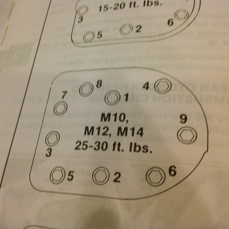

Sparky-(Admin) 26,686 #1 Posted October 2, 2017 So now that my broken head-bolt issue is behind me it’s time to install the new head gasket. I’ve done this before but it’s been like 4 years since my last head gasket install. What’s the proper foot pounds or inch pounds of torque? My torque wrench is in inch pounds. What’s the popular consensus on using any sort of gasket goo? Yes/No? If yes what type or brand is best. The motor in question is a K321 on my C-145. Thanks guys! Share this post Link to post Share on other sites

WHX?? 58,347 #6 Posted October 2, 2017 I always went by just what is in the Kohler manual and that has always worked for me. I would guess you have this one Sparkeye but just in case Kohler K-Series SM TP-2379 LR.pdf Share this post Link to post Share on other sites

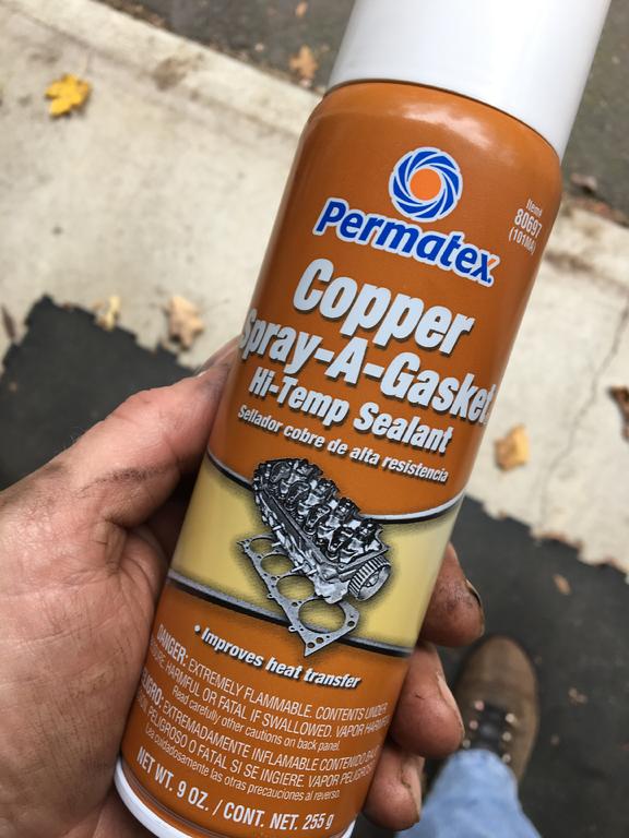

BOB ELLISON 2,983 #8 Posted October 2, 2017 I do reuse the old gasket if it looks good. I also spray it with permatex-copper-spray and I have never had any trouble yet. https://www.permatex.com/products/gasketing/gasket-sealants/permatex-copper-spray-a-gasket-hi-temp-sealant/ Share this post Link to post Share on other sites

Sparky-(Admin) 26,686 #17 Posted October 15, 2017 So it’s been awhile. Let the carb body soak for a week and rebuilt it. Then it was head gasket time, bought and used the copper spray stuff. Not sure if it needed it or not but it couldn’t hurt right? I sanded the points, kinda wish I ordered new ones as it has a little hiccup or a skip at hi rpms. Or maybe it needs a bit more carb adjustment. A38C1E81-CAD2-4450-B08A-FFAF284F6F58.MOV 1 Share this post Link to post Share on other sites

WHX?? 58,347 #25 Posted October 16, 2017 Did you use the copper spray gasket then Sparkeye? I noticed some recent exhaust side leakage on a freshed up 10 hp of mine and just wondering if I should try it or just learn how & have the patienceto glass a head. I've got the same hiccup on a 1257 but it goes away with a little fine tweaking of the hi speed adjust screw or when under load. Probably has original points in it so new ones are not the worst idea either. 1 Share this post Link to post Share on other sites
