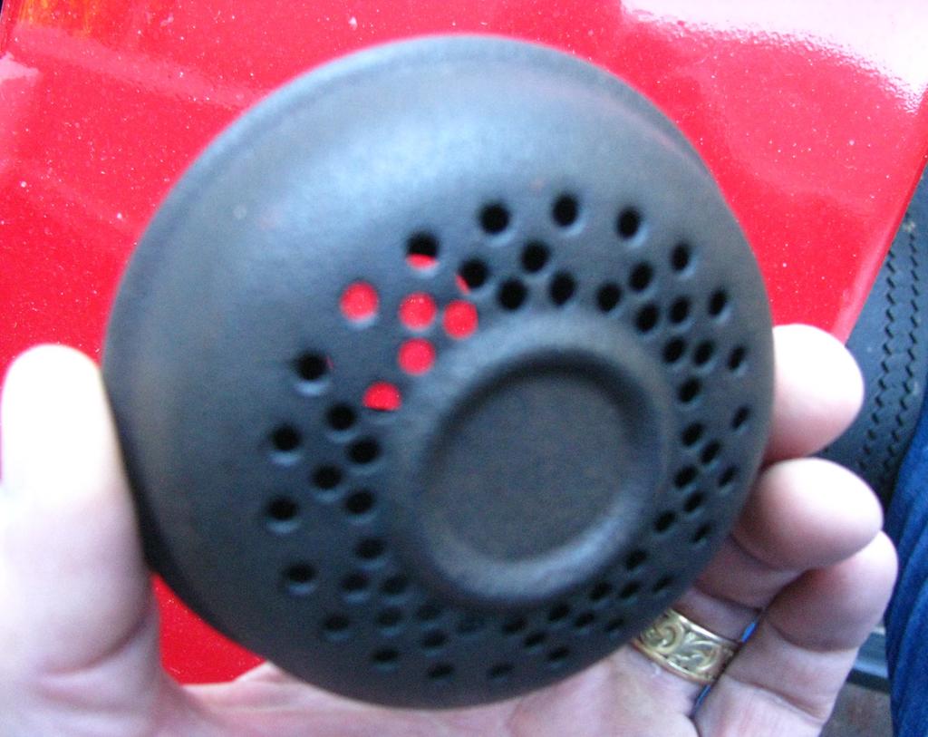

Got this original shower cap muffler hanging around here...
has zip, zero, nada for internals to muffle any of the exhaust passing through it.
Weird thing is the outside is solid, virtually perfect, but on the inside...it's down to the very last thread remaining to hold it onto a 3/4" nipple.
Was looking for some good ideas that will enable it to stay in service, they're getting so hard to come by these days...
I'd really hate to see it become just another dust collector.  :dunno:

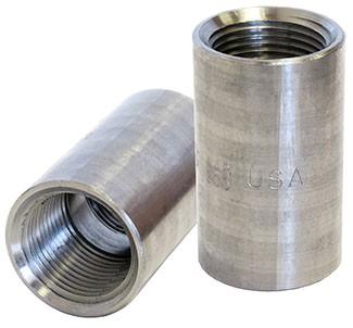

How about using one or two steel pipe couples welded together and cut to length . Weld a cap on end , drill a bunch of holes in pipe . Grind the threads back on the muffler until the couple slides in so that the couplers threads are just sticking out . Weld the coupler and muffler together . Grind down weld and make it look pretty . Hope this makes sense .

Didn't the original muffler have internal threads ?
If you want internal threads use this.  That's why I thought welding two together and cut to length if it was longer than one coupler . Use a pipe nipple to position it and hold into place for welding .
