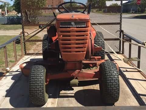

445FEBronco 13 #1 Posted September 23, 2017 New around these parts, got a old 1966 Wheel Horse 1276 I am tying to put back together. From the manual it apears that my tractor came with a dash with two pull cables for the throttle and choke? I have been scrounging EBay for the missing parts and found most of what's missing. I had a parts tractor that had some very good steering parts so I scored on that. What I do not have is the dash panel, I used the dash with the levers for now but need the generator light and dash. What models would share the same parts to help me in my search? 1 Share this post Link to post Share on other sites

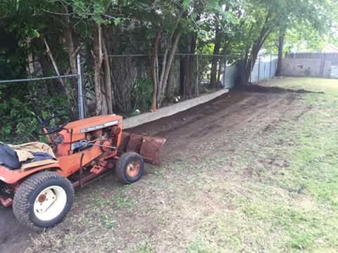

AMC RULES 37,260 #10 Posted September 24, 2017 Also have a 1277 here...has an ARK FEL mounted up to it. Tired too, but agree...these things are beastly machines. 2 Share this post Link to post Share on other sites

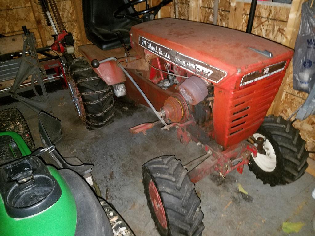

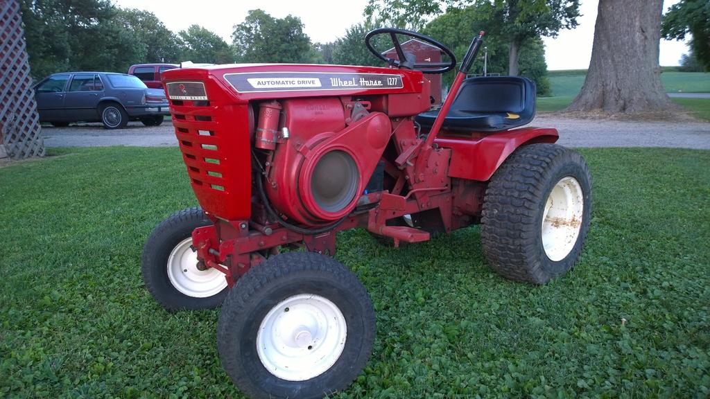

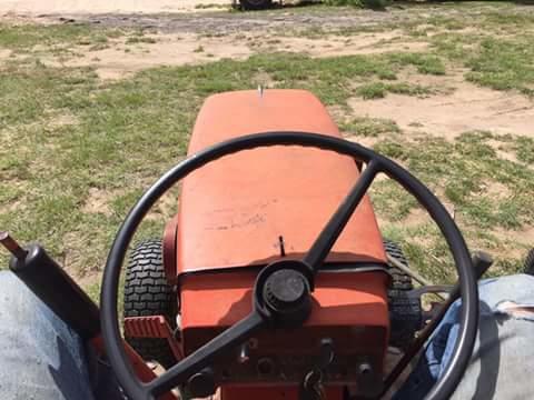

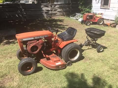

ClassicTractorProfessor 5,455 #16 Posted September 25, 2017 I also have a 1277, almost identical tractor to yours, just one year newer. In my opinion these were some of the best looking tractors Wheel Horse ever built. Like Sarge, my 1277 was my first Horse, and will always have a special place in my heart and in my stable. She was my dedicated worker up until her engine blew last summer. Now she sets in the back corner of the shed waiting patiently on a heart transplant Share this post Link to post Share on other sites
445FEBronco 13 #17 Posted September 25, 2017 Looks like you all have nice examples to work with, wish mine was more complete but getting there one part at a time. I have a decent blade and mower to work with. Everything is as stated unique to itself and styling is a head scratcher being half old and half new series. Should be a unique tractor when i get it going. Thanks for the pics and info it certainly helps. 1 Share this post Link to post Share on other sites

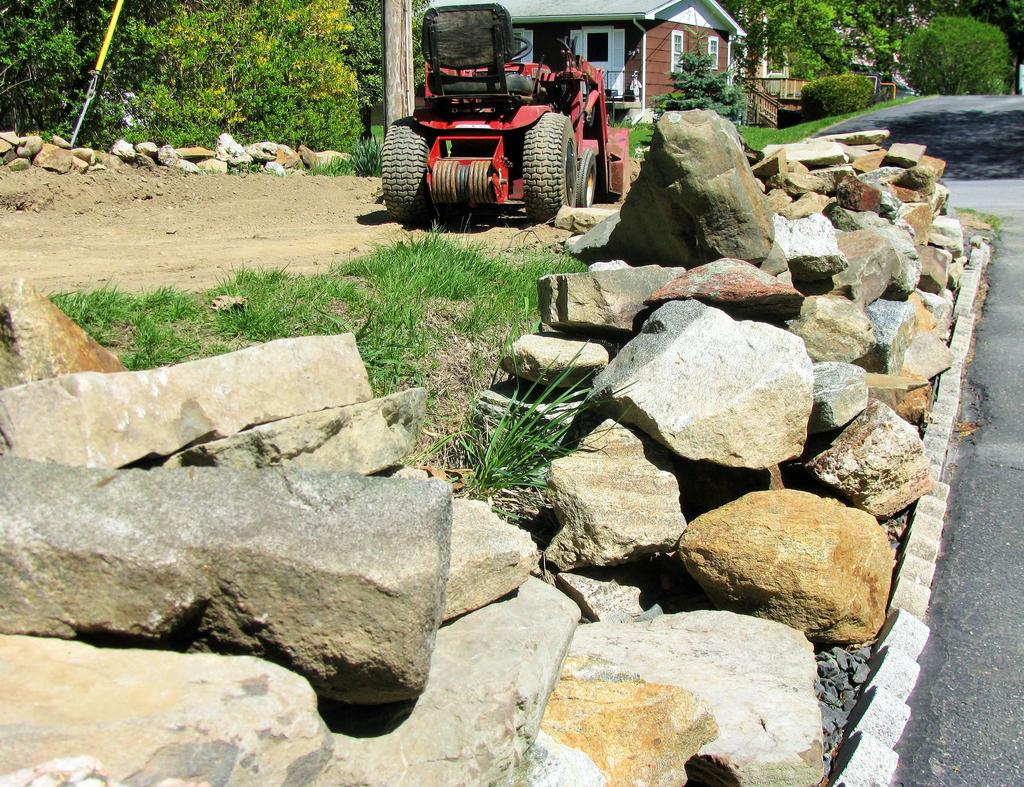

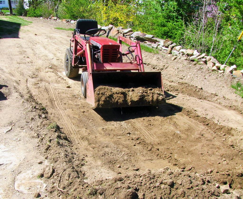

RandyLittrell 3,946 #21 Posted September 26, 2017 Might as well throw a pic up on my 1277 with FEL. It was my first WH and I didn't even know what I had till I showed up here. Lots of fart smeller's around here to help out!! 2 Share this post Link to post Share on other sites

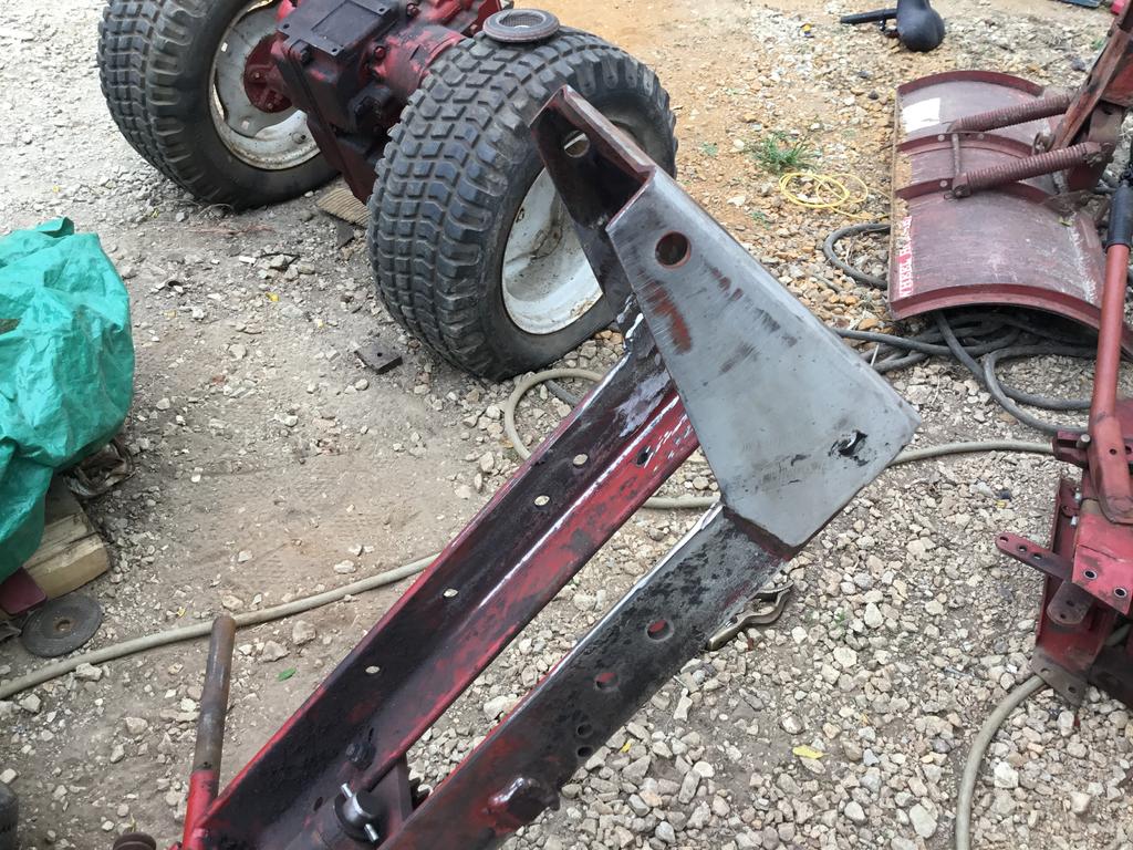

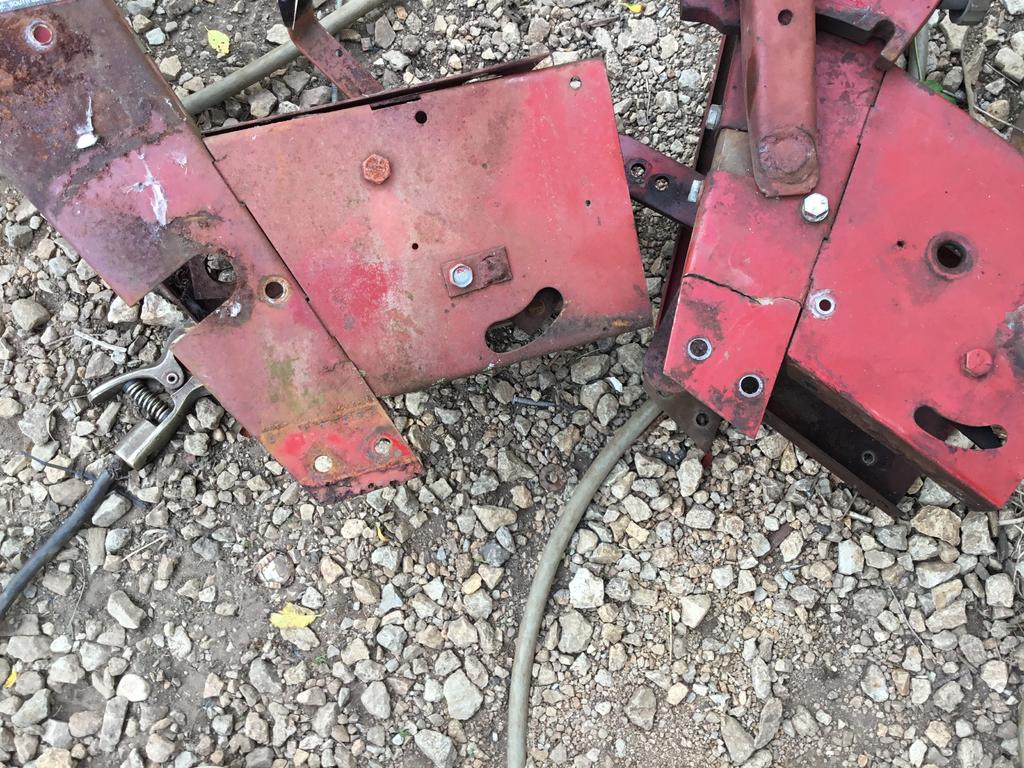

445FEBronco 13 #24 Posted September 27, 2017 Here is the old rigged bracket: Replacement grafted in: 1 Share this post Link to post Share on other sites
445FEBronco 13 #25 Posted September 27, 2017 You can see the crack in the dash by the lift arm, it's kinda stretched so I'll have to bolt it up before I tack it back up. Other thought was cut a new section out of my parts tractor to move the crack from the stress area, then I can back it up with some 10 gauge to reinforce the seam. The frame rail is just below the crack so it will be a bad area to have a bead running through, no room for reinforcement and still sit properly on the rail. 2 Share this post Link to post Share on other sites
