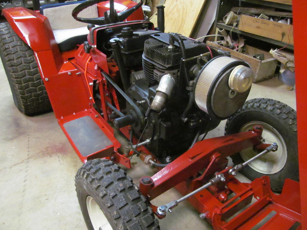

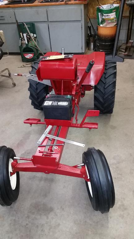

WHX?? 55,081 #14 Posted September 19, 2017 I personally like Lowell's ties but I would venture to say I have the best,or one of, the best steering horses out ther. Did some other mods to get it this way tho but we'll worth it. No a good pic ...let me know if you need more 2 Share this post Link to post Share on other sites
DennisThornton 4,773 #15 Posted September 19, 2017 29 minutes ago, WHX12 said: I personally like Lowell's ties but I would venture to say I have the best,or one of, the best steering horses out ther. Did some other mods to get it this way tho but we'll worth it. No a good pic ...let me know if you need more More please! Share this post Link to post Share on other sites
WHX?? 55,081 #16 Posted September 19, 2017 (edited) Thanks Dennis...Not to steal eb's thread but have a whole thread on that build in restos. I must say it is one fine steering tractor... very little to no slop and turns on a dime. I'm sure the tri-ribs help but I tried to keep the tolerances in the rest of the steering gear as tight as possble. I've got another link to tie rods that are not but look real orginal if you are interested eb. Edited September 19, 2017 by WHX12 Dang tablet Share this post Link to post Share on other sites

WHX?? 55,081 #18 Posted September 19, 2017 I do like @Ed Kennell's style of tie rods as well. The heim style ends seem to keep things a little tighter as things wear in and seem to take crowding corners a little better. Share this post Link to post Share on other sites
