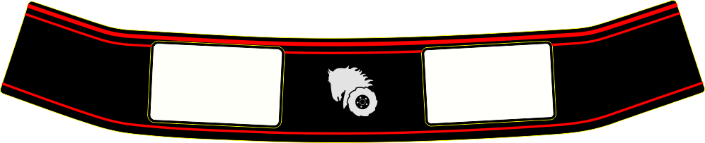

Vinylguy 4,796 #9 Posted November 28, 2017 I need a 246-H owner to test out this kit for me. I know they are not real popular for collectors but I have had requests a couple times a year for these. I finally was able to get the artwork done for this hood.I will gladly send this kit to someone willing to test for fit. Biggest concern is the front decal to see if I have the proper positioning for the headlights. 1 1 Share this post Link to post Share on other sites

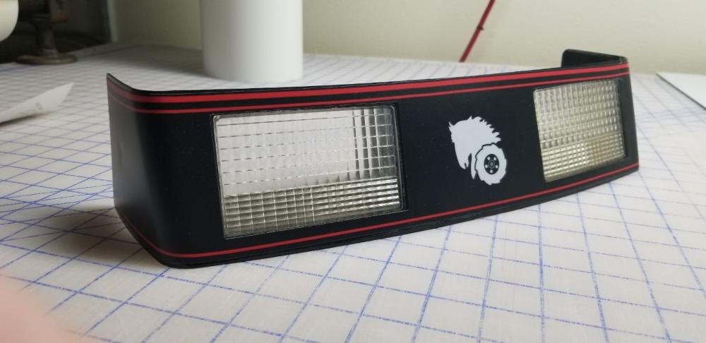

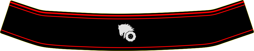

Vinylguy 4,796 #14 Posted April 1, 2018 (edited) On 12/7/2017 at 6:20 AM, WHX16 said: Did you ever get someone to test it out for you Terry? I can but my orginals are in pretty decent shape. Sorry I missed you post about this. I did get a front headlight panel and Made a template but the clearances are so close around the huge headlight lenses that it is difficult if not impossible to align this decal perfectly. In fact the original decal on my headlight bezel was far from positioned perfectly from the factory. Might be easier to trim out the headlights after installing the decal. Edited April 1, 2018 by Vinylguy 1 1 Share this post Link to post Share on other sites

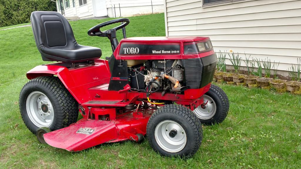

CountryRock 199 #15 Posted May 6, 2018 Ok, this will be a bit of a long post. Back in April I discovered I needed to do headwork on this right when I went to adjust the valves on it while readying it for mowing. Exhaust guide on cylinder 1 walked out enough to smash the pushrod. I reset the exhaust guides on both heads, lapped the valves and put it together with new gaskets all around. Runs like a clock now. In the past weekend I installed new Carlisle tires and a new Xtreme outdoor power equipment PTO clutch. Greased everything up and ran it around the yard a little while ago. It's good to be mowing again after the garbage winter we had. Enjoy a few pics. 1 2 Share this post Link to post Share on other sites
WHX?? 58,084 #16 Posted May 7, 2018 (edited) I got that same clutch for my 246 ...runs great, smooth engage and quiet..Make sure you follow Xtreme instructions and call them if you got issues ...very good customer service. Way over underrated tractor as far as I'm concerned. One of my main mowers. 600 + hours on the Briggs and never fails me. Tires look nice! Edited May 7, 2018 by WHX17 1 Share this post Link to post Share on other sites
CountryRock 199 #17 Posted May 7, 2018 About 650 hours on this one. The clutch does seem quite smooth. I imagine it will get better as I use it. Share this post Link to post Share on other sites

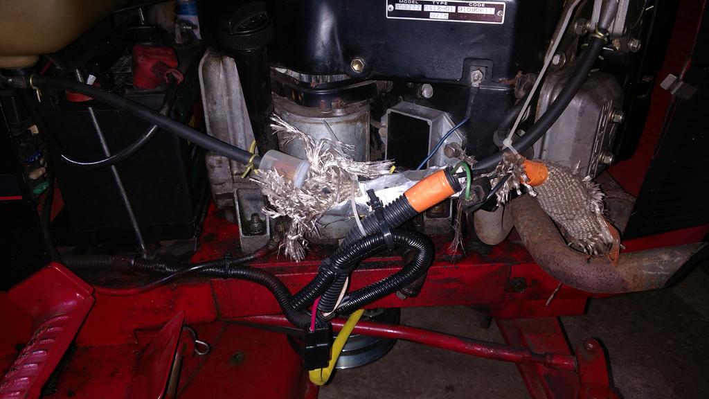

Sparky-(Admin) 26,333 #18 Posted May 7, 2018 So I gotta ask....what is that next to the starter that looks like a birds nest? And what's right above the exhaust in your pic? Share this post Link to post Share on other sites
CountryRock 199 #19 Posted May 7, 2018 17 minutes ago, Sparky said: So I gotta ask....what is that next to the starter that looks like a birds nest? And what's right above the exhaust in your pic? That is some heat-proof fabric that is wrapped around the fuel lines and some wiring. Share this post Link to post Share on other sites

WHX?? 58,084 #21 Posted May 9, 2018 Yes and engagement is much smoother. On 5/6/2018 at 10:35 PM, CountryRock said: That is some heat-proof fabric that is wrapped around the fuel lines and some wiring. Mine doesn't have any thing in that area like yours. Have to get some pics Share this post Link to post Share on other sites
CountryRock 199 #22 Posted May 9, 2018 Added the fabric ourselves. Mainly on the fuel lines. The only wires there are the voltage regulator wires and pto clutch wire. Share this post Link to post Share on other sites
CountryRock 199 #23 Posted May 10, 2018 8 hours ago, WHX17 said: Mine doesn't have any thing in that area like yours. Have to get some pics Here's a close up. Share this post Link to post Share on other sites
Vinylguy 4,796 #24 Posted February 11, 2019 Got a 246-H headlight bezel from A-Ztractor After several tests and adjustments to the template I have been able to complete the 1990 246 hood sets. Even though the vertical shaft tractors are not popular for restoring I have had a few requests. This is everything I have for the 246-H so far 1 1 Share this post Link to post Share on other sites
