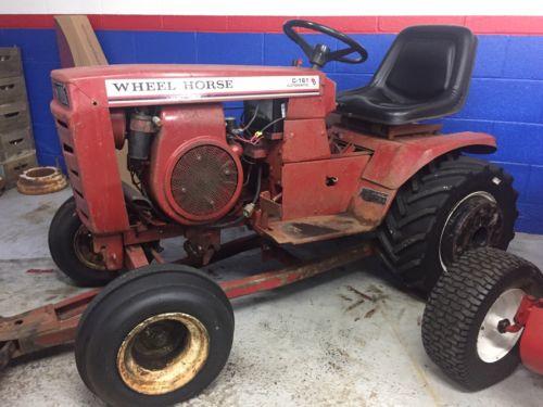

I'm thinking of picking up a WH or two for snow removal.
This C-161 is local to me.
Is there anything in particular I should check for if I go to check it out?

A 161 is great tractor and a beast. Real favorite of many here and on my bucket list as well. Seller is right about the price of the tires. Those look to be Tru-powers on the rear and if they 23-10.5 are a buck & a quarter+ each . Looks to be in decent shape but check the transmission for strongness. Ask the seller if he'll run up to a tree and see if the tires spin. Check the fluids for off color or smell. Check for how well it's been taken care of but looks good that way from here.  I am not a fan of tri-ribs for moving snow but dirt... you bet! That tractor would move piles of gravel all day without missing a beat.  I would be all over that tractor for that price if things checked out! :)
Good luck!

Does the hydro need to be HOT for this test, or just a few minutes of run time?

The engine and transaxle should be warmed up a couple of minutes prior to attempting to push down a tree. Be sure to do this in both directions.

:text-bravo:Looks like a great tractor to me, I had one a few years back with a loader and it was very strong. If you get it, you will love it. It looks to me like the tires are worth almost the asking price.:twocents-02cents:

Steve_O
Two offenses in three posts, that's not bad, right?    I didn't realize the links were not allowed.
For reference here is a photo from the original add
