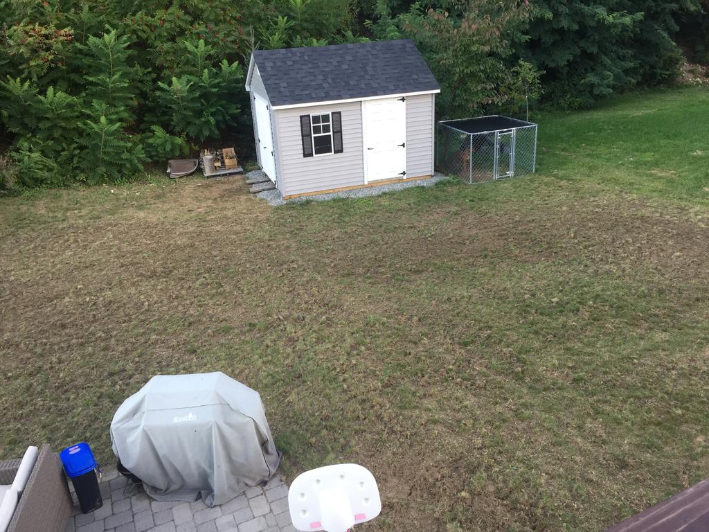

Today was the day to start redoing my yard. It's been embarrassing me since we moved in May. The sub-development we live in was a sand pit in its former life. They contractors layed down 2" of topsoil down, sprayed some hydro seed down and called it a day.

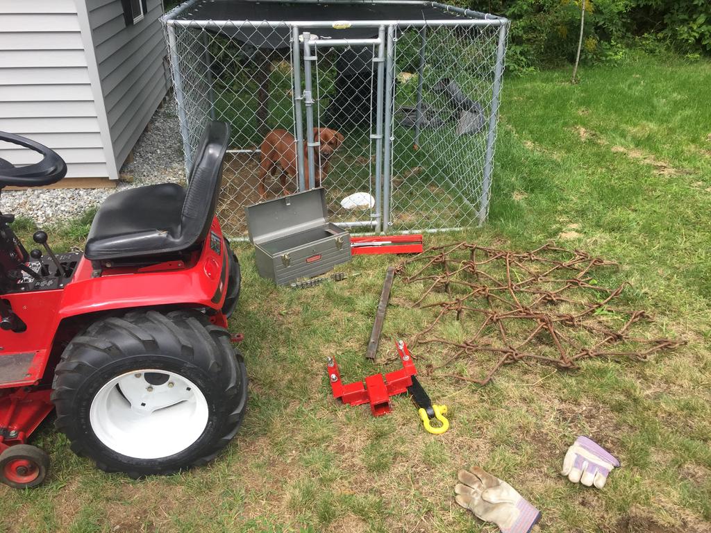

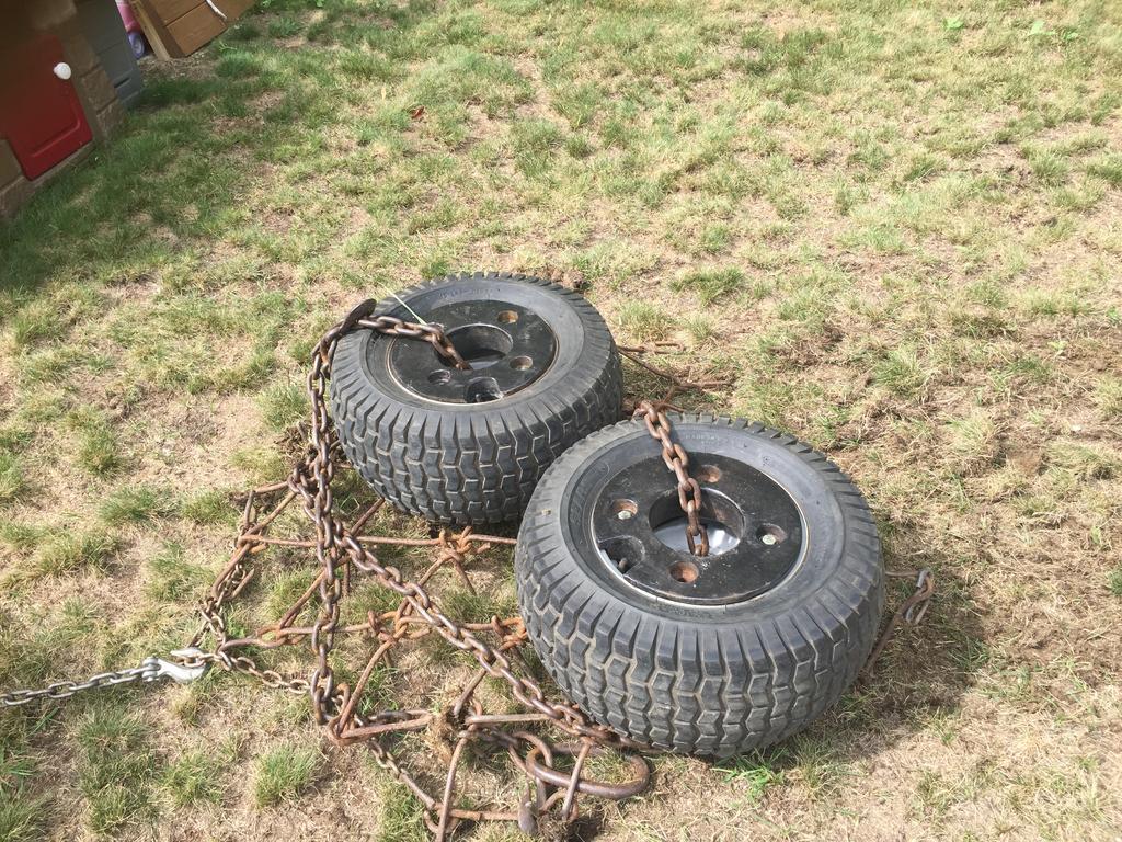

I borrowed half of an old drag harrow from work. Missing the front bar so didn't work perfectly but good enough for my purpose.

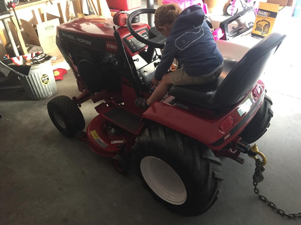

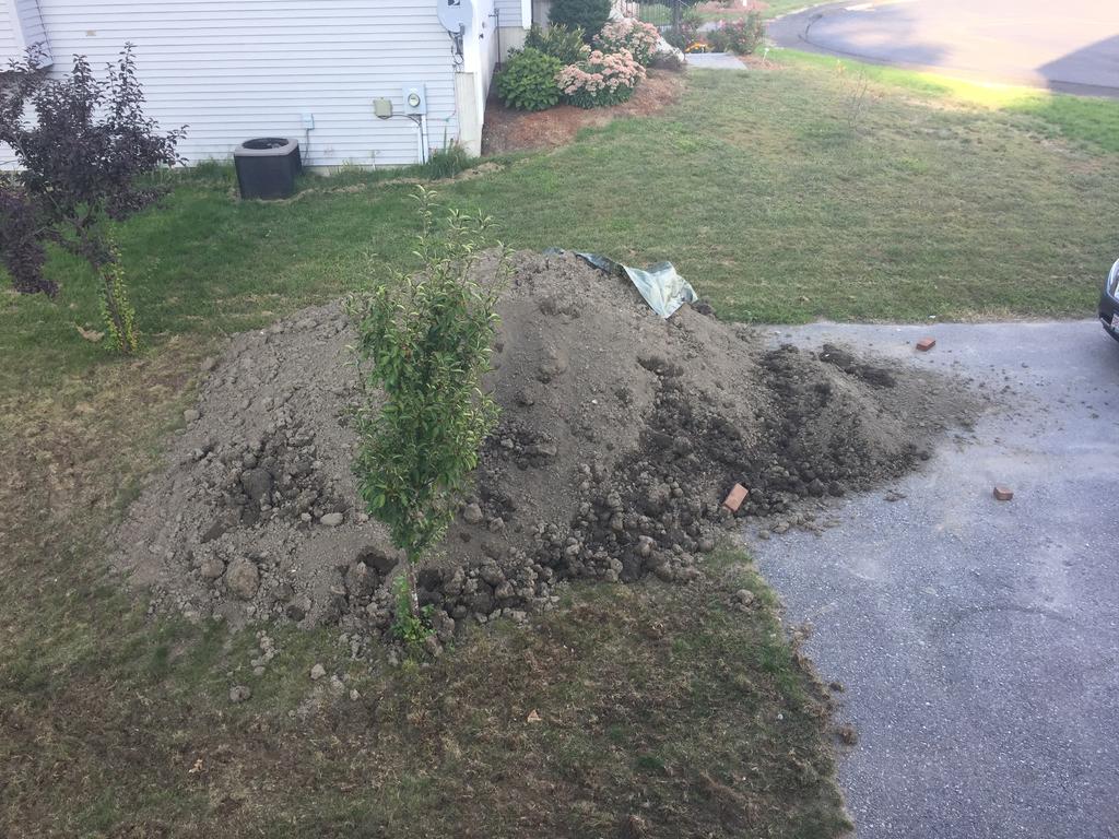

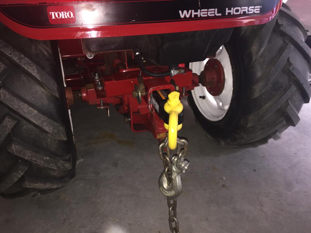

Hooked up my 2" receiver on, a shackle and chain hooked up to another chain on the drag. I pulled it along but it wasn't digging in like I wanted. I a spare set of rear wheels with 100lbs of cast iron on them, chained them to the drag. All said it was over 200lbs. Worked great 👍. I ran it 2 low only because 1 high pulled a little fast. Pulled all that weight with 2" spikes angled into the ground up hill with ease. Still have to rake the back then spread 16 yards of loam

elcamino/wheelhorse
I like you help on the tractor . Good job.
Sparky
Once your neighbors see your nice lawn I bet you hit up to work theirs!
  Nice job.

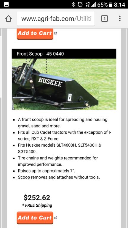

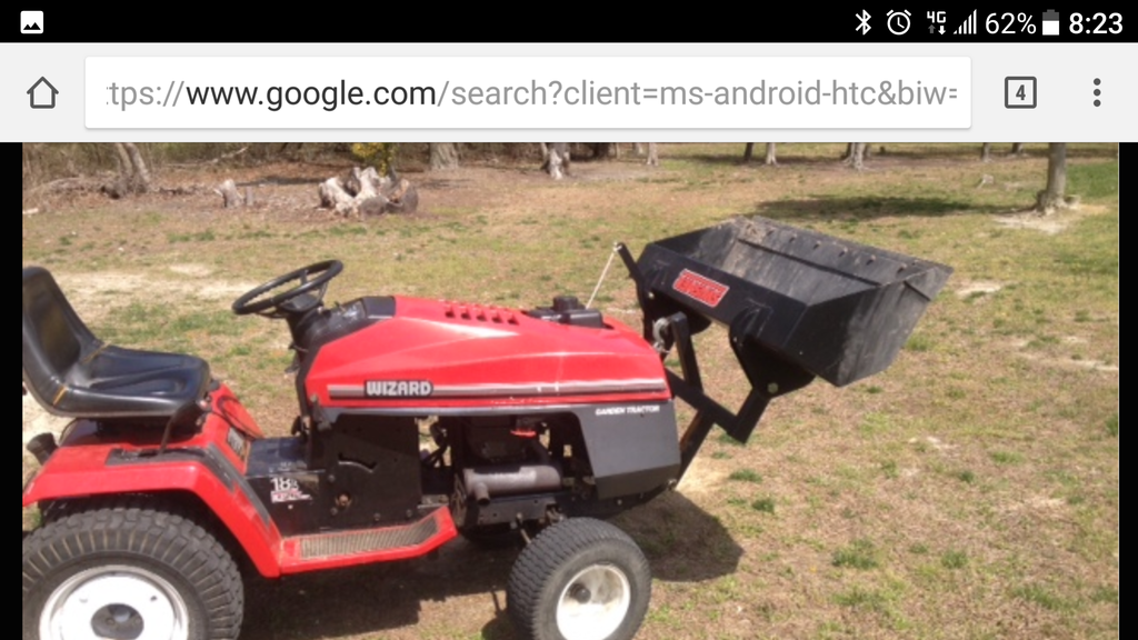

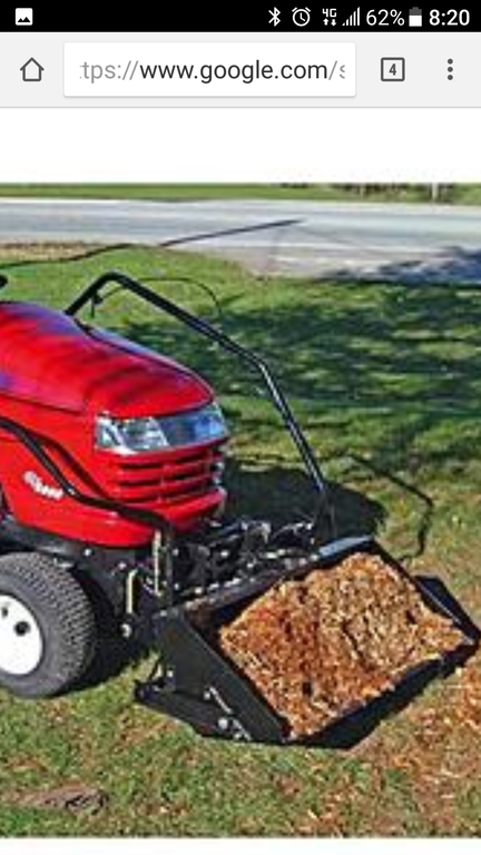

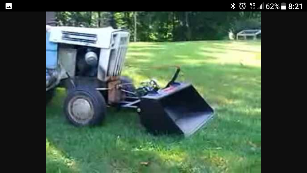

Loaders are a great thing to have (as I have 2 compact 4x4s with FEL), but I was going to adapt a Swisher or Agri-fab brand Johnny Bucket to my 520 years ago, it would still beat a shovel and wheel barrow or cart, Jeff.
Red144runner
Wow that's cheaper than I thought! I'll have to look into one
