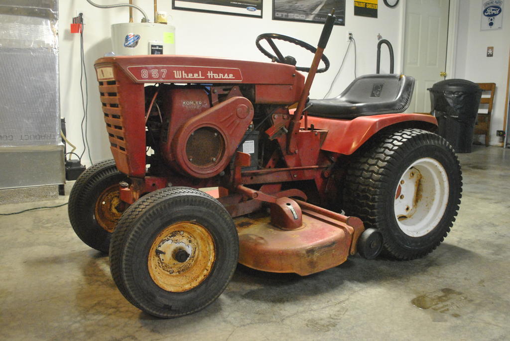

Horse Play 393 #1 Posted September 8, 2017 Hello all, I just bought an 857 that I will be using for mowing and am wanting to do a cleaned-up, patina look for the tractor. I've already been using wax to remove oxidation from the paint and is looking a little better. But I am debating about how I want to go about removing rust and painting the wheels. On my last restoreI had the wheels sandblasted followed by coats of primer. Then I had the tires mounted, but did not seat the beads. I masked off the tires, painted the wheel faces, and then seated the beads after the paint cured. This worked well, but was time consuming. Seeing how this is a worker and I am thinking about keeping the original tires, does anyone have any tips that could make this an easier job? Thanks for any help. 2 Share this post Link to post Share on other sites

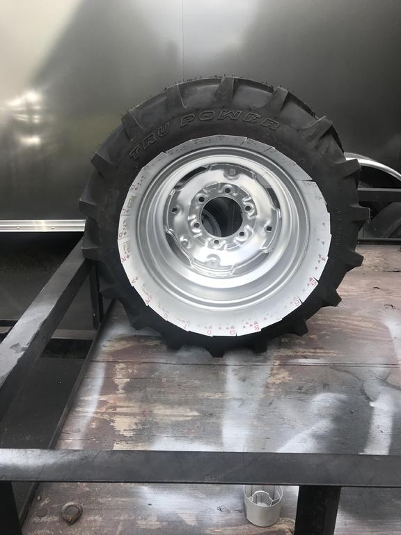

ACman 7,700 #10 Posted September 8, 2017 I think seen where @AMC RULES had used a needle scaler on his front rims on his 1056 http://www.wheelhorseforum.com/topic/71537-painting-wheels/?tab=comments#comment-679445 . Here's another good tip from @chris sutton http://www.wheelhorseforum.com/topic/68387-rear-wheel-referb/?tab=comments#comment-646627 . Use a deck of cards or note cards to go between the rim and tire all the way around. Saves you from masking off the tire . Lastly if you want to save those front tires try some RuGLYDE on them . If you go the new tire route, sell those tires here in the classifieds as they look like brand. I know I need at least one . Could help you offset some of the cost of the new tires. This forum is full good ideas. All I did was use the search box , selected "this forum" and typed in cards and hit search to find these two links. Try typing in painting wheels and I bet there's a ton of threads on this subject. Hope this helps. 1 1 Share this post Link to post Share on other sites
Aldon 4,832 #11 Posted September 9, 2017 I had already primed and painted the inside of rims but can't seem to mount without scratching them so once I mounted I used the card trick on partially deflated mounted tires to put finish coat on the rims. So a hybrid of some of the methods above. 4 Share this post Link to post Share on other sites
JPWH 6,542 #12 Posted September 9, 2017 I use the same method Alcon does but my paint skills are not great so I use cardboard. I cut a 12" hole or 8" for fronts then split in half and slide in under rim. The whole tire is covered. 2 1 Share this post Link to post Share on other sites
