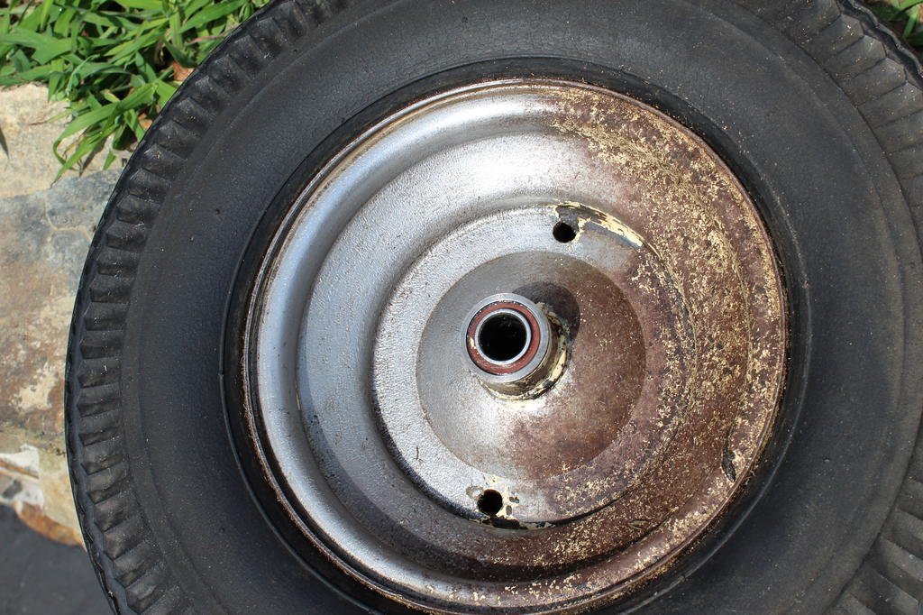

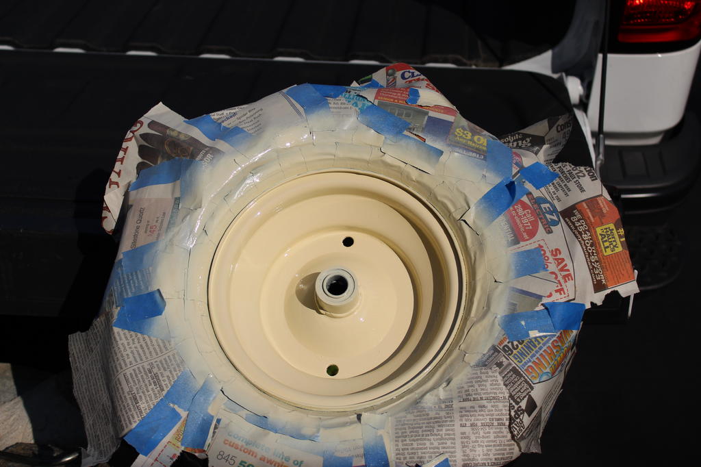

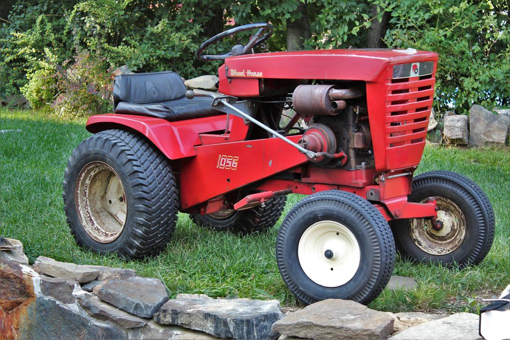

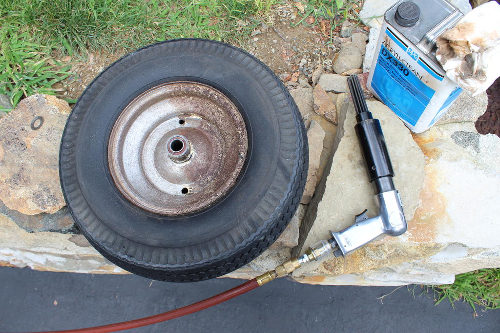

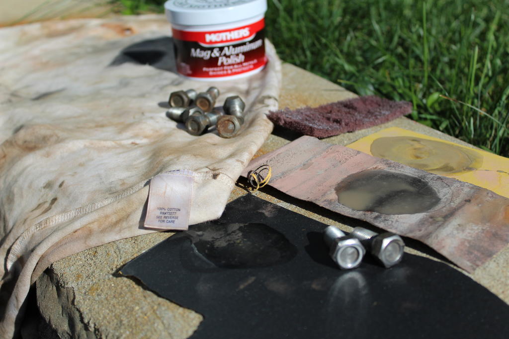

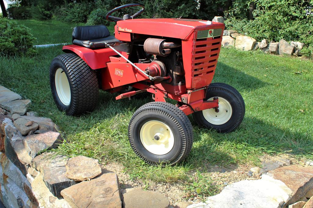

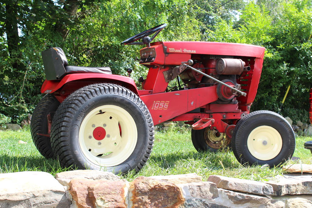

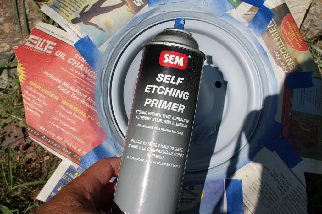

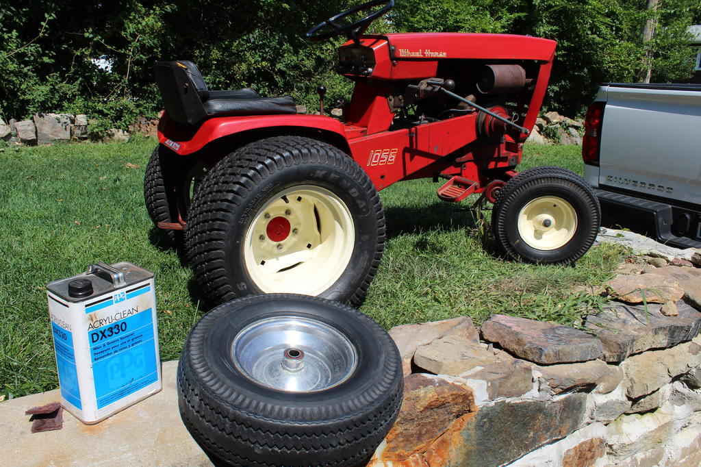

AMC RULES 37,256 #7 Posted August 12, 2017 (edited) Actually, I started on my "new" 1056's rims today... was using this new tool I've recently added to my arsenal. A while back, a few of the retired navy guys were at work sharing old war stories... mentioned using an old school needle guns back in the day, to remove rust & scale on ships while at sea. Figured, what the hey... I'd try an Ebay search for a cheap used one... found&bought a band new one for a good price, was kinda surprised when two of 'em showed up in the mail. Anyway, like I said...gave it a shot today, & it made short work of that nasty old rust too. Figured it take the whole process on one, from start to finished to share here with the forum. Pretty impressed with the ease of use, and final product. Only three more to go now. Edited August 12, 2017 by AMC RULES 7 5 2 Share this post Link to post Share on other sites
DennisThornton 4,773 #8 Posted August 13, 2017 3 hours ago, AMC RULES said: Actually, I started on my "new" 1056's rims today... was using this new tool I've recently added to my arsenal. A while back, a few of the retired navy guys were at work sharing old war stories... mentioned using an old school needle guns back in the day, to remove rust & scale on ships while at sea. Figured, what the hey... I'd try an Ebay search for a cheap used one... found&bought a band new one for a good price, was kinda surprised when two of 'em showed up in the mail. Anyway, like I said...gave it a shot today, & it made short work of that nasty old rust too. Figured it take the whole process on one, from start to finished to share here with the forum. Pretty impressed with the ease of use, and final product. Only three more to go now. How long to just remove the rust? 1 Share this post Link to post Share on other sites
AMC RULES 37,256 #9 Posted August 13, 2017 The first pict, showing the needle gun... took maybe 5 mins, or less. 3 1 Share this post Link to post Share on other sites
pacer 3,179 #10 Posted August 13, 2017 I use 'sand' blasting and danged if that doesnt look every bit as good as a blasted rim!! I've long heard of a needle gun but never been around one -- this just might have me doing a search for one!! Probably worth asking for the benefit of the guys that dont have a big compressor - I would imagine it likes a lot of air?? as most air tools do... 2 Share this post Link to post Share on other sites
cschannuth 3,821 #11 Posted August 13, 2017 40 minutes ago, AMC RULES said: The first pict, showing the needle gun... took maybe 5 mins, or less. Can it damage the tire if the needles hit the rubber? Share this post Link to post Share on other sites
AMC RULES 37,256 #12 Posted August 13, 2017 32 minutes ago, pacer said: I use 'sand' blasting and danged if that doesnt look every bit as good as a blasted rim!! I've long heard of a needle gun but never been around one -- this just might have me doing a search for one!! Probably worth asking for the benefit of the guys that dont have a big compressor - I would imagine it likes a lot of air?? as most air tools do... I've only got a 150psi Craftsman, with a small 33 gal tank. Compressor cycled 4-5 times in the process of doing both sides of this rim. 5 minutes ago, cschannuth said: Can it damage the tire if the needles hit the rubber? While, I didn't concentrate the pack of needles directly on the rubber... I did lightly hit the area around the valve stem, and lip around the bead. Using only one, or two of the individual needles...not noticeable damage occurred to my eye. 3 Share this post Link to post Share on other sites
DennisThornton 4,773 #13 Posted August 13, 2017 I've blasted many an hour and it's rusts worst enemy. But I don't have that big air compressor now... However I did buy a needle scaler years ago but it still needs more CFMs than a have... Share this post Link to post Share on other sites
cschannuth 3,821 #14 Posted August 13, 2017 It looks like northern tool has an inexpensive unit with mostly good reviews. It seems like it might hold up well enough for the occasional user. Share this post Link to post Share on other sites
squonk 46,095 #15 Posted August 13, 2017 I have the HF Needle scaler + I got a box of extra needles. One of the best tools I have ever bought anywhere. I wear eye and ear protection and have at it. It's great for frames too. DO NOT USE ON SHEET METAL!!!!! + 3 1 Share this post Link to post Share on other sites
953 nut 65,201 #16 Posted August 13, 2017 8 hours ago, pacer said: I've long heard of a needle gun but never been around one I guess the Air Force didn't wand a million little dents on the wings of the air craft! I remember them (not fondly) from my Navy days. 2 Share this post Link to post Share on other sites
Ed Kennell 45,732 #17 Posted August 13, 2017 We used the large pneumatic needle scalers for cleaning hydro turbine parts when shot blasting was not practical. Both processes were noisy and dirty but with long periods of use, the needle scalers had a reputation for causing carpal tunnel problems. Share this post Link to post Share on other sites
Sarge 3,470 #18 Posted August 13, 2017 Needle scalers can remove some serious stuff , but be aware they leave a pretty rough surface . Almost all air hammers use the same threaded nose on them and Ingersoll Rand makes an add-on needle scaler - some TSC stores carry it in stock , I think around $40 . I use one on mine for cleaning old crusty welds and rusted metal prior to welding , they work wonders but if you want a smooth paint finish you'll have to follow up with some metal sanding or build up a heck of a lot of primer . https://www.tractorsupply.com/tsc/product/ingersoll-rand-needle-scaler-attachment Biggest use around here is cleaning slag off large diameter (5/32") 6011 welds in tight spots . Sarge 1 Share this post Link to post Share on other sites

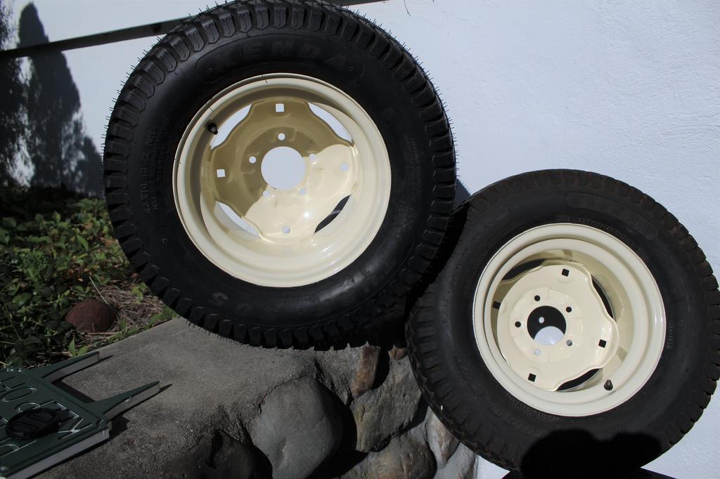

AMC RULES 37,256 #22 Posted August 20, 2017 Slowly making some progress. As of today, only one more to go... 4 Share this post Link to post Share on other sites
19richie66 17,858 #23 Posted August 20, 2017 Very nice Craig! 1 Share this post Link to post Share on other sites
AMC RULES 37,256 #24 Posted August 20, 2017 Thank you Rich... was finally able to make the big push today...and got that last one done. 5 Share this post Link to post Share on other sites
