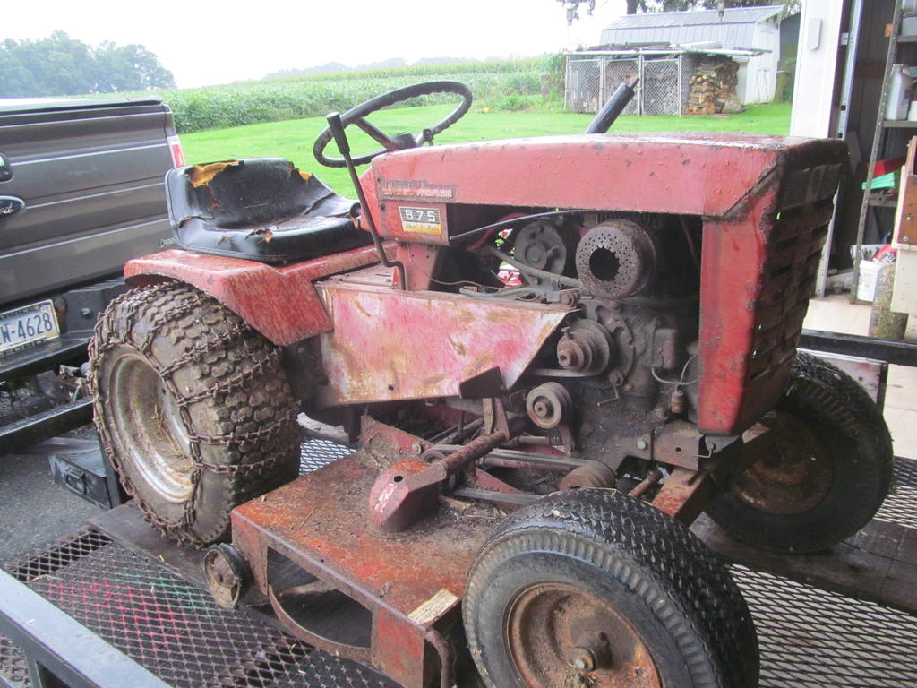

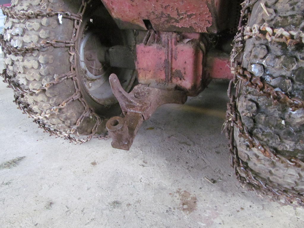

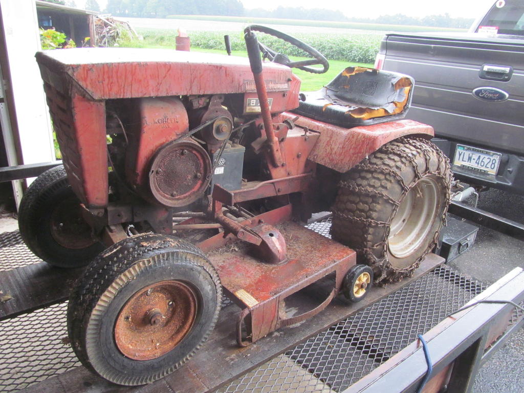

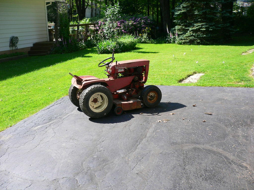

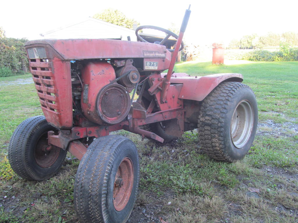

Ed Kennell 47,248 #1 Posted September 6, 2017 I saved this jewel from the scrap yard this morning. About a 30 minute trip and 20 minutes of that was backing the trailer up a very winding steep driveway. Has a fairly good deck shell and the gears and spindles feel OK. Plus a sleeve hitch with a pin that is actually free in the transmission. And 2 link vee bar chains. 18 9 Share this post Link to post Share on other sites

Ed Kennell 47,248 #6 Posted September 6, 2017 41 minutes ago, wfrpalm said: Nice save. Here's mine Looks good, but I can't help myself......is the recliner seat original or is that a special order option?? 2 hours ago, Wishin4a416 said: Good save Ed.. The deck looks to be Ok from the pics. Thanks Jack. The gears and spindles seem OK, but the cast iron spindle support plate has the standard crack. The shell has a little rot between the deck support angles, but not bad for over 50 years of mowing. 2 Share this post Link to post Share on other sites

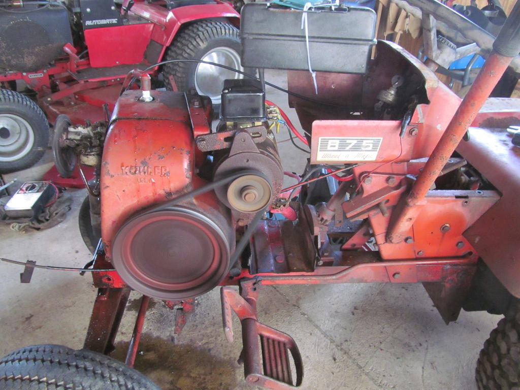

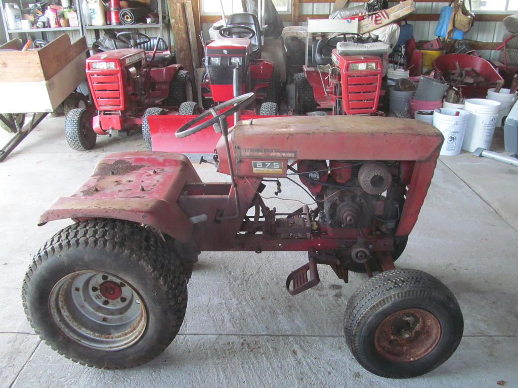

Ed Kennell 47,248 #11 Posted September 7, 2017 Gave the little horse a much needed bath. And he is finally inside a warm dry barn with other horses. Next step.....see if we can find some fire ..... there was a coil under all the grease and dirt. The muffler repair may be a challenge ..... I'm thinking STACK. 7 Share this post Link to post Share on other sites
AMC RULES 37,259 #12 Posted September 7, 2017 Like night & day the difference Ed. 1 Share this post Link to post Share on other sites
953 nut 69,101 #13 Posted September 8, 2017 Your other horses seem to be checking out the new member of the herd! All standing there staring at him. 2 1 Share this post Link to post Share on other sites

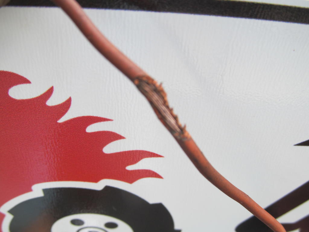

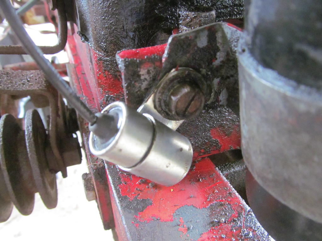

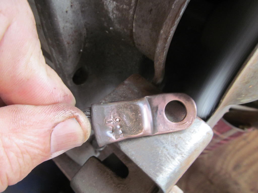

Ed Kennell 47,248 #14 Posted September 8, 2017 Well, I think I found the reason this horse was parked many years back. This is the ignition wire from the switch to the coil. rubbed bare where it went thru the hood stand hole behind the fuel tank. I replaced the bad wiring and cleaned all the terminal connections. Put on a new plug, and cranked it over..... no fire. Installed a new condenser and the plug lit up. Hung a gravity fuel tank, primed her with starting fluid, hit the start switch and she couldn't wait to run. No smoke and no unusual noises. She's alive. 4 5 Share this post Link to post Share on other sites

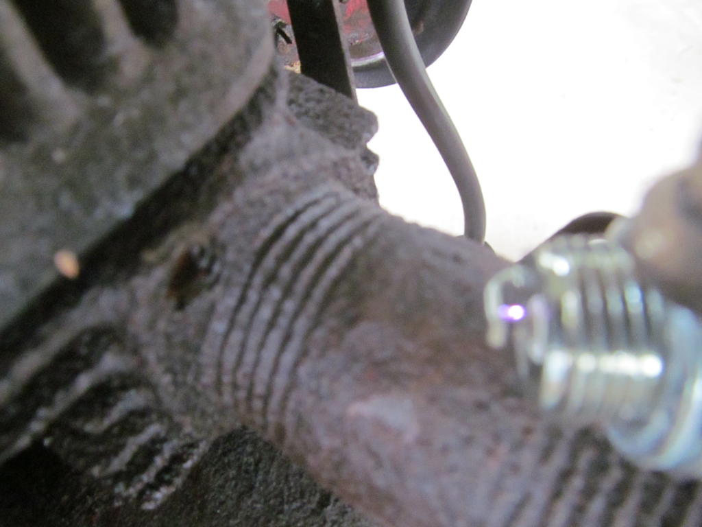

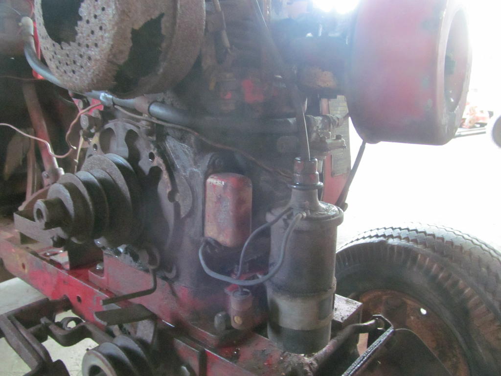

Sarge 3,473 #17 Posted September 9, 2017 Did you actually catch a pic of the spark jump ?? That's about 1 in a million there... Crazy how it's the smallest of things , like a simple wire or condenser that people park these , many to sit and rot for eternity . Sarge 1 Share this post Link to post Share on other sites

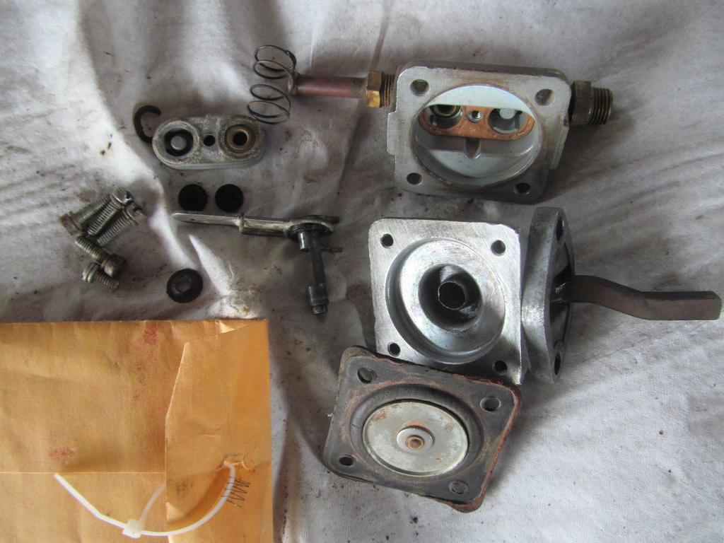

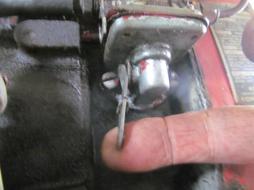

Ed Kennell 47,248 #19 Posted September 9, 2017 16 minutes ago, Sarge said: 25 minutes ago, Sarge said: Did you actually catch a pic of the spark jump ?? That's about 1 in a million there... Yes I did Sarge. It's really not difficult with a manual camera. Just set the lens to stay open long enough to span one rev. It does cause the out of focus though. Crazy how it's the smallest of things , like a simple wire or condenser that people park these , many to sit and rot for eternity . So true... In most cases these neglected tractors can be running with very little effort. 10 minutes ago, WHX12 said: How does the tranny look Ed? It has been converted from ATF to OIL and the oil looks and smells good. It rolls easy with the tow valve open and plenty of resistance with the valve closed. So I think it is good Jim. As soon as I get the fuel system back together, I will hook her to a tree and check the tranny. I do have a question on the fuel pump. It has a hand priming lever. I have never seen this on other pumps. Was this stock issue? Share this post Link to post Share on other sites
WHX?? 58,048 #20 Posted September 9, 2017 A buddy that works at Kohler told me some engines were speced with the primer lever and it is thought that inventory was low that day on the assembly line of non primer ones so a few of our engines got them. Also possible tha the wrong lot got put out on the line by mistake. He said that still happens in this day of computer inventory control. 2 Share this post Link to post Share on other sites
953 nut 69,101 #21 Posted September 9, 2017 1 hour ago, WHX12 said: A buddy that works at Kohler told me some engines were speced with the primer lever and it is thought that inventory was low that day on the assembly line of non primer ones so a few of our engines got them. Also possible tha the wrong lot got put out on the line by mistake. He said that still happens in this day of computer inventory control. Seems to be a 1965 and earlier item, very handy to have for any engine that sits for a few days. 2 Share this post Link to post Share on other sites
Ed Kennell 47,248 #22 Posted September 9, 2017 (edited) I couldn't resist taking this somewhat rare pump apart. It was in amazingly good condition. The only problem was a torn seal on the primer shaft. The diaphragm and valves look good. I planned to make a seal and put it back together until I picked up one of the tiny valve springs with my numb arthritic hand. Yep, I dropped it never to be found again. Maybe ACE hardware or the local clock repair guy will have one. Edited September 9, 2017 by Ed Kennell 3 Share this post Link to post Share on other sites
WHX?? 58,048 #23 Posted September 10, 2017 Try a magnetic floor sweeper for that spring.....crunch.......never mind, I see you found it! Looking for things I dropped on the barn floor.....there a year of my life I'll never get back! 3 Share this post Link to post Share on other sites
Ed Kennell 47,248 #24 Posted September 10, 2017 I didn't find it Jim. That's the other one tied to the envelope. I did try a magnet, then swept the floor and sifted thru the dust. 1 2 Share this post Link to post Share on other sites
WHX?? 58,048 #25 Posted September 10, 2017 Oh I see it now ...I was looking at the bigger spring at the top but that's for the diaphragm. I'm thinkin that's looks awful like a gas valve regulator spring that might work?? @ACman will know what I'm talking about. Let me know if you can't source one local I'll send you a handful to try or might have one in the fuel pump parts bin as well. 3 Share this post Link to post Share on other sites
