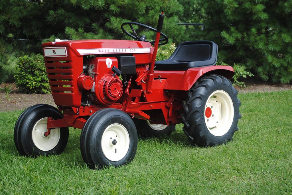

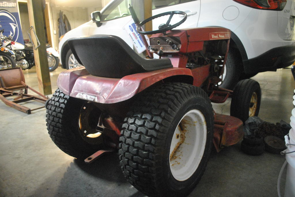

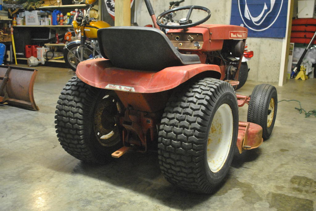

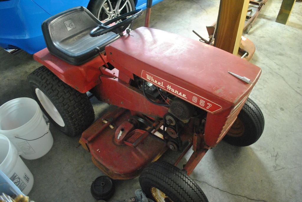

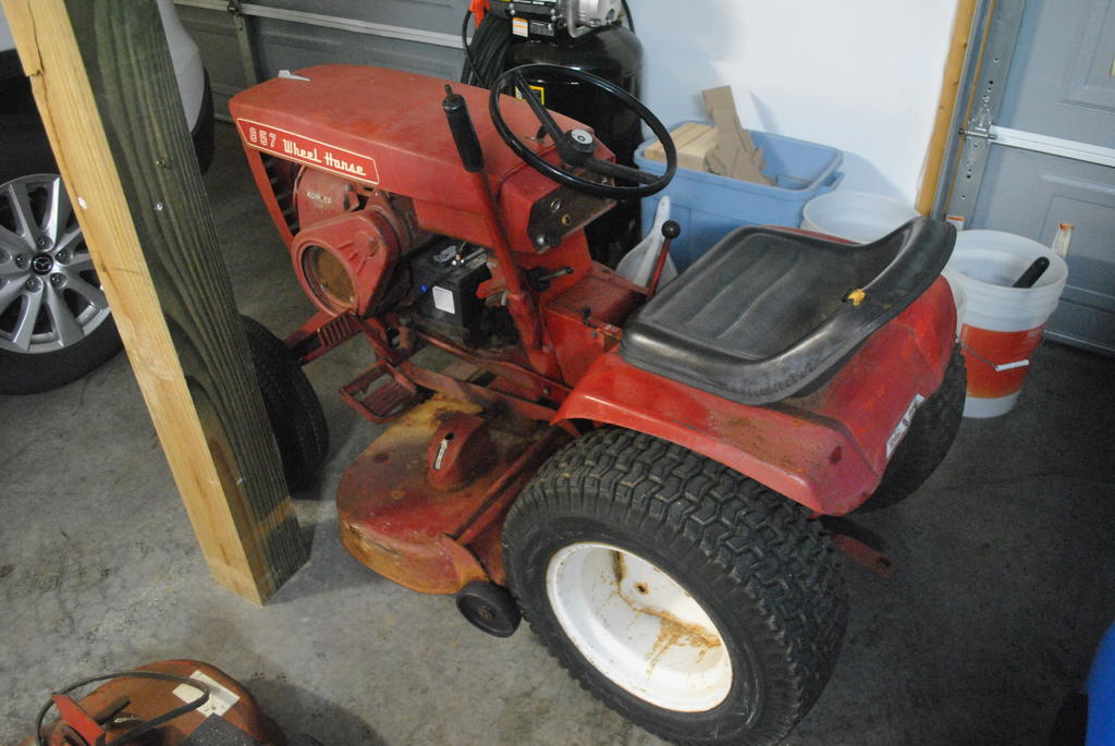

Horse Play 393 #1 Posted September 1, 2017 (edited) Back in 2012 I bought a Work Horse 700 from a friend. It was not running with a newer 8HP Techumseh retrofitted. I got it running and mowed with it a little bit before I ripped it apart and did a full restoration. The tractor turned out so beautiful I did not want to use it. So it sat in the garage for two years until I sold it and put the money towards a Harley. So I went the last two years without a tractor. I recently shopped around looking at John Deere X300-series tractors and really liked what I rode, but did not want to pay that much money. Last weekend my friend went to a show in Portland, Indiana and brought me a tractor. I am now the proud owner of a 857! I was intending on having a B or C series, but I could not resist another short frame. It runs and mows great. It appears to be very complete and originally, but could use some cleaning up. Somebody brushed paint all over and it is driving me crazy! It also came with a plow, rear lift, and the original cigar lighter. My plans are to remove the brushed-over paint to reveal the original patina, new tires and wheel paint, redo the dash, and some other new parts. The original deck works well, but is rotted in the from center - so I need to find a new deck. My friend picked up another deck, but it is not the same and does not look usable. What deck do I have mounted on the tractor, is it a 5-1362? Edited September 1, 2017 by Horse Play 10 1 Share this post Link to post Share on other sites

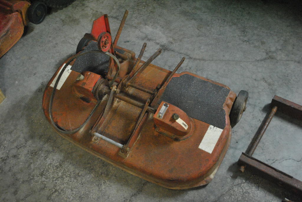

oldredrider 2,553 #2 Posted September 1, 2017 That deck appears to be for a Lawn Ranger. 1 Share this post Link to post Share on other sites

Retired Wrencher 6,910 #4 Posted September 3, 2017 (edited) Horse Play Just my but I would just clean it up to see if you have any leeks and buff it out. Looks good the way it is. These work great on these old cables just put some shrink tubing over the old casing it will work real smooth. these are called cable lubbers you use a can like Wd40 or anything with a short tube that fits on the nozzle. Enjoy the project. Edited September 3, 2017 by Retierd Wrencher Share this post Link to post Share on other sites
Horse Play 393 #5 Posted September 3, 2017 (edited) I guess it's earned the patina after 50 years of work. I tried some hand buffing yesterday and it helped a little bit. This winter I'm planning on sandblasting and painting the wheels along with new tires. Also want to do a dash decal and a Michigan seat. Keep it as a clean looking worker if that's such a thing. Are you recommending the cable luber for the choke and throttle cables? I use one on my motorcycles; I never thought about the tractor cables. Edited September 3, 2017 by Horse Play Share this post Link to post Share on other sites

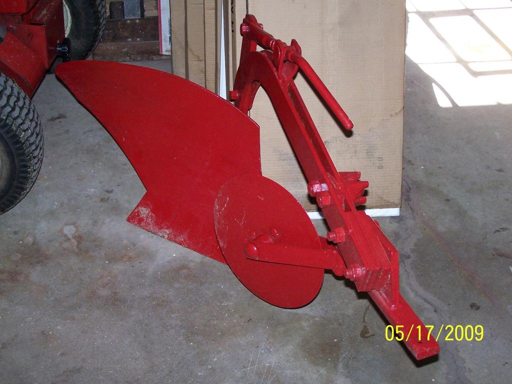

Horse Play 393 #6 Posted September 8, 2017 Could someone please tell me what kind of hitch this is? What types of implements is it for? Is it supposed to lower and lift via cable with the tractor's center lift arm? 2 Share this post Link to post Share on other sites
953 nut 68,343 #7 Posted September 8, 2017 That is a slot hitch and will lift with the cable attached to the center lift point. You can use it for a turning plow, disc, cultivator and other equipment. 1 Share this post Link to post Share on other sites
elcamino/wheelhorse 9,363 #8 Posted September 8, 2017 It is a sleeve hitch , you can purchase an adapter from one of the vendors to accept clevis hitch implements. Share this post Link to post Share on other sites

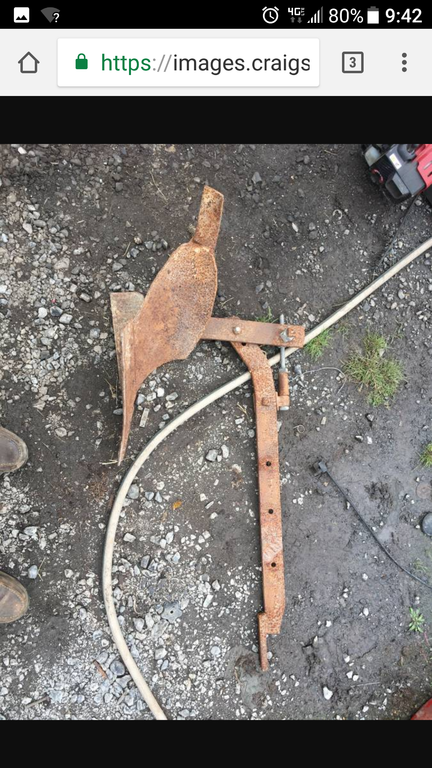

WVHillbilly520H 10,379 #11 Posted September 8, 2017 12 hours ago, 953 nut said: There's an un restored version for sale near me for $100, too much for what you see? Jeff. Share this post Link to post Share on other sites
953 nut 68,343 #12 Posted September 8, 2017 59 minutes ago, WVHillbilly520H said: un restored version for sale near me for $100, That seems to be the going price these days. 1 Share this post Link to post Share on other sites
Horse Play 393 #13 Posted September 9, 2017 I got lucky today! I posted the Lawn Ranger deck for sale or trade on CL this week and was able to trade it today for another 36" RD deck. The guy I traded with had a Lawn Ranger with no deck, so it worked well for both of us. Hopefully this week I will start a teardown and begin a deck restoration over the winter. 3 Share this post Link to post Share on other sites
