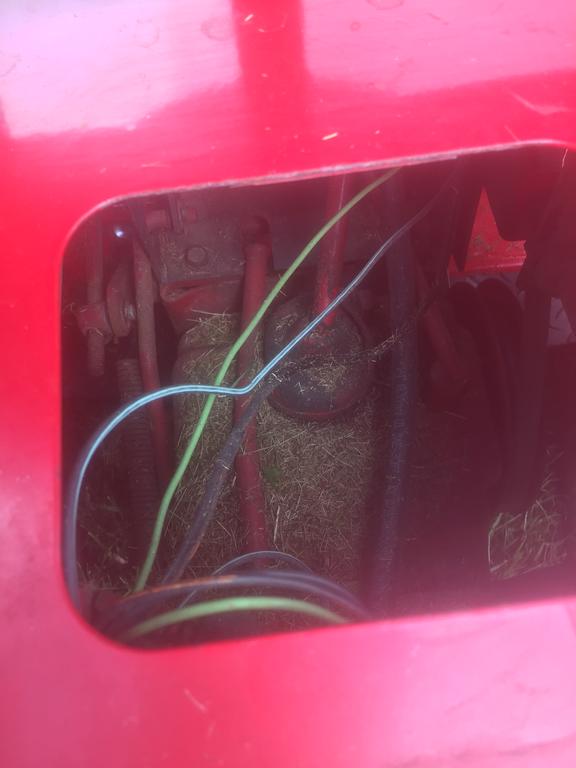

TimH 105 #7 Posted September 9, 2017 I am sure glad I read all this . Trans was filled with diff fluid and water. Looked like baby pu. drain the best I could . Then blew out with air, Then flushed with D- Fuel , Lifed up front and right side rear, Let drain then used vac brake bleeder to pump out the rest. All is good. Installed new shiftier boot 2 Share this post Link to post Share on other sites
