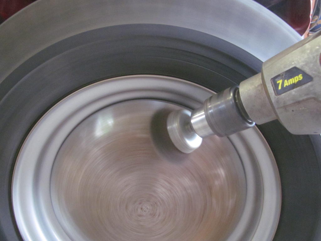

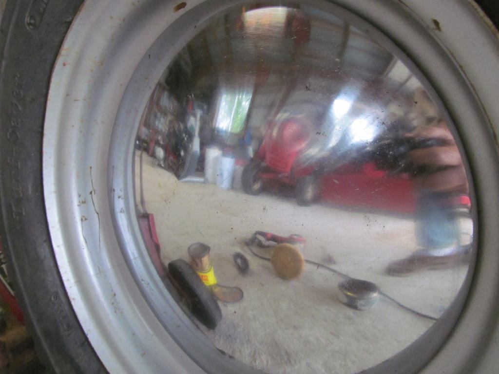

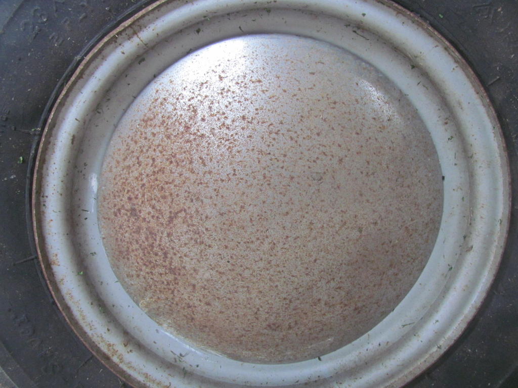

Ed Kennell 46,196 #1 Posted August 29, 2017 (edited) Polished the moons on the 417 today. Before Jacked up the one side and spun the cap while wire brushing and then buffing with rubbing compound. after Edited August 30, 2017 by Ed Kennell 11 7 Share this post Link to post Share on other sites
elcamino/wheelhorse 9,363 #2 Posted August 29, 2017 Ed , that is using you head and reducing the amount of work. The hub caps look great! 1 Share this post Link to post Share on other sites
rjg854 13,072 #3 Posted August 29, 2017 Would a clear coat finish keep you from having to do that for a while? Looking right nice 2 Share this post Link to post Share on other sites

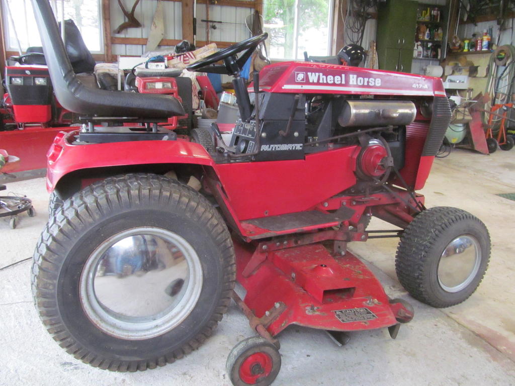

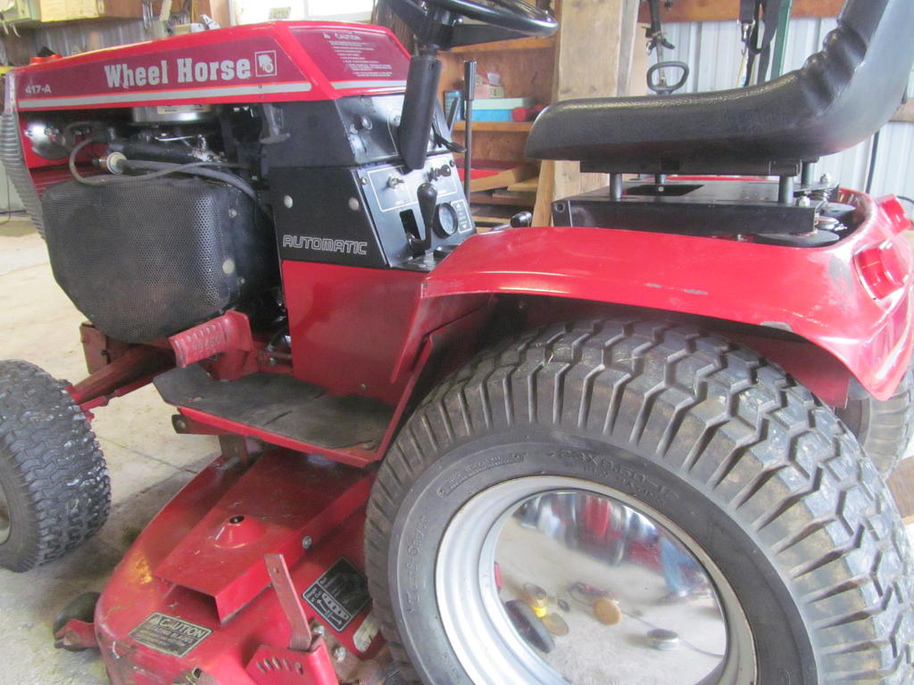

roadapples 6,987 #4 Posted August 29, 2017 Looks good Ed, but what's that seat floating on... Share this post Link to post Share on other sites
elcamino/wheelhorse 9,363 #5 Posted August 30, 2017 Ed , You were showing us how to polish hub caps and @roadapples looks at the seat. Think he is more interested in comfort than work. 3 1 Share this post Link to post Share on other sites
Ed Kennell 46,196 #6 Posted August 30, 2017 (edited) 20 minutes ago, roadapples said: Looks good Ed, but what's that seat floating on... I had to flip the seats tilting base plate over to clear the sliding seat adjusters locking lever. That exposed the four spacers that are normally hidden by the vertical sides of the base plate. Those two rubber bumpers are parts of a boat trailer roller. 13 minutes ago, elcamino/wheelhorse said: Ed , You were showing us how to polish hub caps and @roadapples looks at the seat. Think he is more interested in comfort than work. It actually took more time to fix the seat than polish the hub caps. The slide rails and bearings were locked up with rust and hadn't worked for a long time. Edited August 30, 2017 by Ed Kennell 2 Share this post Link to post Share on other sites
