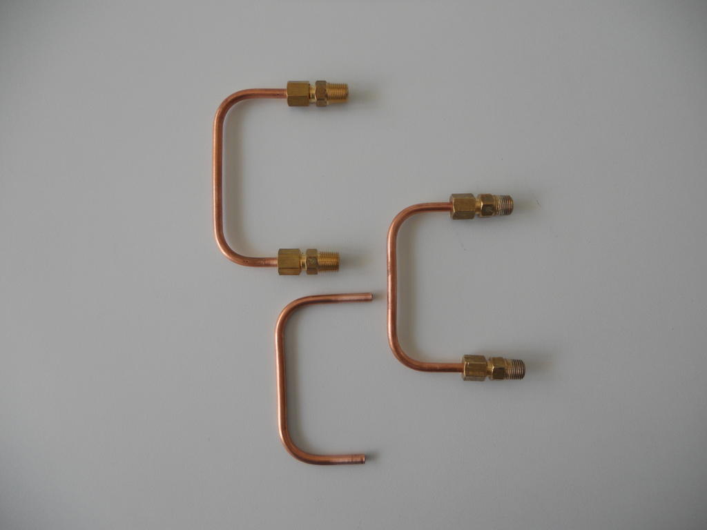

Mill Rat 14 #1 Posted August 29, 2017 Does anyone know what the standard o-ring designation is for the o-rings that Kohler used on a hard pipe fuel line between the fuel pump and the carb on the small displacement (mine's a 1966 vintage 181S), or who might sell them? Share this post Link to post Share on other sites
R. L. Addison 300 #2 Posted August 29, 2017 I cut off a piece of three sixteenths windshield washer hose for the ones i need, in a pinch as they are square cross section. As far as using an O-ring, the main requirement to my way of thinking would be the largest cross section, that would fit the tube and go inside the nut. I have never found three sixteenths fuel line, and the windshield washer hose has not failed me yet. 1 Share this post Link to post Share on other sites
Racinbob 12,996 #3 Posted August 29, 2017 It pretty easy to make new lines using tubing and std. compression fittings. 5 Share this post Link to post Share on other sites
Mill Rat 14 #4 Posted August 30, 2017 The copper lines are a good idea, though I've always used flare fittings for any fuel connections which don't have elastomeric seals. Share this post Link to post Share on other sites
953 nut 66,589 #5 Posted August 30, 2017 Here is a link to the fittings you want. https://www.mcmaster.com/#standard-single-sleeve-compression-tube-fittings/=195ooft For Use With: Diesel Fuel, Cutting Oil, Petroleum Temperature Range: -30° to 250° F Tubing: Use with Seamless Steel Specifications Met: DIN 3861 The sleeve (ferrule) is made of Buna-N rubber instead of metal, so it cushions the tubing and absorbs vibration. In addition to the sleeve, the fittings include a nut with a gripping ring that bites into the tubing for a secure hold. They are also known as flareless fittings. They provide good strength and durability in noncorrosive environments. Fittings with male threads have an O-ring to protect against leaks. Fittings with male BSPP threads also include a washer. 3 Share this post Link to post Share on other sites
rmaynard 17,221 #6 Posted August 30, 2017 The original fittings are Parker-Hannafin # 68VL 3-2. http://www.wheelhorseforum.com/topic/45214-broken-line/?do=findComment&comment=415701 The fitting included both the nipple and the cap, plus the rubber insert. 3 Share this post Link to post Share on other sites
Mill Rat 14 #7 Posted September 30, 2017 Missed these posts, but finally just put in brass 1/8" NPT to 1/4" barb fittings and a chunk of 1/4" fuel line. Not as pretty, but it works. Thanks for the research, it may still come in handy later. Share this post Link to post Share on other sites
Shynon 7,596 #8 Posted September 30, 2017 @wheelhorseman in the vendor section sells the rubber inserts for the fuel line Share this post Link to post Share on other sites
953 nut 66,589 #9 Posted September 30, 2017 2 hours ago, Shynon said: @wheelhorseman in the vendor section sells the rubber inserts for the fuel line That is good to know. I guess he hasn't listed them in his on-line inventory yet, just went through his entire 15 page product list and didn't find them. If Lowell has them I hope he will chime in and let us know, I would buy a few sets to have on hand. Share this post Link to post Share on other sites
wheelhorseman 3,256 #10 Posted September 30, 2017 I do have them - I will try to have them listed by morning. 1 1 Share this post Link to post Share on other sites
wheelhorseman 3,256 #11 Posted October 1, 2017 On 9/30/2017 at 12:58 PM, wheelhorseman said: I do have them - I will try to have them listed by morning. https://www.wheelhorsepartsandmore.com/gaskets.html Share this post Link to post Share on other sites
