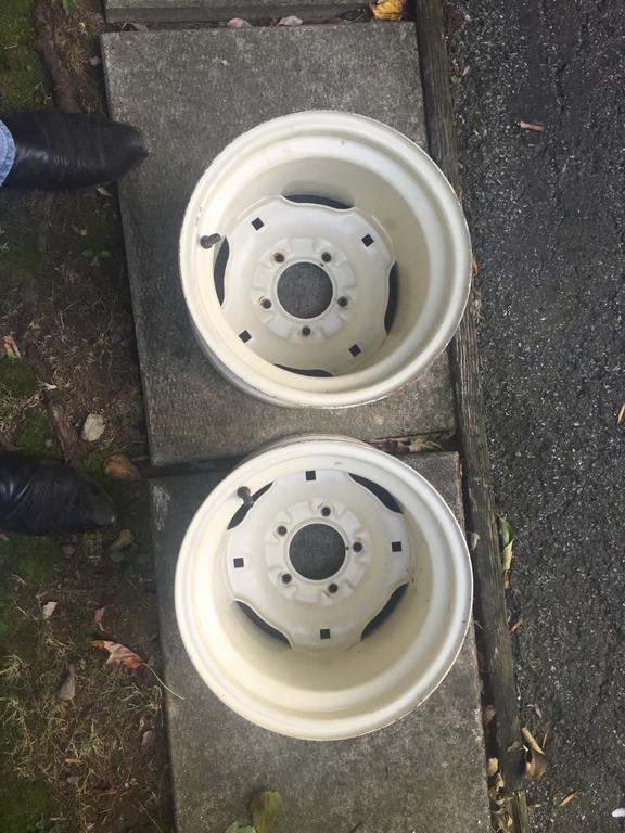

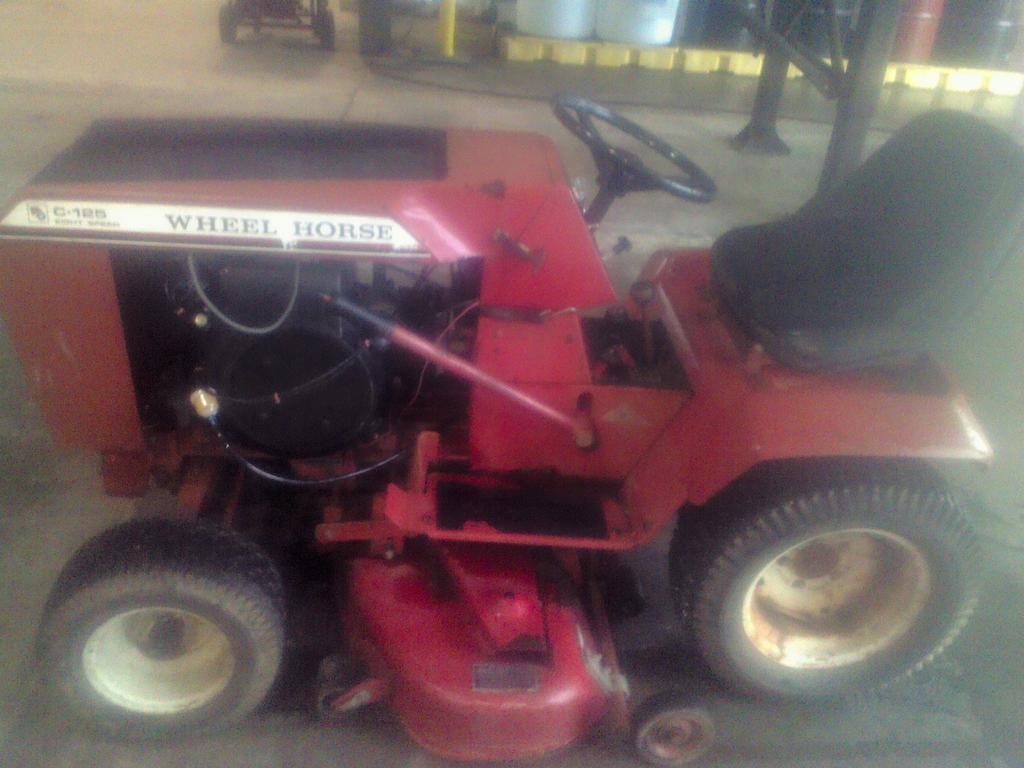

I've been debating on Deestones, i hear so much on Carlisle Ag's, my son has them on the 414-8, i will order today a pair of 23-1050-12's ,  bought some offest rear wheels for my C125, Nothing like Big Meats

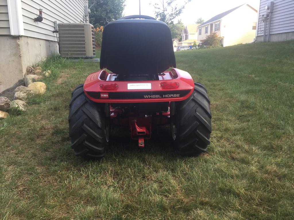

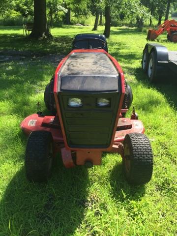

@cschannuth Whats the next step up  ? 26 ? That would be Cool tho, it looks like the seat pan maybe raised, thought i saw bolt holes, thou i can fab brackets, also i have a C165A
0707171756.jpg.5d4891eed00cef59c9f9f27a24270956.jpgIMG_02621.jpg.f674ef41f31528c7fb0d579f56b192d7.jpg

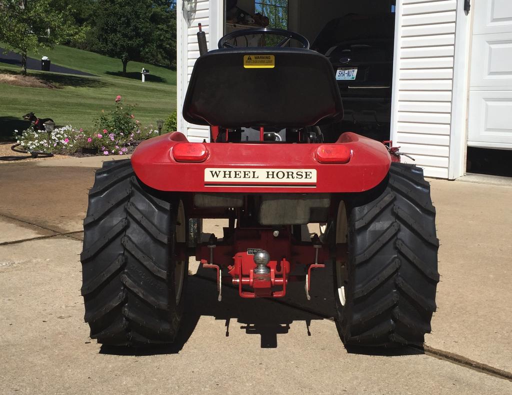

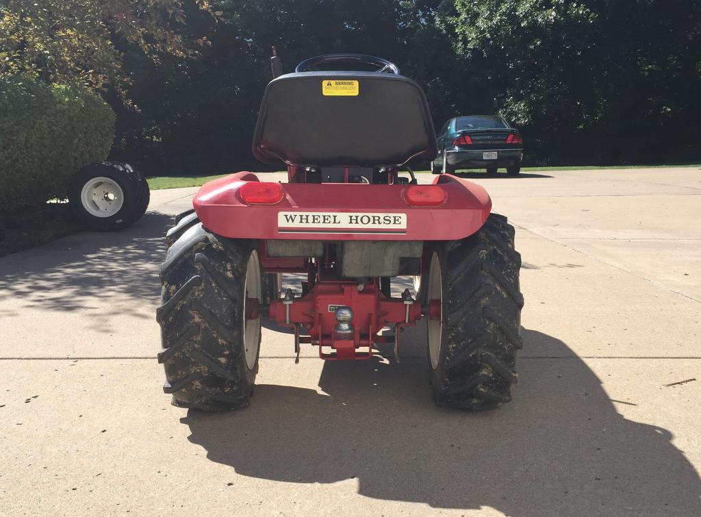

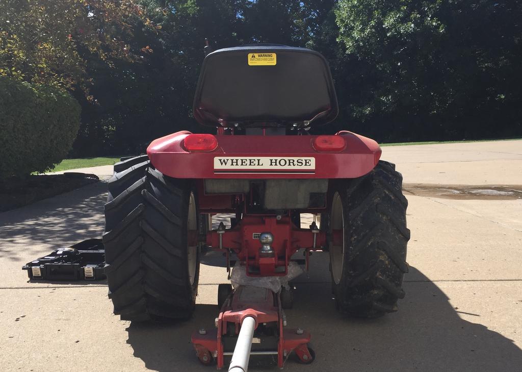

 Some folks go with 26x12-12 but those are a lot bigger and require a 10" wide rim and may require fender mods.  Below is a pic of my C-161 with the 10.5" Carlyles. They are pretty big compared to the original 8.5's also shown. The 10.5's are on 8.5" wide rims. The 8.5" tires are on stock 7" wide rims.

Dont the C165a look Purity at the camp ? You dont see the Kubota  in back round, its a mirage ;-) IMG_02621.jpg.9b4ea8796737ae298570f71e549929fd.jpg

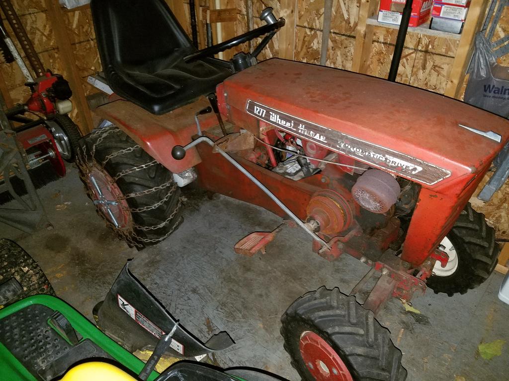

I'll just leave this here....1277 on front/rear Carlisle Tru Power , with fluid in all 4 and weights/chains ...no spinning .
