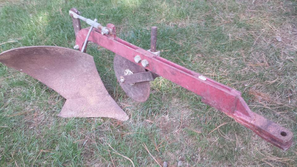

PeacemakerJack 11,096 #27 Posted August 24, 2017 Well--I don't have a picture of this yet, but dad is already at work building a new seat base, cushion, and material for Clyde. He purchased a marine grade black product and new foam. I supplied him with furniture grade 3/4" plywood that I had left over from another project that he will use for the structure. We noticed that the seat pan sitting right on the fender pan is a combo that promotes rust. Dad is planning to put a couple of oak spacers attached to the bottom of the seat which will allow for airflow. He has already asked me about AG tires and so I'm guessing that he will pick up a set in his next trek through OH past Miller tire and save the shipping! If you look closely in he above pic you will see the back edge of a plow on Clyde. Dad purchased that from a forum member a couple of years ago. We are going to set it up for using with Clyde. I can't wait to get this thing plowing! I know it will take some tweaking to get all the kinks out and science out anything to make it a better plow tractor. My feeling is, if we manage to break stuff, we will build it stronger. If it is tough enough as is, we will keep it going! Eventually I'll put a wanted ad for a snow blade. Dad said he'd indeed like to have one for pushing the smaller/wet snows that don't feed well in his blower. I'll have pics soon! 2 Share this post Link to post Share on other sites

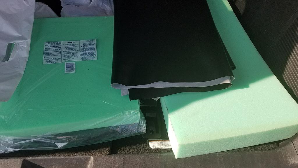

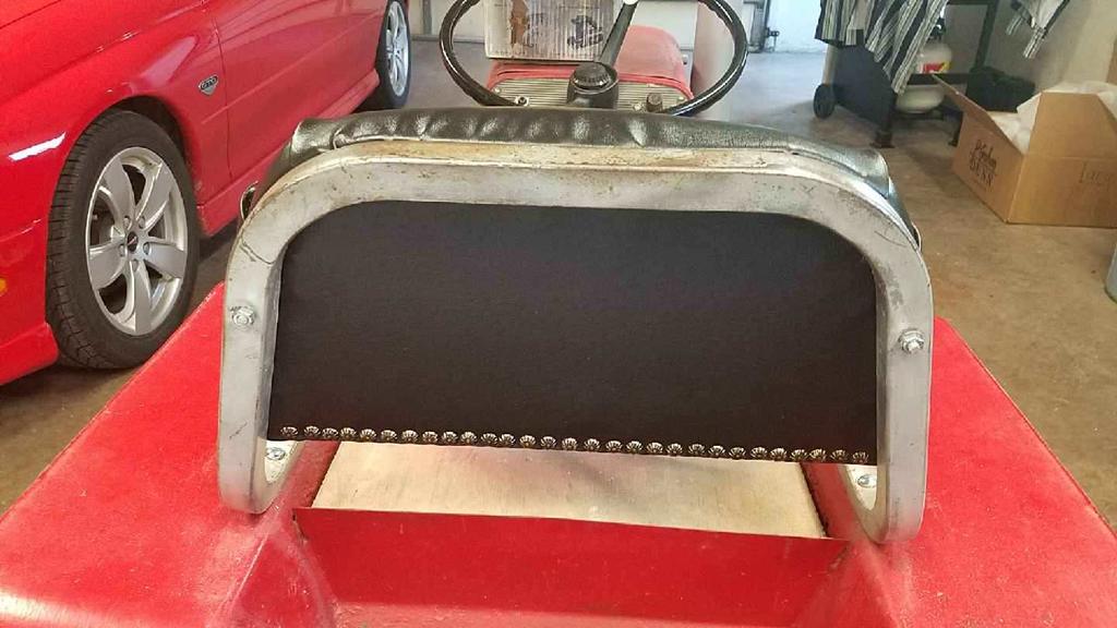

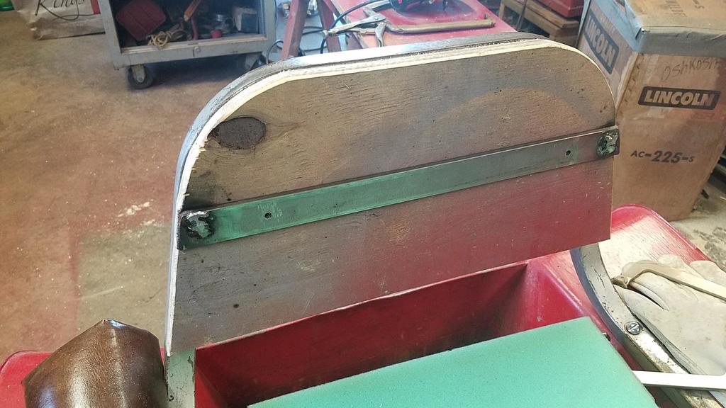

PeacemakerJack 11,096 #28 Posted August 26, 2017 Dad's making progress on Clyde's seat. It was functional but that was about it. Dad doesn't care to do anything halfway. Now, before you send me links to reproduction seats, dad said that he would rather make his own saddle... Here's what he started with! He picked up foam and a marine grade black vinyl material. Cut the furniture plywood to size and shape. Then covered it in that awesome heavy duty vinyl! I thought the thumb tacks were a functional and cool touch. Seat base coming up! 4 2 Share this post Link to post Share on other sites

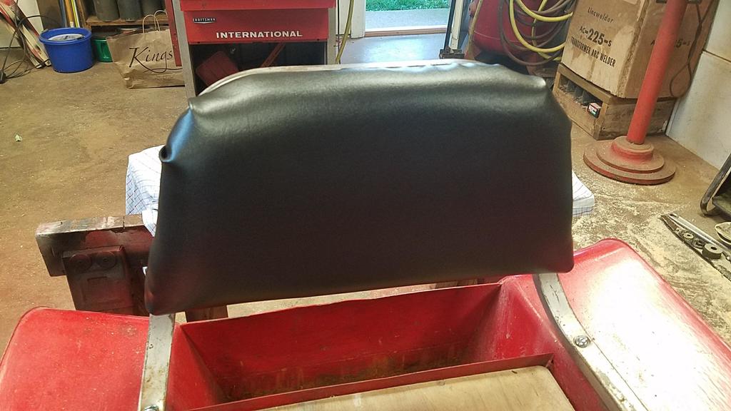

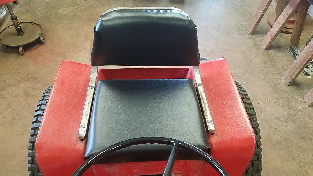

PeacemakerJack 11,096 #29 Posted August 26, 2017 Dad finished the "saddle" for Clyde today! I think it really turned out nice... Now he's gonna do a little body work on the metal under the seat base and paint it mainly for protection. 2 2 Share this post Link to post Share on other sites

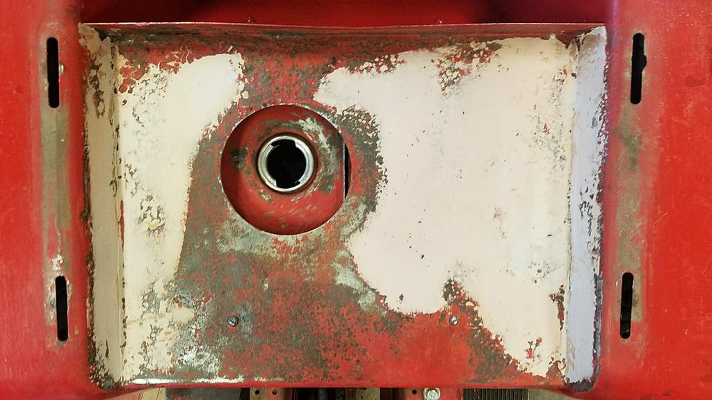

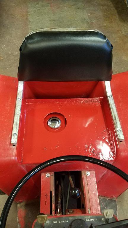

PeacemakerJack 11,096 #30 Posted August 30, 2017 Dad is definitely getting into working on Clyde. He redid the seat and then looked at the nasty residue on the pan under the seat and decided to touch that up since he will have to fill the fuel up there on a regular basis. He cleaned out all the surface rust and crud and then laid down a thin coat of bondo to somewhat smooth some of the pitting. After that cured well, he sanded it down and then shot some primer and a couple coats of IH red... Dad is a perfectionist and so for him this isn't what he would like to see but I did remind him that this is a worker. Mom said she liked the tractor enough that he should restore it completely. I told him if he did that, he wouldn't want to plow with it! Sounds like he will be traveling through OH next month and is planning to stop by Miller and pick up a set of AG's. I can't wait to see this thing with AG's on it... A couple years ago, I arranged for dad to pick this beast up from a forum member. It is so long and heavy, it was hard to operate the lift arm on Dad's 875. However, it lifts with ease on Clyde with the Hydraulic lift. This will be the plow that we set up for this machine. My question for you guys is, "Did this plow come from the factory with the Clevis style (notice it has a second tongue under the main one) tongue?" Right now you slide the primary tongue in the slot and the lower tongue goes under it. The hitch pin slides through all three pieces. If this was factory and not owner added, why would that be on there? We will disassemble it, clean it up, make sure all the fasteners are solid and the turnbuckle and pivot points are free to adjust. The other change that we will make is to move the coulter bracket about an inch further out to the left of the beam (away from the furrow). I'm also going to get my hands on another serrated counter like I have on the Punisher (they look cool and do help cut up longer trash). Then we paint it, letter it, and put it to work! 2 1 Share this post Link to post Share on other sites
953 nut 70,652 #31 Posted August 31, 2017 3 hours ago, PeacemakerJack said: "Did this plow come from the factory with the Clevis style (notice it has a second tongue under the main one) tongue?" Right now you slide the primary tongue in the slot and the lower tongue goes under it. The hitch pin slides through all three pieces. Non factory for sure, look at the sales flier. 2 1 1 Share this post Link to post Share on other sites

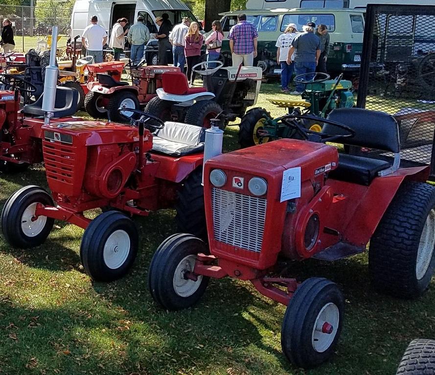

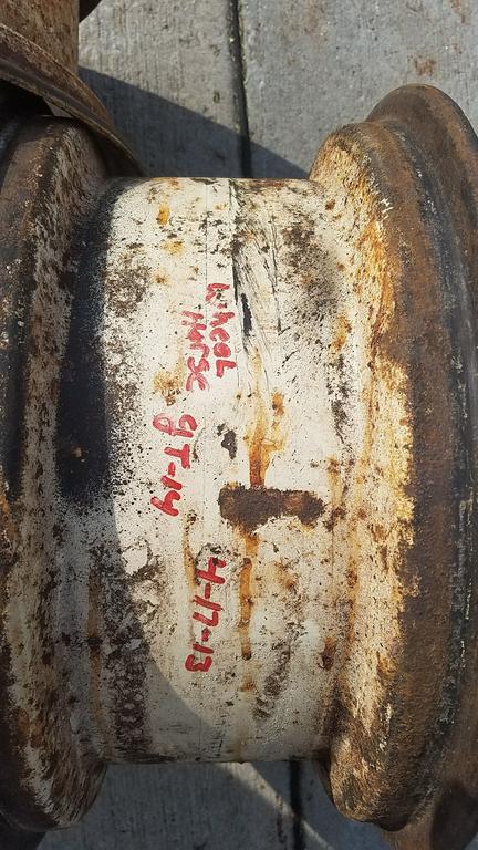

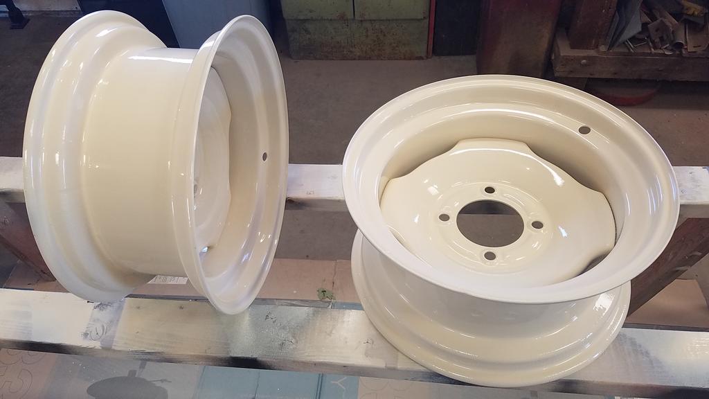

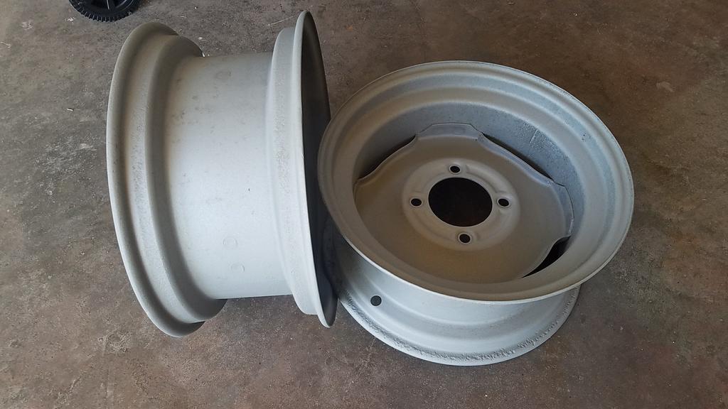

PeacemakerJack 11,096 #34 Posted October 6, 2017 Time for new "shoes" for Clyde. After the show in Berlin last week and all the positive comments Dad got about Clyde, he is more motivated than ever to get it set to his liking. He is going to be traveling through Ohio at the end of the month and so he will stop by Miller and pick up a set of 7.60-15 AG's. He said that he didn't want to miss out on prime painting weather so he peeled the turfs off the rims and look what he found... Can @Shynon shed any light on this inscription? Then he took the hoops to the sandblasted to clean them up. The rims are in great shape and perfect candidates for a fresh coat of Antique white paint! So that is just what Dad gave them! Now they wait curing until the end of the month when the shoes arrive. I'm soooooo excited to see what this thing will look like with those tires on it... Now it is time to set up and paint the plow. 5 2 Share this post Link to post Share on other sites
Shynon 7,730 #35 Posted October 6, 2017 Bought them of from a local seller, he had them marked 1 Share this post Link to post Share on other sites

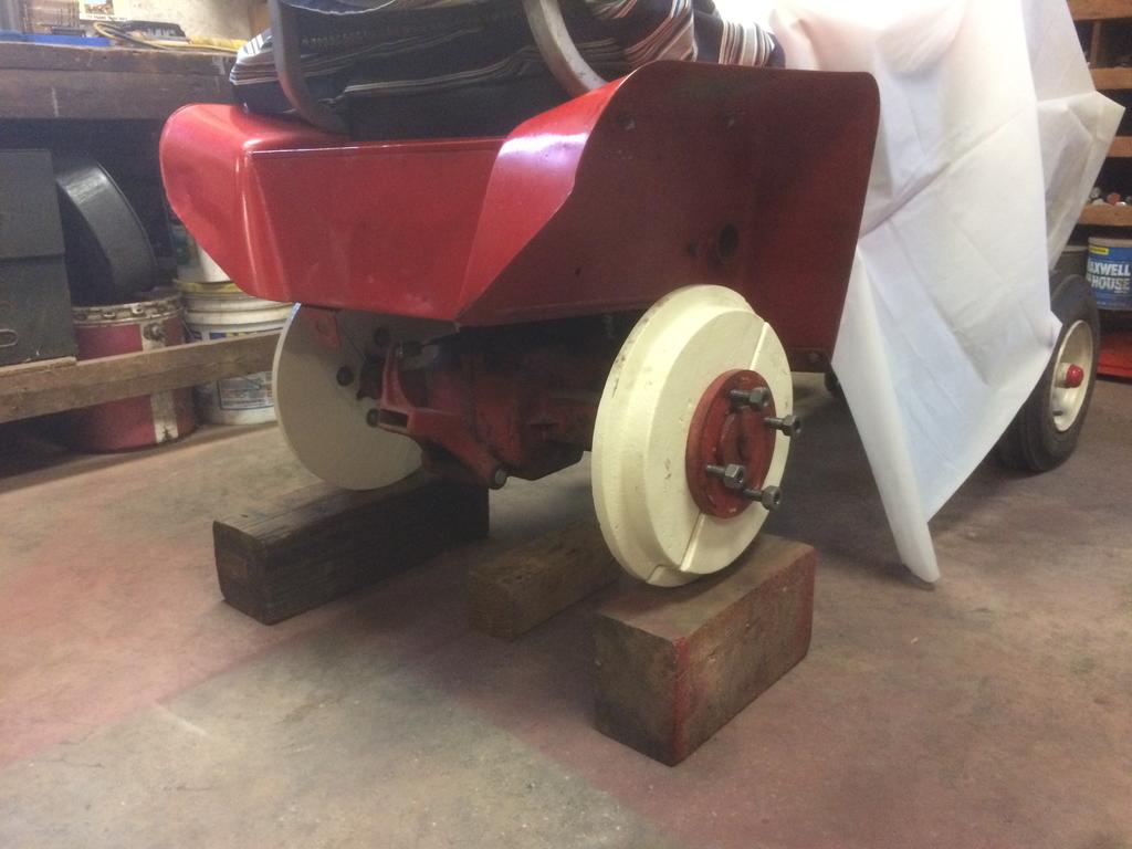

PeacemakerJack 11,096 #39 Posted October 13, 2017 Stopped by dad's this morning and got a kick out of this... it almost begs a "caption this"... "Steel wheels anyone?" @Shynon we took care of that grommet last weekend... Two weeks from now and hopefully I'll have some pics with AG's mounted reminds me of Johnny Cash--"one piece at a time." 8 Share this post Link to post Share on other sites

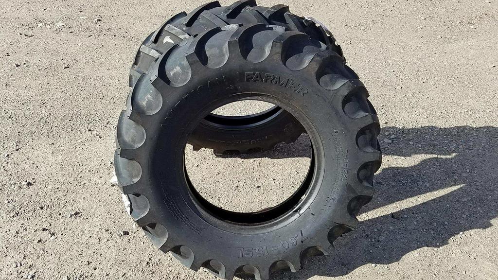

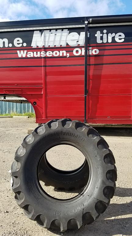

PeacemakerJack 11,096 #45 Posted November 6, 2017 Dad just left Miller Tire a couple of hours ago on his way home from the latest Missions trip. It is convenient that dad travels through OH on a regular basis. He was able to save about $75 in Shipping costs because picking up his tires while traveling through. I think they are really cool looking and can’t wait to see them on the tractor! They look just like miniature tractor tires. If you can’t read it, the size dad chose was the 7.60-15 implement tire. Given the size and look if the front tires that Tom installed, I think this is going to be a home run. Once those are installed, then we need to work on getting the PP-10HD set up for his rig and then try it out in my garden. More to come... 10 Share this post Link to post Share on other sites
953 nut 70,652 #46 Posted November 6, 2017 Those 7.60s should fill up the wheel wells! 2 1 Share this post Link to post Share on other sites
