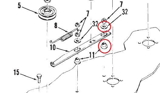

Anglo Traction 761 #2 Posted August 16, 2017 Hi, I think your referring to the items highlighted in this image- If so, Search for these nbrs Toro 107674 107675 listed as Special Washer and Spacer Bushing. I'm in UK, but the search will throw up all U.S sources of availability. 3 Share this post Link to post Share on other sites
gwest_ca-(File Mod) 12,281 #3 Posted August 16, 2017 2nd item down? Garry 4 Share this post Link to post Share on other sites

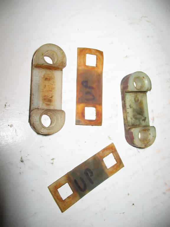

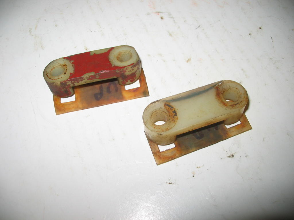

daveoman1966 3,883 #4 Posted August 16, 2017 Or this older style....? ? ? These are nylon. 5 Share this post Link to post Share on other sites
ohiofarmer 3,434 #5 Posted August 16, 2017 (edited) From a resto-mod perspective, here is what I did. My mower deck had two little thin blocks of Delrin close to where the spacers are shown in the pictures Like Davoman has posted above. The trouble with that is dirt and moisture built up between those thin bottom blocks and rust made the slide bar drag. I had some Formica laying about and decided to just make a slide surface to support 100% of the slide bar. I made it about 1.5 inches wide and cut notches to capture it between the studs that those plastic spacer connect to i polished the underside of the slide bar to a mirror finish and used clear silicone grease between it and the slide bar. I applied red synthetic grease on the underside of the Formica to seal out moisture between the Formica and the deck surface because I did not have time to use paint. the slide action works very well two years later. if you use the belt shields over the pulleys, nobody will see it anyway. This is what I used to polish the bottom of the slide bar. https://www.harborfreight.com/catalogsearch/result/index/?dir=asc&order=EAScore%2Cf%2CEAFeatured+Weight%2Cf%2CSale+Rank%2Cf&q=polycarbide Edited August 16, 2017 by ohiofarmer 2 Share this post Link to post Share on other sites
