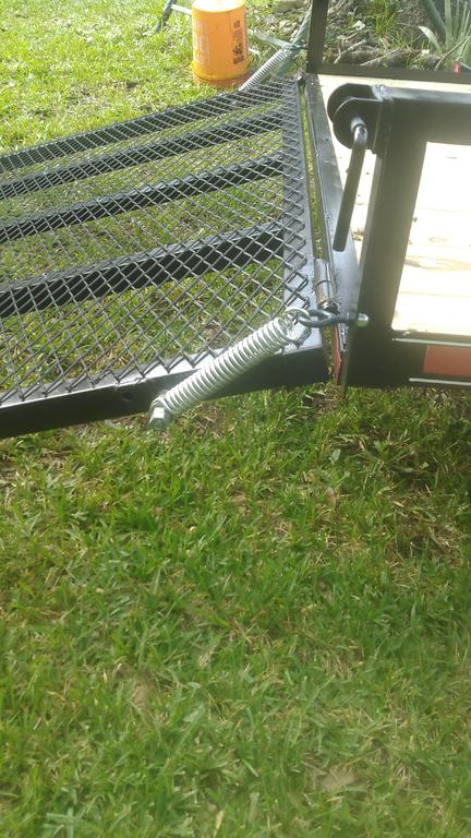

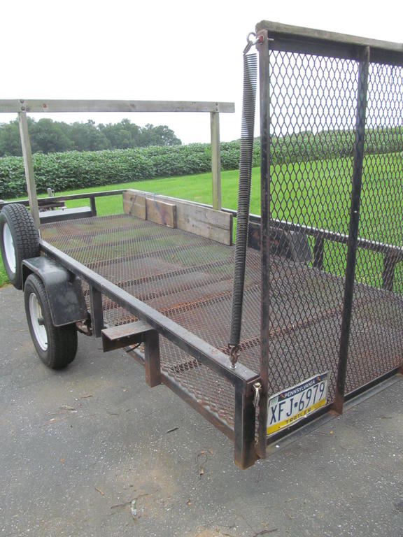

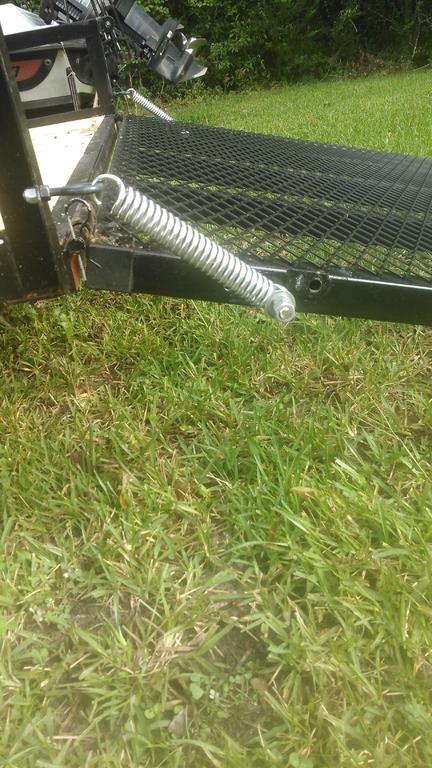

JPWH 6,541 #1 Posted August 12, 2017 I bought a cheap made utility trailer that I will be doing some upgrades to. I purchased this trailer mainly to haul to the show. It has adequate load capacity yet is lightweight enough to pull with my wife's Highlander. The major problem is the ramp gate weight so lift assist was top priority. I have a repaired hernea that limits me to 50# so I came up with this. Simple but adequate. 8 5 Share this post Link to post Share on other sites
elcamino/wheelhorse 9,362 #2 Posted August 12, 2017 I like that idea. Makes life easier for old timers. 1 1 1 Share this post Link to post Share on other sites
953 nut 62,088 #3 Posted August 12, 2017 Looks like the springs go a bit past center when the gate is down, do you have to give it a little tug to get it started? 2 Share this post Link to post Share on other sites
JPWH 6,541 #4 Posted August 12, 2017 (edited) It's just above center so it just makes the gate lighter. It is close though. I was wanting to keep them as low and short as I could. I'll add another picture tomorrow with the gate down. Edited August 12, 2017 by JPWH 1 1 Share this post Link to post Share on other sites
Pat_In_Denver 104 #5 Posted August 12, 2017 If that spring were red, I would have guessed it came from a tiller or snow blower 2 Share this post Link to post Share on other sites
dclarke 4,103 #6 Posted August 12, 2017 That's a nice upgrade to your trailer, Jay. 1 1 Share this post Link to post Share on other sites
JPWH 6,541 #7 Posted August 12, 2017 8 hours ago, Pat_In_Denver said: If that spring were red, I would have guessed it came from a tiller or snow blower It's actually a set of porch swing springs. 4 1 Share this post Link to post Share on other sites
Ed Kennell 43,049 #8 Posted August 12, 2017 Waiting for the pic with the gate down Jay. Being one of the " tired old guys", I've been thinking of this mod for my trailer. Of course, since I'm also a cheap old scavenger, I will probably use some old garage door springs....now where did I put those...... 4 1 2 Share this post Link to post Share on other sites

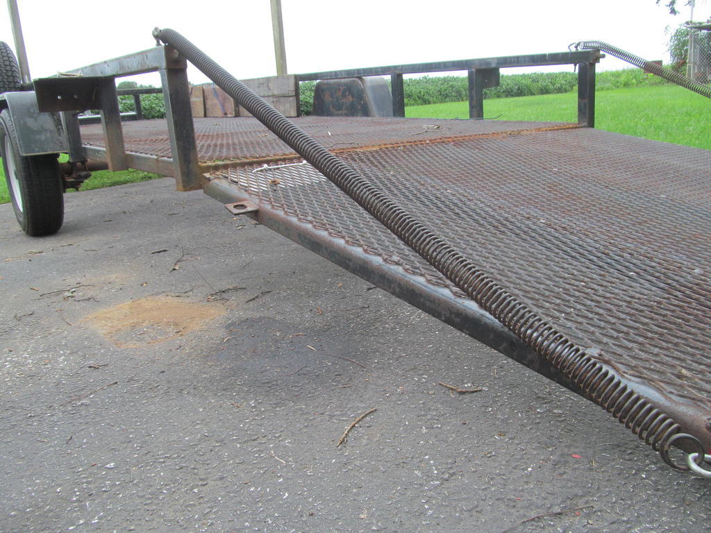

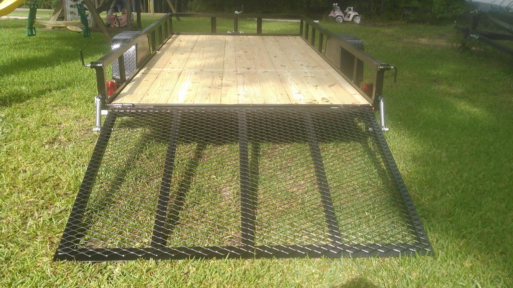

JPWH 6,541 #10 Posted August 12, 2017 As promised. Tailgate down. 6 2 1 Share this post Link to post Share on other sites
Big_Red_Fred 1,548 #11 Posted August 12, 2017 I was wondering where them Hood springs for the 05 Peterbilt went ? Jayyyyyyyyyyyyyyy 2 Share this post Link to post Share on other sites
JPWH 6,541 #12 Posted August 12, 2017 8 hours ago, AMC RULES said: Based on your previous experience Jay... I think I'd be modifying that new trailer with a few more (better visibility) taillights. I have been looking already. And I'm beefing up the gate as well. The top spring mounts also serve as 1/2" rod gate stops. 1 Share this post Link to post Share on other sites

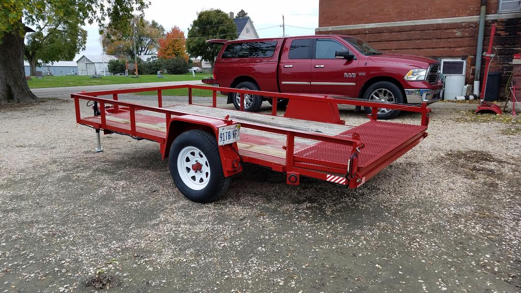

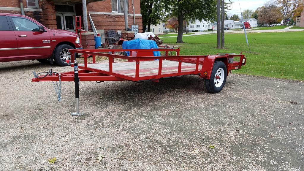

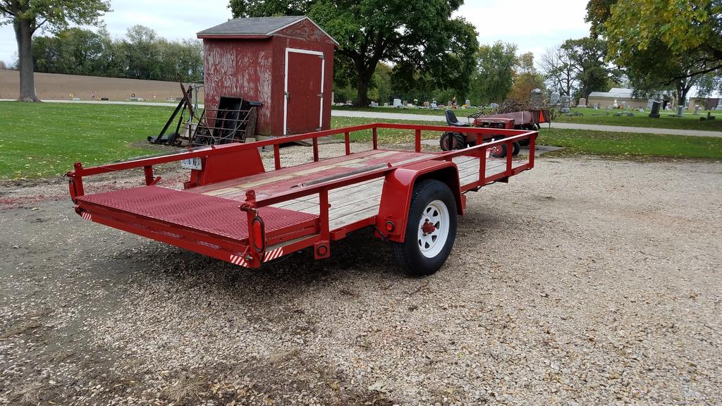

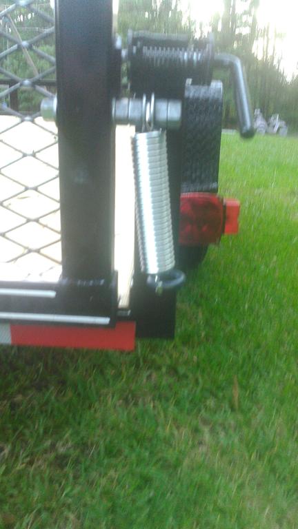

Ed Kennell 43,049 #16 Posted August 14, 2017 On 8/12/2017 at 8:34 AM, Ed Kennell said: Being one of the " tired old guys", I've been thinking of this mod for my trailer. Of course, since I'm also a cheap old scavenger, I will probably use some old garage door springs....now where did I put those...... I found the springs this afternoon. I thought I may have to move the attachment point forward to increase the tension, but the first location was perfect. I actually have to push it down the last couple inches and it requires maybe 5lbs to lift it. Thanks for the Inspiration Jay. 2 3 Share this post Link to post Share on other sites
JPWH 6,541 #17 Posted August 14, 2017 Looks good Ed glad I could help. Lol. Mine takes more effort than that but I figure I cut the weight by 2/3 anyway. 1 Share this post Link to post Share on other sites

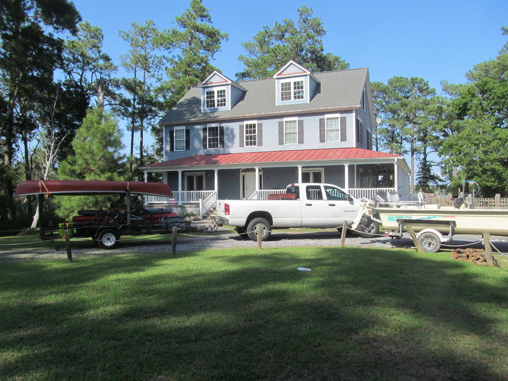

elcamino/wheelhorse 9,362 #18 Posted August 14, 2017 @Ed Kennell What is the purpose of the wooden cross beam? Share this post Link to post Share on other sites
Ed Kennell 43,049 #19 Posted August 15, 2017 The rack is for hauling kayaks and canoes. One end rests on the tail gate. 2 1 Share this post Link to post Share on other sites

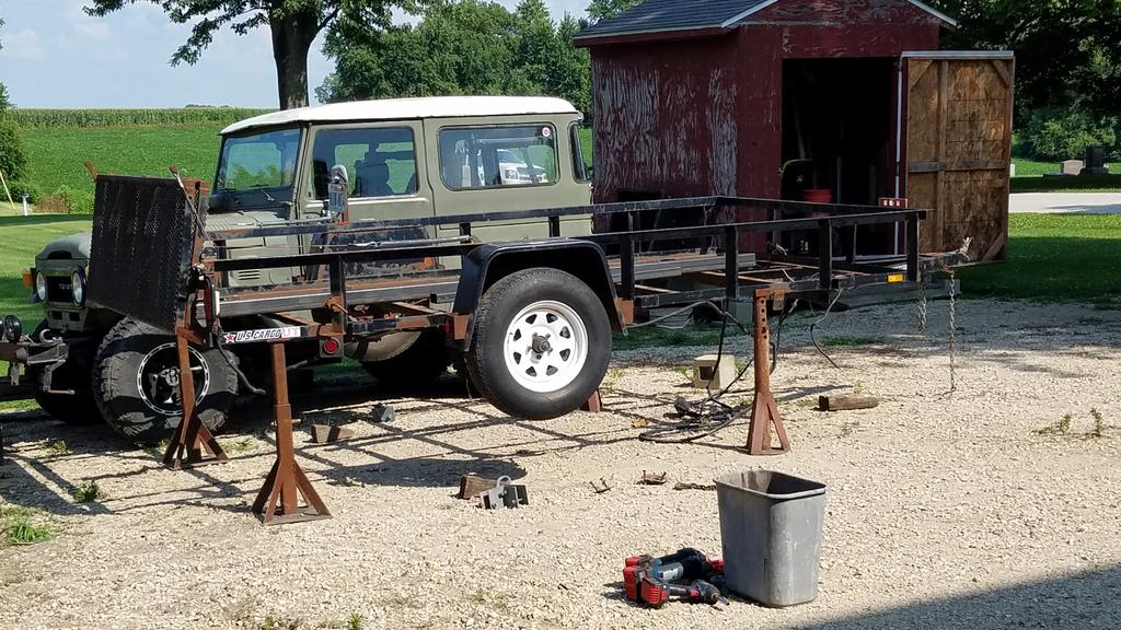

Sarge 3,470 #21 Posted August 15, 2017 The whole gate is in pieces right now - need to finish a bunch of little things on it today and focus on the D for a few days until the weather clears enough to blast the trailer/gate and start painting it . To fold the gate flat you'll need to offset the hinge to the frame at the rear a bit - the way I did this one it can allow the gate to lay folded in half flat on the rear deck , only taking up 24" of the end of the decking . Bullet hinges can be used between the two gate halves but the hinges between the gate and the frame have to be on the outside edge only - otherwise it can't fold all the way down . For full length loads I leave the gate folded in half and can pin it in the upright position , lesser loads it lays flat for less air drag going down the highway . 1"x2" rectangle tubing was used to divide the gate in half - make sure it's welded fully and sound as that hinge point has to stop the gate from collapsing in half under weight . I've loaded over 1,000lbs on this one with no issues of bending yet . If you plan to use bullet hinges I'd go no less than 5/8" pin size , 3/4" would be a better choice . Lot of folks selling cnc milled sets on the auction site cheap - you can't build them for their price using good steel . Maybe I can grab a couple pics and dimensions of the rear frame hinge points - it would be a good starting point . The lift springs use a pulley to allow everything to pivot over center for folding the gate flat . It looks odd at the upright position but makes sense once it's folded all the way down - hence the use of aircraft cable instead of connecting the springs directly . Think of how the old bi-fold doors worked on garages , closets and some rear truck/camper hatches - that's the best way to describe how this gate works . Sarge 2 Share this post Link to post Share on other sites

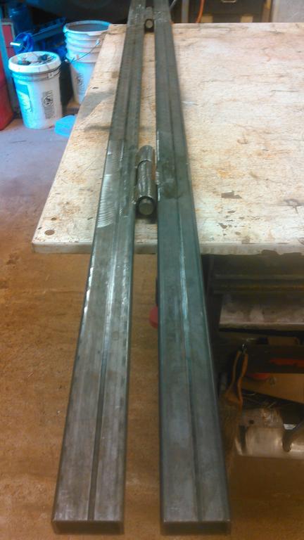

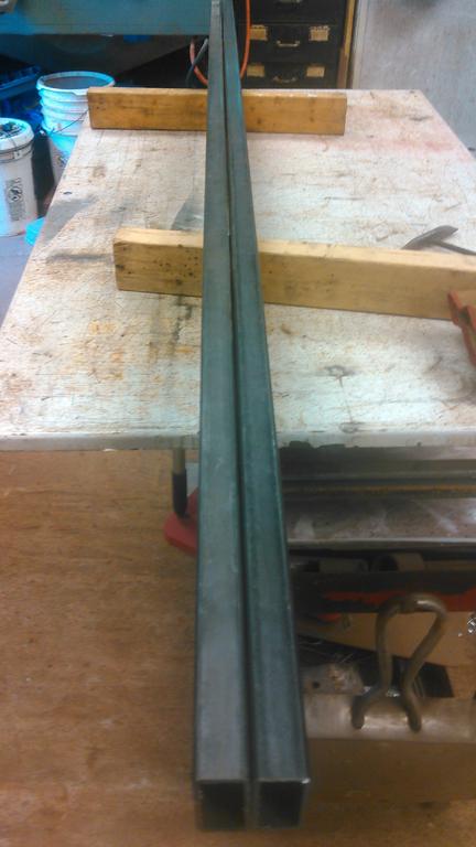

JPWH 6,541 #22 Posted August 20, 2017 I decided to build my own hinges for the bifold ramp.gate. Here is a couple pictures of what I came up with. Folded position. Open position. 1 2 Share this post Link to post Share on other sites
Sarge 3,470 #23 Posted August 21, 2017 Yup , pretty much how I did mine . Be sure to leave one pin about 1/2" too long and drill it for a cotter pin - that will keep it from walking off when the trailer is on an incline , don't ask me how I learned that one...lol . Found out my hinge points on the rear trailer frame are badly worn already from all the weight it's had loaded onto it , plus being beaten to death by our roads - rebuilding the entire hinge setup with much heavier material now . This dumb thing has snowballed so far out of line it's starting to really irritate me...taking up too much time I don't have . Sarge 1 1 Share this post Link to post Share on other sites

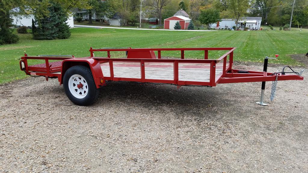

Sarge 3,470 #24 Posted October 29, 2017 Finally got it finished except installing the plate light . Way too many large projects this summer..... Need to take it to the car wash and clean off the overspray on some of the wood decking - I re-used the original stuff as it was in pretty good shape for being 7yrs old already . We'll see over time how well the Rustoleum with hardener added will hold up - probably should have went one more solid coat on it but hey , it's a trailer and not a show car . Sarge 5 Share this post Link to post Share on other sites
