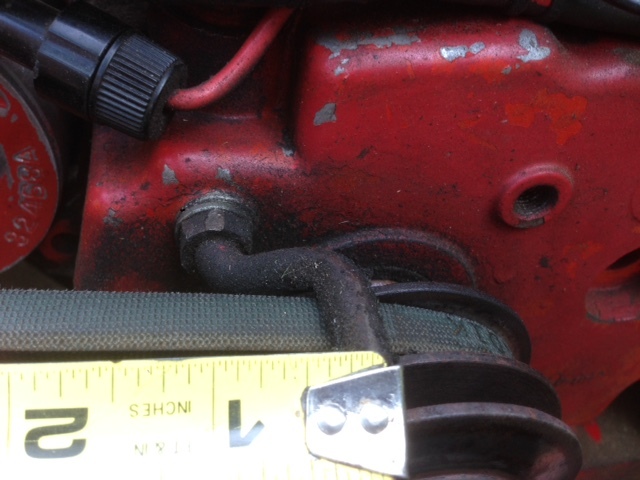

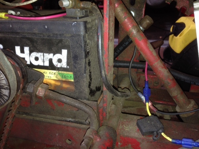

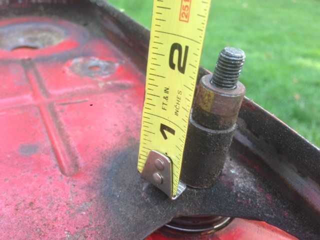

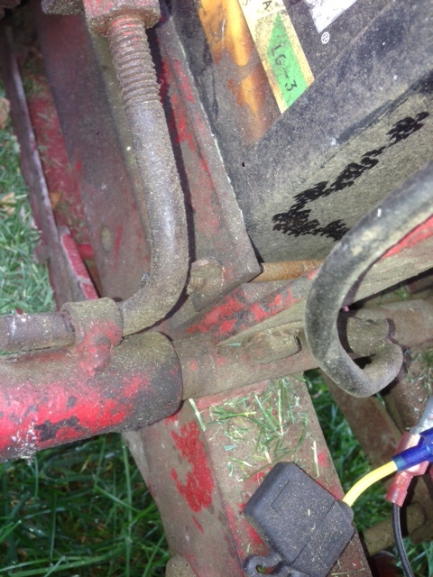

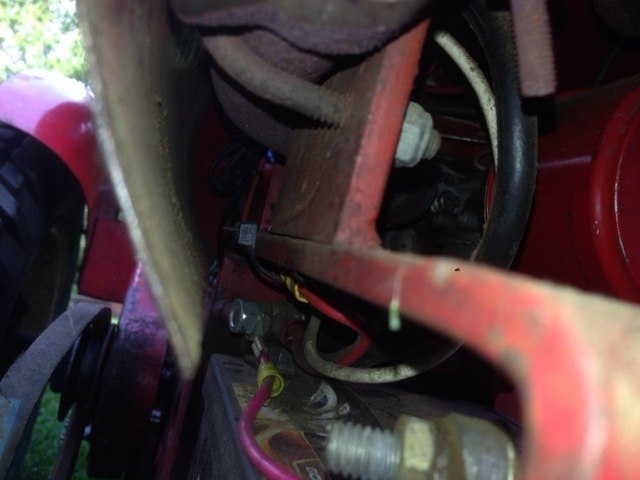

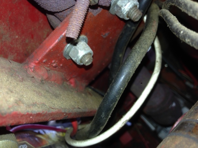

Tgtack 779 #1 Posted August 1, 2017 I am trying to locate some parts for a model 551 that I recently picked up. It is missing the drive belt cover, does not have the correct engine, part of the headstand was cut away. If you have a model 551, I really really need some detail pictures. Pictures of the correct belt guard (and dimensions if possible), also the Z shaped rod under the cover, dimension of the belt guard spacers. Pictures of the engine mount (H55/HH55 engine), dimension from frame to top of cylinder head (not spark plug). Pictures of the battery mount from both sides (part of mine was cut off on the left side of the frame). Your help would be much appreciated. I have searched the archives, and unfortunately, many of the past pictures that might have helped, are not available as they were on off forum storage, and many simply no longer exist. Share this post Link to post Share on other sites

formariz 12,378 #6 Posted August 5, 2017 Lets see if these help you. I may have to remove heat shield for better access to battery area if they don't. Sorry that she is a little grimy but she is a working girl. 4 Share this post Link to post Share on other sites
