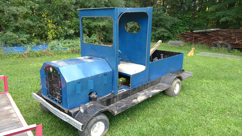

Whatchamacalit, I'm not sure what else to call this or what thread this should go under.:blink:
But Odd & Obscure fit it pretty good.
I believe it was built as a parade car?
It's 11' long & 55" wide, powered by an 8HP B&S, with a belt driven 3 speed car trans &  a car type rear axle.
No suspension & with all the weight towards the front, if the front end dips low enough to lift a back tire....there it sits.
What I have....a 22HP Predator engine, a HD 8 speed from a C series, a pair of Samurai axles & driveshaft's.
Maybe some 26" ag's or bigger, have to do some math, see what kid of gearing I would have in the axles & at the drive from the engine to the trans.
For suspension I'm thinking maybe a transverse leaf at the front & golf cart leaf springs in back.
Anyone seeing where I'm going with this?
Isn't it fun to dream & ramble.....

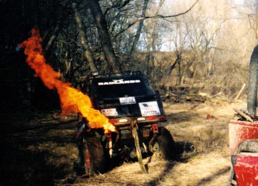

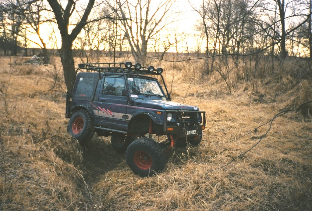

Not sure if you'd want my help with that thing - it may grow into this....
@Tgtack might get a kick out of his old store site decal across the nose in front of the radiator . I had built a 1.6L Tracker/Swift GTi hybrid engine for this thing - over 150hp on 93 octane fuel....

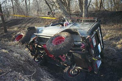

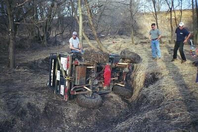

Which all leads to days like this - result of a broken rear axle , the dumb thing just wanted to pivot over and flip - this was the 3rd time before we figured out why it wouldn't go through there...lol .
